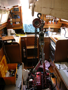

I wasn't timing it, but I'd say it took about two or three hours to get the A-4 out of my Alberg 30.
That was starting with it all hooked up, unhooking and labeling everything (i.e. blue tape and Sharpie on the wires and hoses), and lifting it off the beds and swinging it out onto the cabin sole (I used the 4 x 4 across the companionway top since my rig was down and I never intended to take the engine all the way out of the boat).
I had a few things going for me: The fasteners that went through the mounts were easy to loosen, and because they were bolts/nuts that went through a flanged bed, I could take them right out and then not have any studs to have to hump the engine over. Also, knowing I'd be replacing hoses, I just sliced through them all instead of loosening clamps and etc. But you could probably get prep work done before "the day," right? (Or, when is the day? Today?)
I vote to go for it! Plus, it's so nice to be able to get in under there and clean :)
Edited to add: Oh wait, why guess? I was taking photos with my digital camera :)
Okay, first photo, when I was just kind of looking things over and labeling, was taken at 11:12 a.m.
Last photo, of the gaping maw after the engine was completely out, was taken at 2:58 p.m.
So more like a solid 3 -4 hours, probably, from the time my bud arrived -- but then we were not even trying to rush, and were making decisions about this-and-that as we went along (which we could have done ahead of time if there had been a rush).

Let's see...put down the imponderables of access for, say, 3 hours. Rig the lift and suspension scheme - 30 minutes.
Disconnect engine - 15 minutes: Wires - engine ground, power to the starter, starter solenoid, oil pressure switch wire, distributor (not with electronic ignition which would be, I think, one more), electric fuel pump wire if equipped, 2 (or three?) alternator wires; fuel line; choke and throttle cables; shifter pin; exhaust manifold - two bolts; propeller shaft flange - four bolts; engine bed - four bolts.
Lift it up and over the side: 15 minutes.
Voila! 4 hours!
Figment can do it, no problem! I did not have much concern for the casework in Vela; I dismantled it with a Sawzall (judiciously, of course) and reassembled/reconstituted it for easier routine maintenance removal.
Voila! 4 hours!

Obviously, various boats have various geometries for sheet and vang mountings, clear space down through the companionway, how much the engine is tucked under the cockpit. What I describe below would have to be rigged very differently on our NE 38; at the very least, I'd have to add something to the sole to protect it and to spread the load, and I'd have to rig the lifting tackles on slings over the boom rather than use the fittings provided.
Our Morgan 27 was such that I could use the mainsheet and the vang together. Either is strong enough for the load. Both had their bottom blocks integral with jam cleats. I used multiple turns of light guage line to affix the shackles to the engine lift ring. The two angles they made together enabled me to lift the engine off the beds with the mainsheet, and ooch it forward while suspended by alternately slacking and snugging the two tackles. Really very easy and controllable. I redeployed the main halyard to the aft end of the boom; the topping lift is insufficient, in my view.
An A4 weighs about 315lbs, so any couple of adults used as baggage can be used to load your rig sufficiently to see whether it's really easy enough to lift the dead weight of the engine. And, it really ought to be easy for you, with enough mechanical advantage, and with places to stand to pull the lines. You'll want to reserve your strength to do what the rig won't or can't, like ease the beast sideways or keep it from swinging. A simple arrangement of multiple turns of light guage line can be deployed anywhere along the boom to affix your lifting tackles' upper end.
The worst problem was that the aft end of the transmission strongly desired to snag the countertop and bridge deck, but a draped towel kept damage to a minimum. I lifted the engine up, forward, up, and aft onto the bridge deck using the pair of tackles. I then rerigged the mainsheet to do the lowering away solo. Piece of cake.
