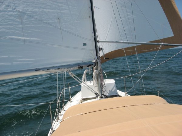

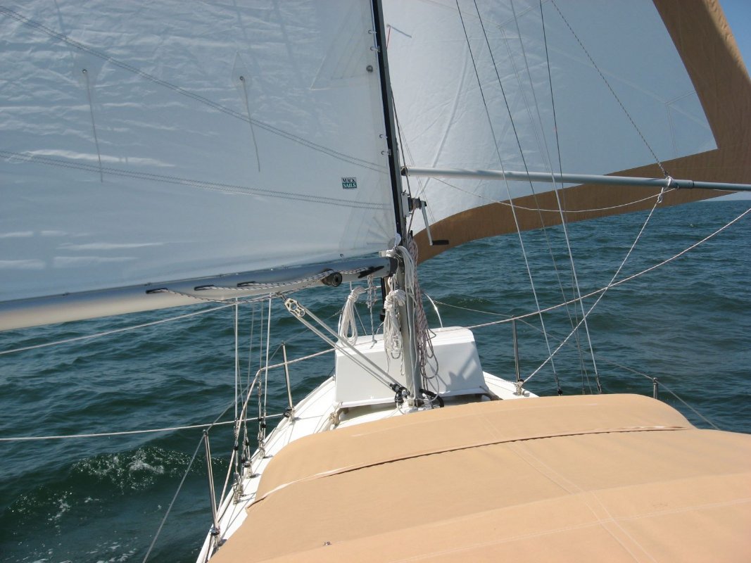

Yes, Shiira is a sloop with ~100% jib on furler and a staysail rigged on a permanent stay. See pic.
I was thinking of sharing the staysail halyard for the pole topping lift. Halyard currently led to cockpit but that can change to mast.

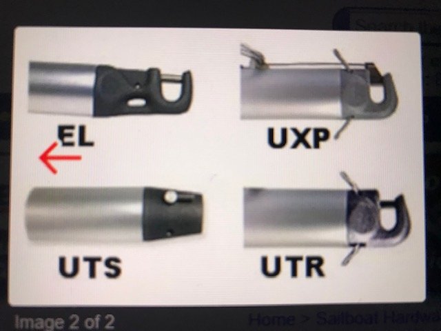

End Fittings. Yes, Forespar couldn't make things more confusing. You mentioned the EL-UXP which I think are 2 separate fittings. Looks like end fittings are changing a bit. Forespar currently shows these New fittings. See pic. Maybe UTR is best now?
The Defender site showed some other fittings with an EL listed. Maybe last years model?

Yes forespar end fittings are confusing they way they list them. The UXP is the standard "latch" end with external trip line, which is what I wanted. The UTR looks similar but is called a "trigger" and has an internal trip line. UTS is a "socket". I don't know what EL is but it was on the Port Supply order form so that's what I used last time. I would confirm with forespar. Let us know if you discover what the EL means.

Ok great. Only 1 of my 4 pics from the last response showed up. Oh well, here is what I saw for the "EL" on the Defender web site.
Re: How to Choose Correct Whiskerpole
Thanks for clearing that up. The UXP on both ends with external trip line is what I got on the last three poles I bought for myself and other boats even though the West Marine order form said EL-UXP. The UTR may be only for fixed poles because the internal trip line may not function on a telescoping pole.
I saw the sticker on my whisker pole today and confirmed it says 10-18 EL-UXP. Not sure if they changed the model numbers since then but that's the type I always ordered. There are slight differences in the large inboard end and smaller outboard end which may explain the EL-UXP name rather than just UXP.
