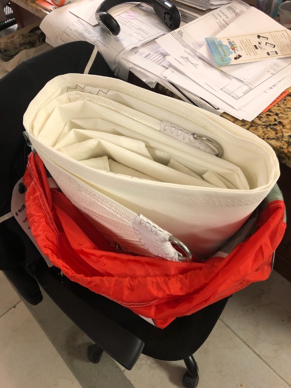

Rolly covered shipping from Thailand to Florida as well as shipping to a freight forwarder in Florida.
That was very much appreciated and saved me a lot of money. The package was almost 90 pounds.
All sails were constructed to their “offshore specifications”

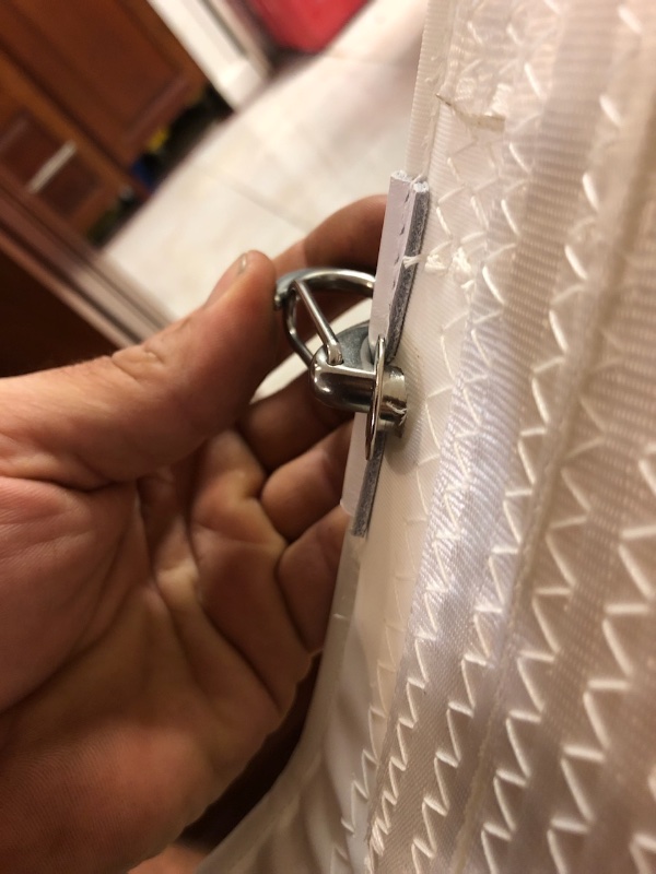

The grommet on the head of the staysail was split in half and the leather on the leech was split from the grommet being pressed into place.
I haven’t had a chance to layout the sail completely and inspect every single grommet but I’m very disappointed with that.
