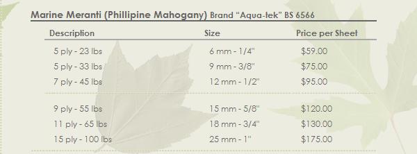

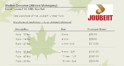

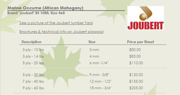

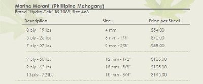

Re: Alternatives to plywood fopr bulkheads
I think you will find that Hydrotek is a meranti plywood. Meranti is not a true mahogany, only some what closely related. Meranti has a lower strength / weight ratio than okoume, but is more resilient to abrasive damage. Some small boat builders prefer meranti for hulls or at least bottoms and okoume for the rest. For bulkheads either one is more than satisfactory. Meranti is also heavier than okoume by about 20%
I don't think it matters what foam you use, how thick it is, or how you bond it to the hull. All it is doing is helping to hold the bulkhead in place while avoiding hard spots and filling in the void at the hull to help in filleting and tabbing the bulkhead in neatly. By in effect suspending the bulkhead just away from the hull during tabbing you get a near perfect structural joint that carries loads evenly along the entire tab. Any procedures that does this will work.
- Posts: 319
- Boat Name: Mi Tiempo
You may be right, but this is how Westwind Hardwoods lists them. Prices are Cdn dollars.
Brian
Brian
