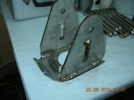

Project: To modify a previously made Mast Step to a Tabernacle Step.
... Purpose ... to enable raising the mast sans lifting gantry or crane hoist etc.
... First, determine dimensions to accomodate the Selden mast section.
... Next, transfer all measurements to a working drawing and take to cutting shop with order to: Make Two (2) pieces.
... Take all parts to weld shop and instruct welder on required installation.
... All that remains now is, clean up any sharp edges prior to a dip in the Electro-polishing tank
