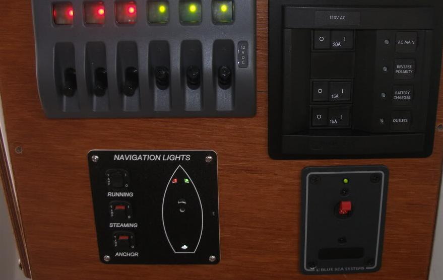

Things have slowed down a little bit, but I have been doing some work, mostly electrical. Not much worhty of an update until now. I finally got the panels wired up and the stereo and VHF installed. Very tedious since I seem to always be running out of the appropriate fittings and have to stop and go get them. And its just slow work. Next up is to double check my work and then install the light fixtures.
Back fo panel. Kind of a nightmare. I wish I had a slightly larger area for a panel.
At least the front of the panel looks clean!
Stereo and VHF and Instrument area.

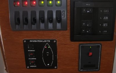

Let there be light!
And there was... After 5 months of learning, research, acquisition and implementation!
Doug
1972 Ericson 27

Hello bigd14, can you tell me what is the model # or part # for the 120v AC Sw. shown in one of the pics posted Mar27/2011
It's shown to the right of the 12v Sw panel with the red & green lights.???
Also, is this a GFCI type sw unit??? or, do you rely on land power outlet GFCI for protection???
Actually, I would be interested in knowing what all your components are because it would suit my needs perfectly.
Thanks . . . . Bob T.

Bob
I think it is a DC main switch. The AC panel above it (360 series from Blue Seas) has the double breaker 30 amp main AC breaker at the top.
Never rely on any GFCI off the boat for safety. In a circuit of outlets the first should be a GFCI. It will protect the others downstream.

Mark is correct! I have been working on the boat after a couple weeks off due to a bad reaction to some medication I was taking, Ugh.
Billy, yes Mark is right, it was Ballengers. They made a really quality product for me.
Bob- Mitiempo is correct, that is the DC main panel switch. That way the panel can be switched off for maintenance but the motor can still be powered up. The AC comes into the Blue Sea panel on the upper right in the photo. I have two AC breakers, one that goes to the battery charger and one that goes to a single GFCI outlet. Here is the final electrical schematic:
Sources: I used Blue Sea as much as possible. http://www.genuinedealz.com for wire and end fittings, my local chandlery and West Marine for the stuff I forgot (alot!) and http://www.sailorsams.com for the interior lights, and Jamestown Distributors for some of the nav lights.
Doug

Doug
Looks like a very well thought out system. At a quick look I see nothing wrong with it. You oversized some wires in my opinion but other than their expense that is fine.
Normal AC wiring is 14 awg which will more than carry the max output of the breaker (15 amps)
The 10 awg you have used for items like the stereo are huge overkill as well. Most stereos use way less than 5 amps.
Looks to be a trouble free system though and you know every part of it - always a good thing.
