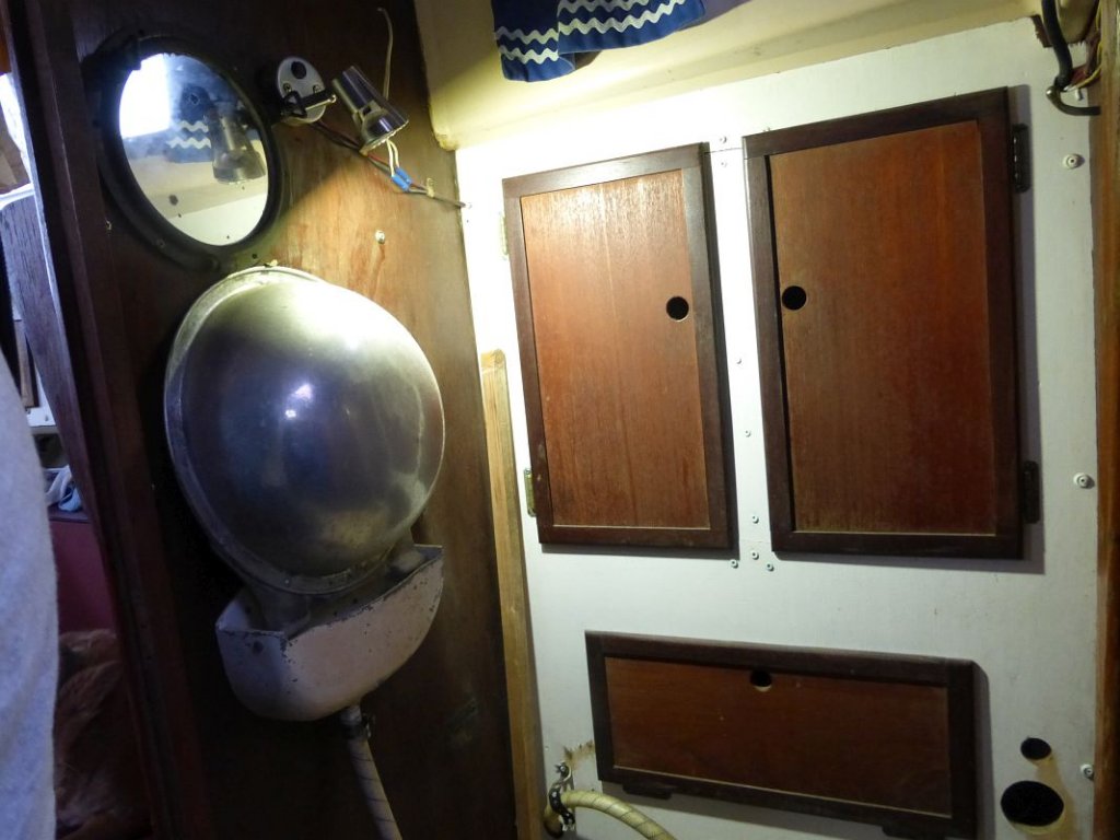

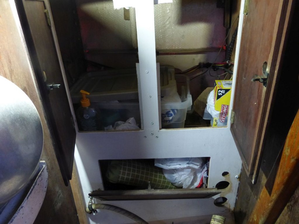

Head: Improving it. Adding shower, composting toilet. Pics below.

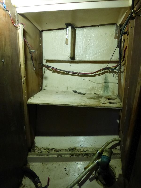

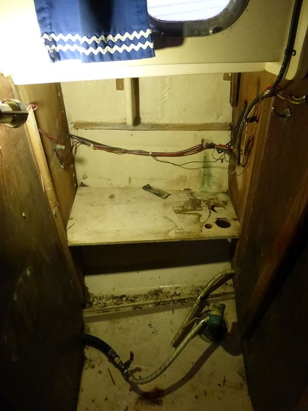

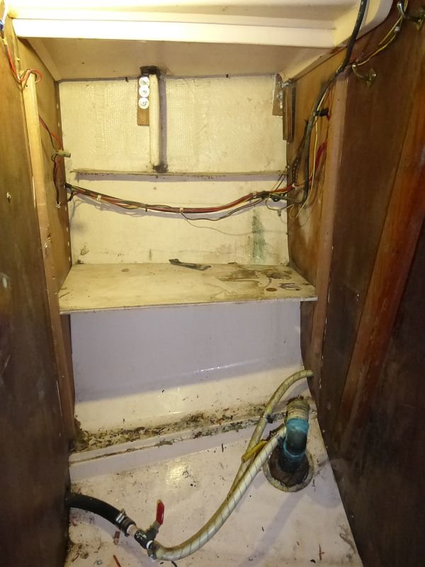

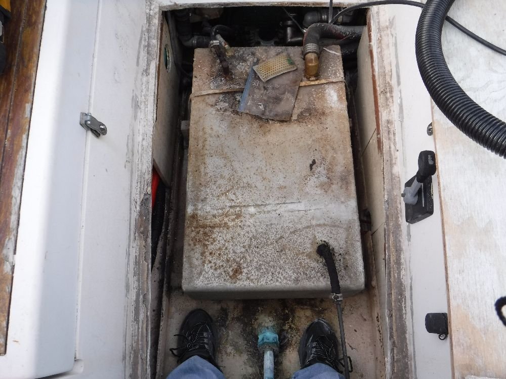

1) remove the ~20 gallon under cockpit metal fuel tank which is probably circa 1971, and...

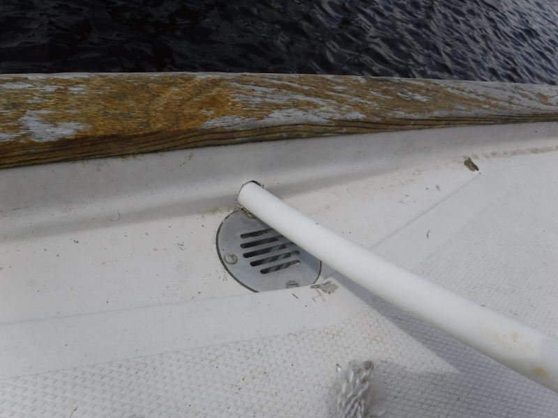

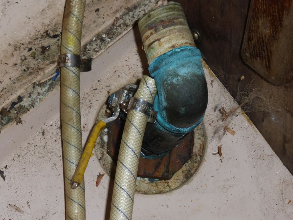

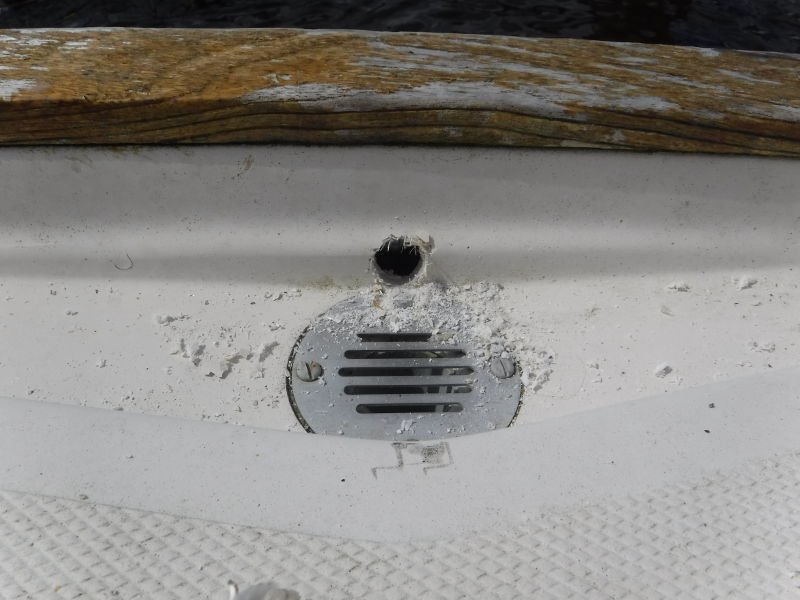

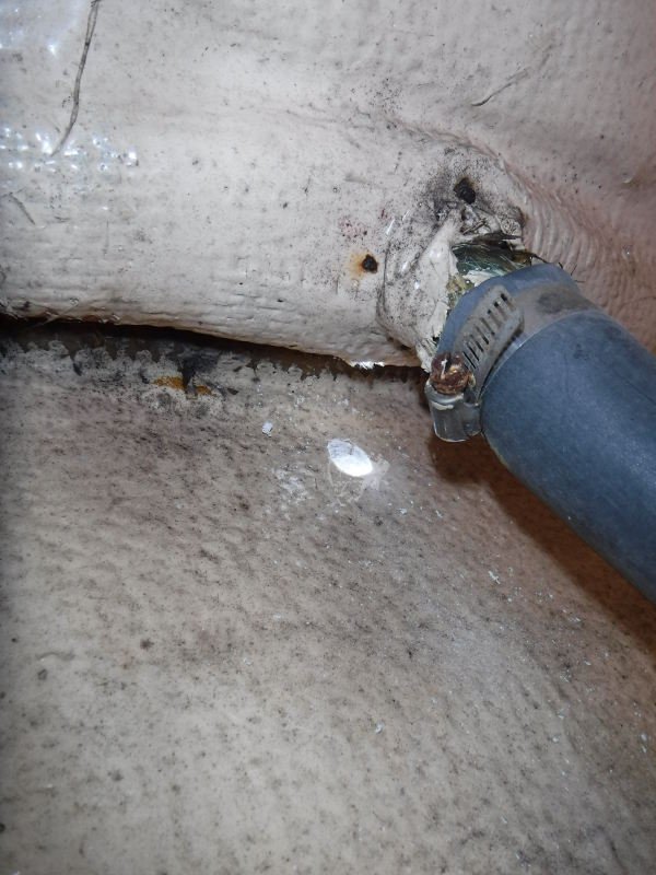

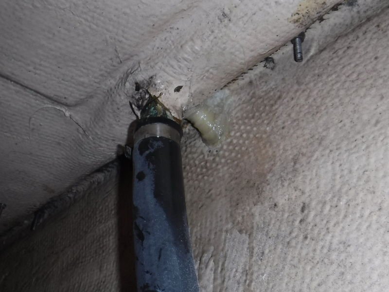

Here's my quick-n-dirty, work-in-progress to bypass the current (and I think original) deck drains/cockpit scuppers confusion and plumbing nightmare. I'll have to get a shot of that to post in here so you can see just how bad it is.
Due mostly to multiple inline elbow joints, it is next to impossible to snake out the drains, and small organic matter from the river I am on seems to delight in finding its way up into that plumbing somehow. This causes the plethora of 90* fittings and small tubing that make up this "system" to constantly block up and this in turn causes water which otherwise should be draining, to instead be forced back up into the cockpit.
Once there, it leaks thru the damaged sole into the interior of the boat.
Basically what I've done is made an 'escape' hole above the deck drains for rain water, temporarily covering the drains so that water on deck is sent overboard instead of into the belowdeck plumbing.
When I get the cockpit sole replaced, I'll put a valve on the bottom of the deck drains so that they can still be used to harvest rainwater, but they will be closed off otherwise, sending deck water straight overboard. Simply stuffing a plug into the 'escape' hole and opening the belowdeck drain (after the decks have been rinsed well) will allow for rainwater catchment. Simpler, less likely to sink the boat, and the cockpit will drain faster after being improved.
I made the hole through the toerail sized to fit the small plastic tubing, inserted it and glassed around it to seal it up.
What you see in the last picture, the material used to set in the tubing, is epoxy-saturated toilet paper.
This works well as a base material for small diameter/tight curves, and it will be getting some proper glass over it for strength before being declared finished.
I've completed just enough with this to divert rain overboard, and it is not going to be finished until I get the cockpit sole done. I may enlarge the 'escape' holes somewhat at that point, although they do well as now sized. It has already made a big difference in how much and often I have to pump out the bilge.

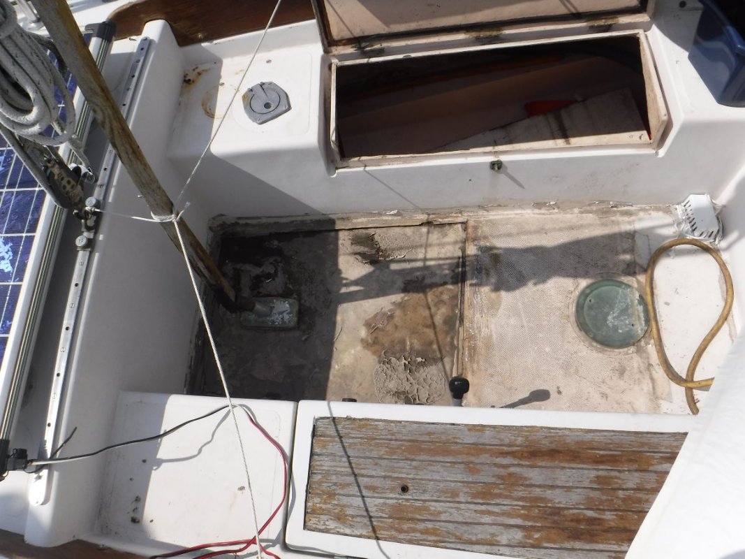

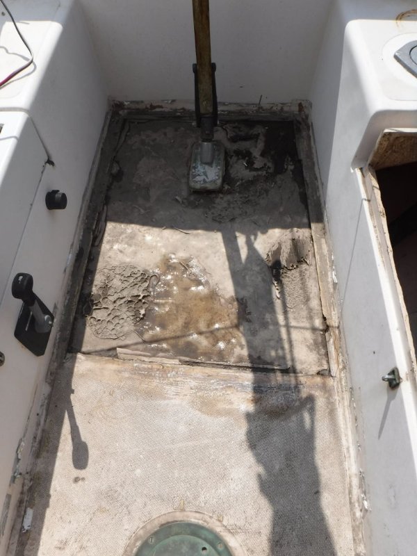

Started in on the cockpit floor job yesterday , beginning with dissection. Ye gads, sodden balsa is some *heavy* stuff.
And man will it bog down a saw blade. Between a circular saw and an oscillating tool, I got the old mess out and am at a point of "(how to) make it (better)".
One thing is the rudder post. On the early A-30's apparently they just made a long tube that came well above the waterline, in order to keep water from ingressing there. On these later models, they went (incorrectly, IMO) to a shorter tube which is below the waterline and thus needs a packing gland to keep water where it belongs - outside of the boat. Alberg's of the "Triton type" seem to want to 'squat' easily, and this puts the rudder post shaft even further under water.
So I put about 250#'s of chain and anchor on the foredeck yesterday to get her back on her lines, but it is still weeping a bit. I think I may try to remove the old gland, and put a pipe in over the shaft to extend it up above the waterline.
Thoughts? Experiences?
My original plan was to glass in a new sole made of foam sandwich, but after removing the old I am left with a nice and fairly even lip around the cockpit circumference, so I think I am going to make the sole removable in some manner. It only makes sense to do so, as the area, while not needing regular access, nonetheless does require a human in there from time to time, and as I think it is likely that the boat will be around until long after me, I may as well make it easier for the 'later humans', when they need to get in there.
SO now to figure out what/how to use for a gasket to seal the area off from water, which will determine to no small degree how I make the rest of the sole.
So again - anyone have any thoughts or experiences to input?

Re: "Sundance", an A-30
I think maybe we all do this.rescuesailor02 wrote: ↑Fri Nov 09, 2018 1:02 am Sometimes I look at what some manufacturers did and I go huh...
It's a keel-hung rudder, the cockpit doesn't really support it, although the fitting thru which it goes I guess does help keep everything lined up.
While I've got it opened up, I will probably also pull that fuel tank for cleaning and inspection. Perhaps even go to a different solution, as it seems to be aluminum and must be OEM from '71; I doubt it has a whole lot of years left in it...
And make the whole space more of a "tub" in order to help prevent the possibility of downflooding.
