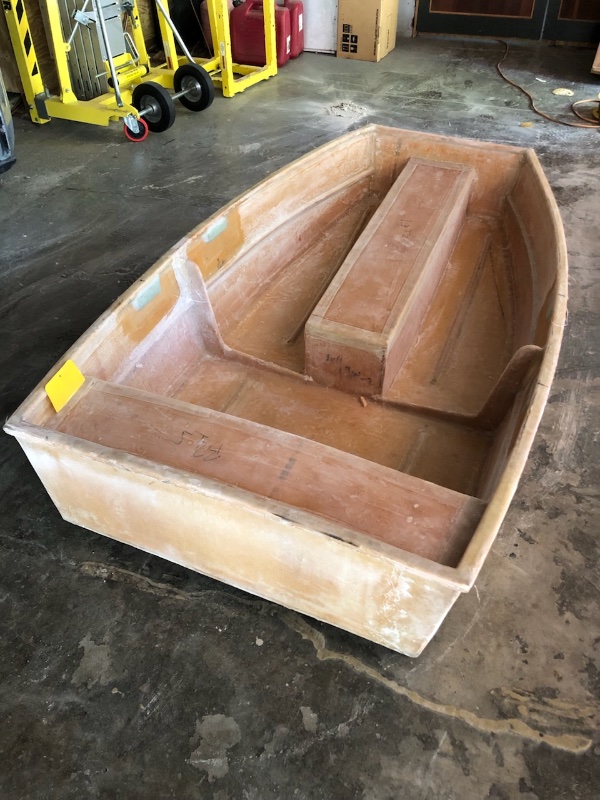

Here is an image of the oar lock mounting blocks fiberglassed into position.
I laminated (4) 2” x 4” blocks that consist of 14 layers of 1708 Biax fiberglass.
I then cut these square with a miter saw.
After preparing the surfaces, I smeared colloidal silica behind each block and pushed them in position. I filleted the edges using West System mixing stick.
Then I applied 1 layer of 6oz cloth over the top.
Maybe a better choice for laminating the blocks could have been a higher density filler but maybe it wouldn’t fillet as well?

lsheaf
- Posts: 112
- Boat Name: Stardust
Re: Atom 6.5 Divinycell
Update:
We begin filling imperfections on the hull with 407.
I found its easiest to long board the hull with 3m wet or dry sand paper. I’m sure it will yield better results than using only an orbital sander.
In order to firmly secure the dinghy for sanding,
I used a ratcheting strap from Home Depot. I attached the ends to a rail next to the shop and tightened the strap. If doing it in your backyard maybe you can find two small trees side by side to strap it to.
The transom and bow are a bit hard to long board so I put the dinghy upside down in the bed of my truck and strapped it down.
lsheaf
- Posts: 112
Update photo:
Post long-boarding
Current weight: 41.5 lbs
Hopefully I can take another half pound off by sanding more excess epoxy inside the boat.
Post long-boarding
