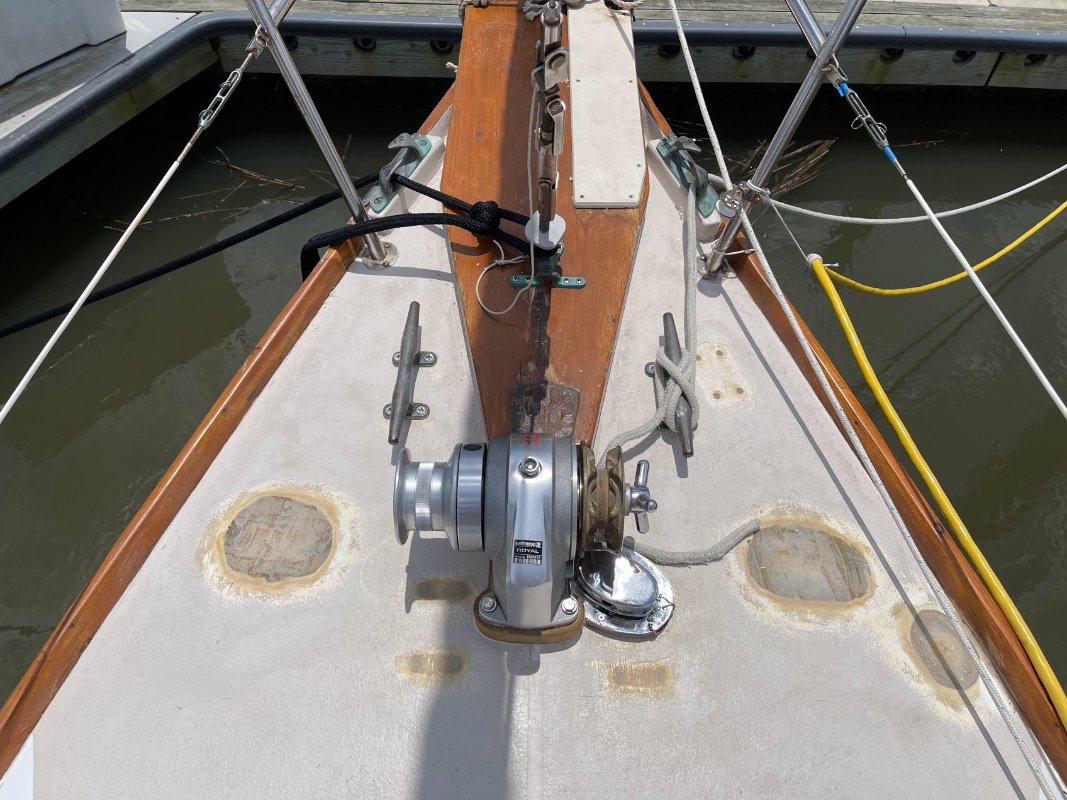

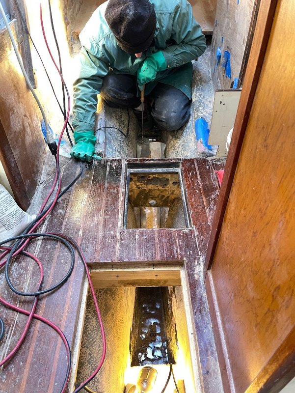

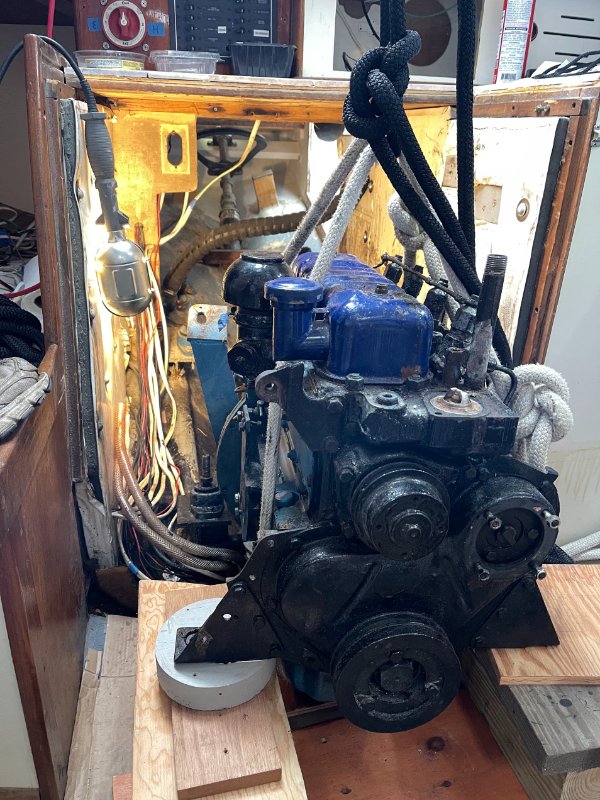

I'm working with accomplished sailor and boat-builder, James Baldwin, on refitting and modifying a 1980 Cape Dory 36 for offshore voyaging. Simplicity and seaworthiness is the overriding theme, and we've made good progress in the one-year project.
So far, we've removed the diesel engine and fuel tank; built a new outboard engine well in the transom that can accommodate either an electric or gas outboard; converted the wheel steering to tiller steering; built a watertight compartment for the rudder shaft with easy access hatches for inspection or repairs; plugged ten unnecessary through-hulls and removed the seacocks; sealed an additional seven unneeded holes above the water line; removed the propeller and sealed the aperture between hull and rudder; rebuilt the port and starboard cockpit lockers to make them watertight; replaced the cockpit sole and reversed the angle of slope so that drainage is to the aft rather than forward; removed the standard marine head, electric macerator, waste tank and associated y-valve and hoses; removed electric water pumps for the galley sink and head sink; removed the water heater installed between the diesel engine and rudder shaft; redesigned and rebuilt the chain locker; replaced the original small anchor with a 45 lb. Rocna and the rope rode with 150 feet of 3/8" chain plus 100 feet of new rope; added a secondary anchor and third anchor; added a manual windless; removed unnecessary fittings on the foredeck and transom and repositioned the bow cleats; built watertight lockers in the v-berth; cut multiple new hatches in the cabin and v-berth sole to provide easy access from bow to aft; replaced the sole in the v-berth; removed most of the electrical wiring; installed a dodger; and begun replacing the running rigging.
Work still remaining includes replacement of the standing rigging; replacement of the sails; design and construction of a new battery compartment to accommodate the house battery and two 48v lithium ion batteries for the electric outboard; redo of all the electrical wiring; installation of a Monitor wind vane and a Raymarine autopilot; installation of solar panels and supporting arch over the cockpit; installation of a marine compost head; and installation of manual pumps for galley and head sinks.
This is the first boat I've owned, and I was not particularly handy before starting this project. So, it's been a steep learning curve, to put it mildly. However, with James' guidance, it's been a great experience, and I can't wait to have the boat back in the water and under sail. Below are a few shots of our progress so far.

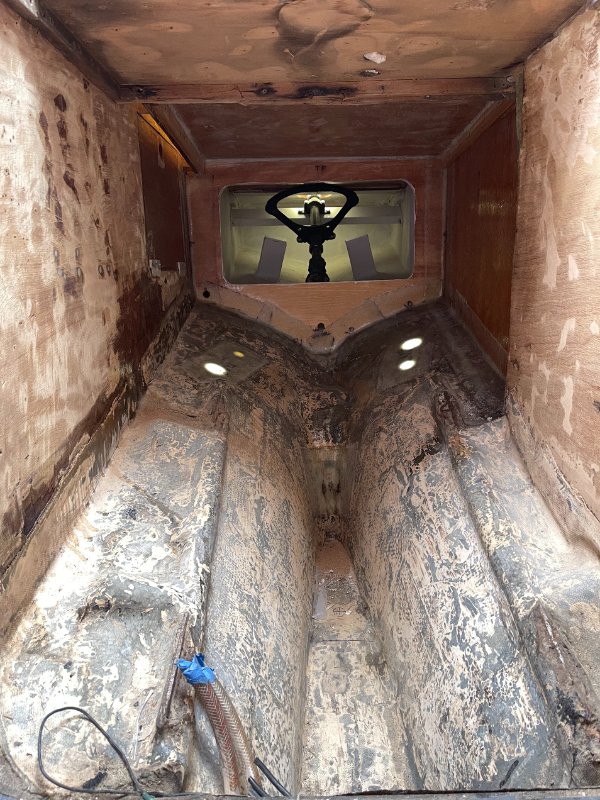

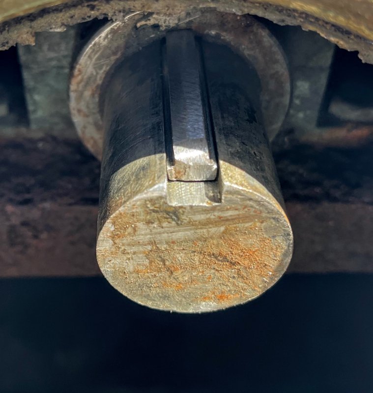

Nice modifications. Can you post some more pics of the wheel to tiller conversion. How does the tiller tie into the rudder post? Very interested in following along as you continue the mods.

The tiller connects directly to the rudder post with a bronze tiller head fitting. We ordered the fitting from Edson Marine. Also, we had a steel key made for the key way by a local machining shop. Getting the final fit right for the key was one of the trickiest parts of the installation, but it's worked out nicely. We created an initial tiller from laminated plywood for test purposes, and I'll keep it onboard as a spare. We've tested the tiller already, and it works like a charm. To me, it provides a more direct and intuitive feel for the rudder and steering action than the wheel that was installed before. Our last step is to craft the final tiller, likely from mahogany. I've included a few photos below. For the motor, I have a 6kW ePropulsion Navy 6.0 electric outboard, which is 9.9 HP equivalent. The battery will be the ePropulsion E175 lithium iron phosphate battery (8960 Wh ⁄ 48 V). I will do initial trials with a single battery but may add another to increase the range. In addition, I have a Tohatsu 9.8HP gas outboard with extra long shaft (25"), which fits in the engine well, and I will have the option to keep it onboard as a backup motor. We've not done sea trials with the electric motor yet, but we did extensive trials with the gas-powered Tohatsu, and it worked well. We covered a 17-mile stretch in relatively flat water and averaged 5-plus knots. For my purposes, this speed will be sufficient. An added benefit of the outboard is that we can generate side thrust by turning the engine in the well, and this allows for easier maneuvering in tight quarters.
I hope this is helpful!!

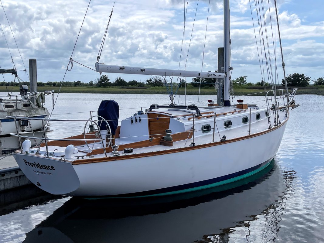

Since my last update, James and I have completed the refit, aside from a few small projects I will wrap up shortly. The overall effort took about fourteen months, including eight months on the hard at a nearby boatyard and the remainder at dock.
Since my last posting, we have installed a Monitor windvane self-steering system; installed a Pelagic autopilot; installed a Tower-in-a-Box solar arch over the stern; installed two 200-watt solar panels on the solar arch; replaced both electric panels and all AC and DC wiring throughout the boat; installed two new depth sounders; installed new cockpit instruments, including a new compass and the displays for the ePropulsion Navy 6.0 electric motor, the Raymarine depth sounder, and the Pelagic autopilot; replaced the tricolor and anchor light; replaced all plumbing, including installation of manual pumps for head and galley sinks and internal drainage hoses and valves for the chain locker, watertight cockpit lockers, and watertight compartment surrounding the rudder shaft; installed above-water through-hulls for manual and electric bilge drainage; installed two new seacocks, one for galley sink drainage and one for galley sink raw water intake; installed a new lightning ground plate on the hull and ground cables connected to mast and shrouds; added two hundred pounds of additional ballast in the bilge, consisting of 125 pounds of lead bars and 75 pounds of lead pellets, and sealed the ballast in polyester resin; rebuilt the head, including installation of a dry compost head, reconstruction and repainting of cabinets and stowage areas, painting of grey non-skid on the sole, and installation of a ventilation fan.
If that wasn’t enough, we also repositioned and re-bedded all deck fittings, including blocks for mainsail and staysail; replaced and re-bedded port and starboard handrails on the coach roof and re-bedded ceiling handrails in the main cabin; finished the rebuild of the cockpit area and engine well with fiberglass, fairing compound and epoxy paint; installed new flooring in the v-berth and galley to match the teak and holly pattern in the main cabin; replaced the bobstay; replaced the forestay and the jib furler with a Harken Mark IV unit 1; sanded the bottom and painted it with two coats of hard coat anti-fouling paint followed by three coats of ablative paint; plugged and painted multiple unneeded holes in the transom and stern area; finished the transom with new coats of primer and marine paint; installed new Formica on the galley counters; reconstructed the watertight seals in the port and starboard locker covers using thickened epoxy and rubber gasket; primed and painted the entire cockpit and stern area with two-part epoxy paint; painted with 2000E epoxy primer all interior and exterior lockers, including a new locker under the port berth where the waste tank had been located, a new locker where the diesel engine had been located, and the port and starboard cockpit lockers; rebuilt the linen closet and painted the interior with 2000E epoxy primer; installed starboard and port chainplates on the stern hull exterior to attach a drogue; installed watertight Beckson plates in the starboard and port cockpits to allow access to the battery compartment and other watertight cockpit compartments; installed knock-down proof latches in all seven floorboards below deck and barrel bolts on other doors and panels for same purpose; built and installed a new mahogany tiller; removed, refinished, and re-bedded all teak on and around the sea hood; repainted the sea hood; revarnished the teak around the companionway; installed a new winch for the staysail sheets; and raised the gooseneck four inches to provide more head clearance in the cockpit for the boom.
Given all the work outlined above, the refit itself has been quite a journey. Recently, the focus has shifted back to sailing, and the boat has been performing wonderfully. Not surprisingly, we’ve had a few small kinks to work out, but overall, the outcome has exceeded my expectations. In the days ahead, I’m looking forward to enjoying more time on the water with the new SV Swan.

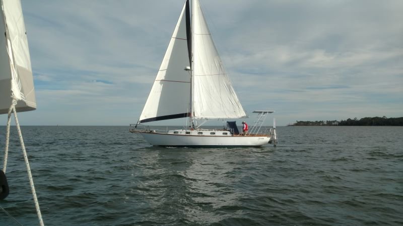

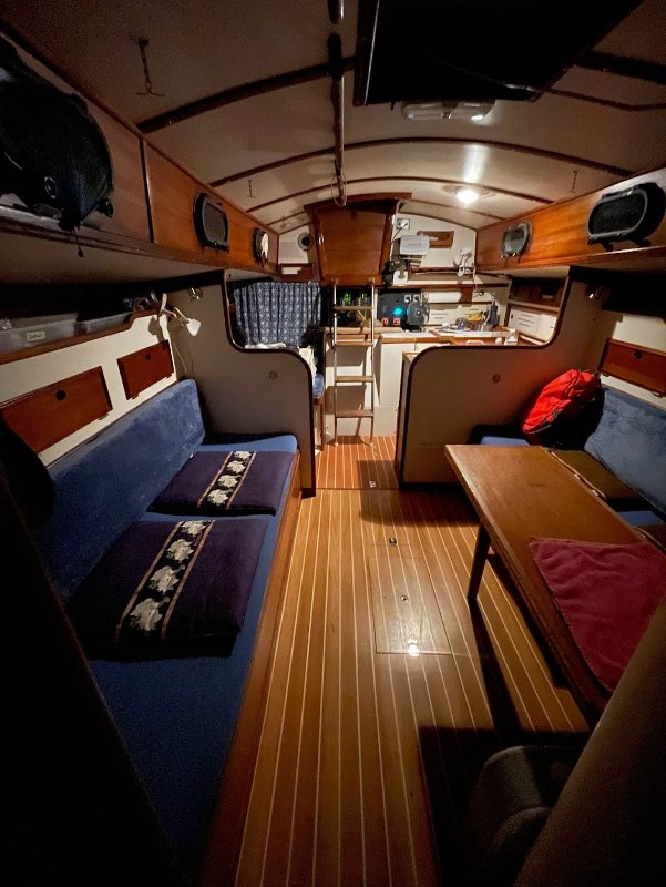

Here are some photos showing the refit project and results:

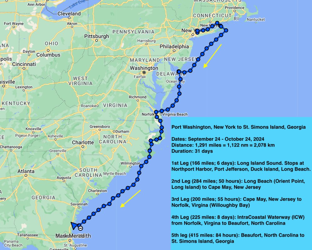

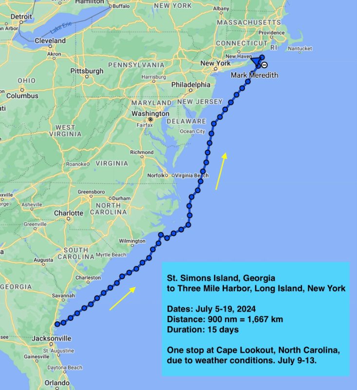

Since I last posted, I’ve shifted focus from the refit work to sailing and traveling with Swan and since the start of the year have completed two significant initial voyages. The first was a three-month circuit through the Bahamas starting and ending at St. Simons Island, Georgia. I cast off on January 27th and dropped anchor again back at St. Simons on May 5th. The first leg of the trip was an offshore sail down the coast to Fort Pierce, Florida, followed by an additional day on the ICW down to Lake Worth. From there, I made the jump across the Gulf Stream into the Sea of Abaco, and after exploring the Abacos for several weeks, continued on to Eleuthera, the Exumas, and then Cat Island. The return trip was a direct six-day shot from New Bight, Cat Island to St. Simons Island.
The second voyage was another circuit from St. Simons Island, this time up the East Coast to Long Island Sound and back. The whole trip was about four months. I cast off on July 5th and dropped the hook again off St. Simons as the sun set on October 24th. Instead of going through New York City and up the East River, I stayed on the outside, continuing on to the end of Long Island and then rounding Point Montauk into the Sound. The trip up took one month, including a single stop at Cape Lookout to let some weather pass and a series of day sails to work my way up Long Island Sound once I made it around Point Montauk. The longest leg was the six-day trip from Cape Lookout to Three-Mile Harbor, my first anchorage on Long Island. Ultimately, I made my home base at the anchorage in Port Washington, which offered a charming sailor-friendly town and a short hop to New York City on public transit.
The return trip also took one month but was very different. My preference was to go direct from Long Island Sound to St. Simons Island, but not surprisingly, the weather did not cooperate. My first stop was at Cape May, New Jersey, where I ducked in and anchored for one night. Then it was on to Norfolk, Virginia, where I was forced to divert, again due to dicey weather in the forecast. I had hoped to continue offshore, but after several days at anchor and no sign of a good weather window, I opted to take the ICW, and after eight days, including two at anchor enroute, I arrived at Beaufort, North Carolina. From there, it was a straight shot offshore back to St. Simons.
The two trips ended up being excellent shake-down sails both for Swan and for me. I felt my own sailing skills, judgement and endurance were tested to the limit, which was not always pleasant, but in the end made me a better sailor. There is always more to learn and always room to improve, but I feel more and more comfortable at sea on Swan, certainly more than at the start of the year. As James has often told me, there is no substitute for experience, and it was a great first year in that respect.
As for Swan, it’s amazing for me to think that given all the decisions that were made along the way, including the boat itself (Cape Dory 36), the decision to replace the diesel with an outboard motor and outboard well, and to equip the boat with both an electric and a gas outboard, there is nothing I can think of that I would do differently. The boat itself is stable and seaworthy – truly a classic full keel design – and the series of modifications made by James make it perfect for the solo offshore sailor. Swan also did just fine motoring through the confines of the ICW for days on end. As any sailor and boat owner knows, the list of maintenance and repair tasks never ends, and the list of new things to learn and master as a sailor also never ends, but so far it’s been a good start. We’ll see where things lead!
Below are some photos from the recent two voyages.
