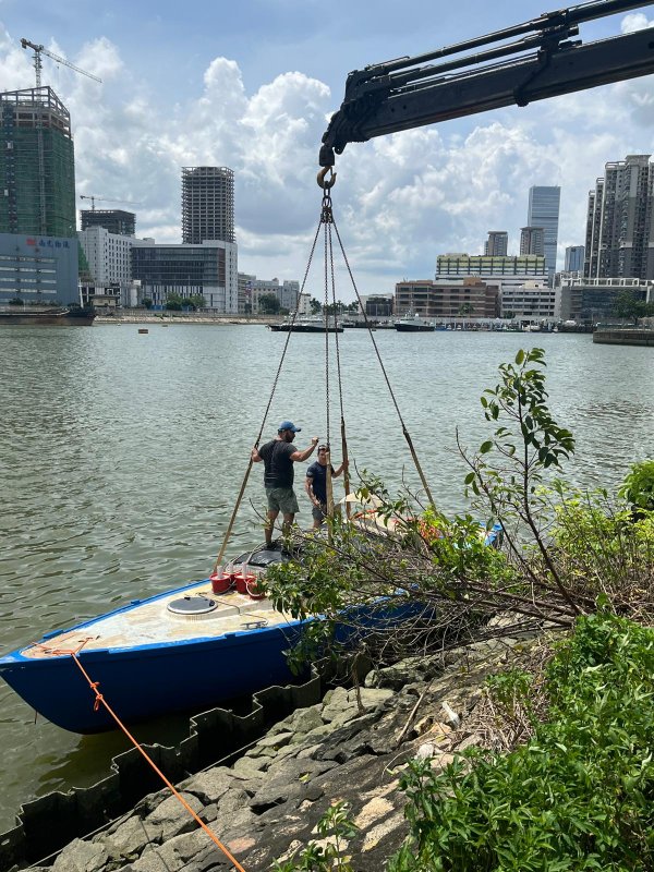

Latest about Katie J
Ive decided to complete the refit on land until the end, even if thats a few years away.
Ive hired a crane and got her back on the hard
slinging the straps
tensioning the rig
