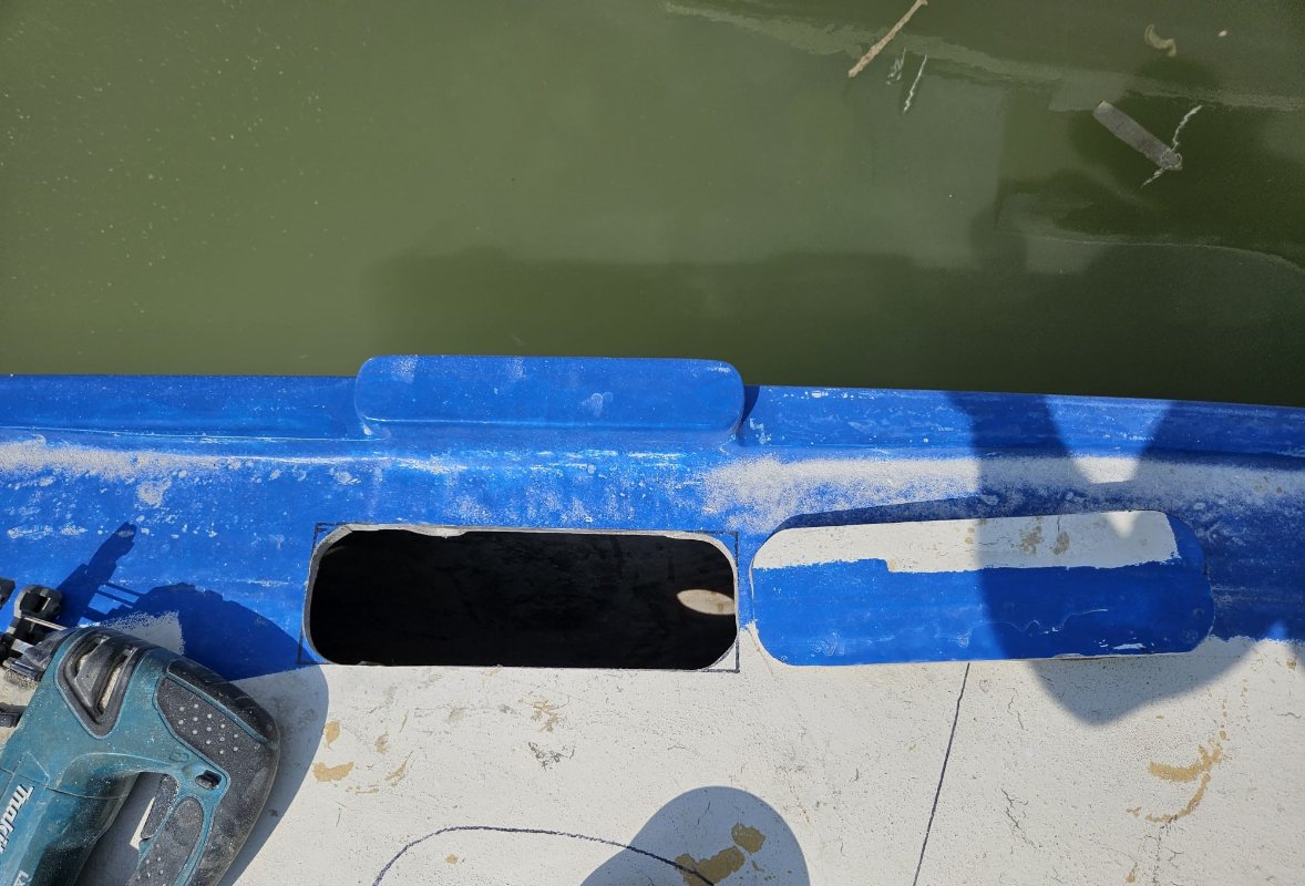

a lapse into the future
months ago i got my cad drawings plotted and so now i could do the cut outs and transfer them to the G10 sheets i then cut the long lines with the grinder and did the round sections with a jigsaw. those cut are far from perfect, some can be tuned up and some dont. im not that worried because the lid has a nice overlap so all those small mistakes are pretty much always hidden aniway.
it will take me some time to get ready to glass this piece.
i need to devise a system that will,not only enable to attach the hinges, but also to easily remove/replace them in the future.
For now im thinking i will use that poltruded fibreglass corner, cut where needed to fit and tapped for metal inserts.
All of this needs to be done before the piece goes in as it would be a nightmare to have everything line up working in such small and confined spaces. i wont have much clearance from the bottom of the cabinet to the matress but i can always get a thinner one. the sample i got was 6 inches thick. Maybe 4 inches still makes for a comfortable bunk.

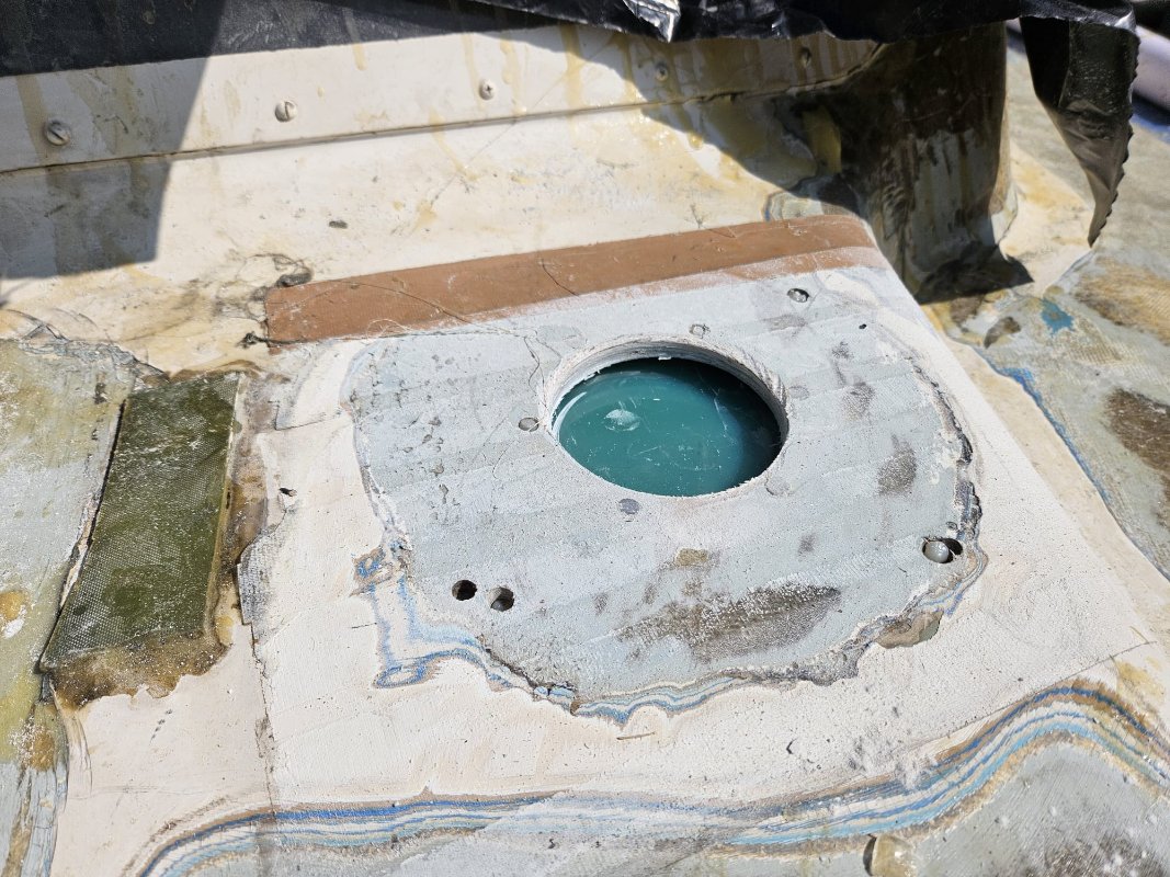

pushing forward on some other jobs
epoxy lining the inside of the water tank lids glueing the supporting lip for the fwd lid
trying out an epoxy putty from a taiwanese brand called Rainbow. really thick stuff to mix and apply but cures pretty fast and hard
i gave it a light initial sand with 80 just to get a feel. 40 grit will be much better for a first pass then higher grits to fine tune
just after applying after partially sanding with 80 grit

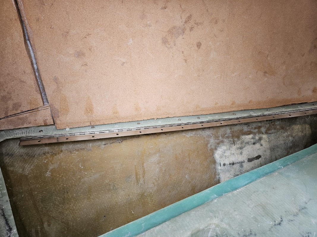

V berth Portside Fwd Locker
dry fitting the piano hinge
dry fitting the lid
lid closed
there is a bit of spring back on the lid which tells me the piano hinge might be bowing a little. i dont thin this will be a problem and the lid will have locks to keep it closed after fitting the lid i proceeded to paint the interior of the locker with one coat of primer and one of paint
i had some surplus on both times so you will noticed i took the chance and applied it to the cork panels to see how they would react to the products
primer paint i will apply more coats of paint, with some sanding to remove the bigger runs and imperfections but i will not waste much time on it. these are lockers after all, almost always closed, so i will focus way more on the visible sections of the interior
dry fitting the lid
lid closed

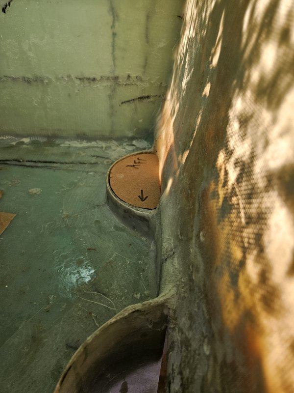

It will be interesting to hear how the cork works out for you under paint. I have a roll of leftover 6mm thick cork here I'd like to use on some future project.
What type primer and paint do you use in lockers? I may have mentioned before that I like to use white Interprotect 2000e or equivalent epoxy barrier coat as my only coating in lockers since it always adheres well, is rock hard, goes on easy and fairly smooth with a short nap mohair roller and disposable chip brush for corners. But the downside is you have to wear an organic filter mask.
You've worked a lot now with thin G10 board. We discussed it earlier but do you have any tips or warnings on its use now that you've worked with it so much? The long thin panels seem like they would flex a lot if not supported in some way, at least more than what's needed for a thicker plywood or a cored fiberglass board. Do you use it so much everywhere because you get it at a discounted price or just like the convenience in some ways as opposed to buying or making your own lighter weight foam cored panels with a thin layer of glass on each side. If waterproofness is you main concern then sealing the plywood with a couple coats of epoxy resin should make it last your lifetime and longer. Foam panels are more work to make I know and they don't hold fasteners well. Do you attempt to use short screws on your piano hinges that go into G10 or bolts with nuts?
- pmnfernando
- Posts: 338
- Boat Name: Katie J
Re: Introducing Katie-J
from research i knew the cork would take epoxy based products, so i knew the products would stick.
there is some inherent porosity (lacking a better term) to its surface, so this test was to see if the products would somehow fill those minute spots.
i will have to return to the boat and observe that but im pretty sure they wont be enough to fill the spots.
my initial idea was to laminate, with 3Oz cloth, all the edges of the cork panels to its adjacent surfaces (just a 1 layer lamination) and then apply a thin layer of fairing over everything to close the pores and provide a smoother surface for any other products.
i think im still doing that going foward
the products i used were: International Interprotect and International Perfection.

closing the water tank
lining the fwd section with the epoxy coating product laminating both lids
i dont actually use thickedned epoxy in between the contouring supporting lips and the lids, as that would create interior squeeze out which would then contact the water you will be drinking in the future.
i do place a bead of thickened epoxy, all around, but just as a filler -between the very edge of the lid and close surface itsd being tied of to- and as a fillet so that the cloth trasnsitions in a better way from horizontal to vertical direction.
As always i do 2 layers of biaxial cloth. the lid is 3 mm G10 sheet

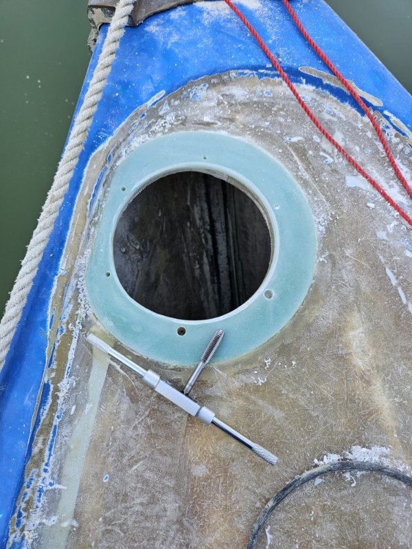

not much done this weekend but prepped some things for the coming one
trimmed the excess pvc pipe running thru the swtb cabinets. installed a T section which will enable running cables thru the inside of the water tank (Ie the battery bank and from here to everywhere on the boat) and out to the future switchboard
I could then install the pvc run that will run the cables to the cockpit locker and consequently to the aft lazarette locker
the future switchboard will be built around this pvc section enabling watertightness on its interior.
Im still brainstorming the final shape/volume for the switchboard.
For now im inclined to make it a continuation of the cabinets facade and by creating all that volume i would be creating all the space needed (one hopes) for fuse blocks, bus bars, MPPT controlers, DC to DC chargers, battery switches, and all that goes with that. The plan is also to install a couple of those low voltage computers fans (intake and exhaust) to keep air circulating at all times inside. i could then rought fit some bits of cork for the insulation
After a couple of measurements it became apparent that i wont be able to install the inverter in aft portion of this space as initially wanted.
It will have to be installed in the aft lazerette locker.
this means running more cables fore and aft but it also frees up space on top of the water tank, which means storage.
So, even if not completely happy about the inverter, i cant honestly say im unhappy with more storage..... boats eh! I also took some time to see how the cork painted areas faired so far and to be honest im surprised at the porosity coverage. its better than i was expecting.
i am still going to apply fairing compound and sand because i want a neat finish (and because the cork got dented from bracing it into shape with struts which exerted a fair amount of pressure to make it conform to hull shape) but if you have a clean glued up panel, i would venture that a couple of primer coats, plus 2 coats of paint will do the job.

isolating the engine room from the rest of the cabin
due to the way i built the water tank - with an inbuilt semi circle molding to make space for the ballvalves - that meant the engine rooam wasnt isolated from the main cabin.
i plugged those semi circles with cork layers and laminated over them to waterproof everything
i used 3 layers of cork, to a total of 90mm thick. that should help in keeping heat and sound contained
view of aft plug after laminating

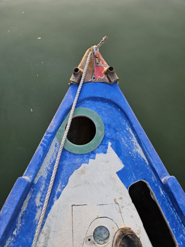

new bow hatch
since i made the decision of installing a watertight anchor locker/collision bulkhead, it always made sense to make that space accessible from the deck rather than opening the bulkhead (which will be held in place by a decent amount of bolts)
After all, the only stuff it will house is the chain and warp so, in a pickle, i need to access that space to untangle anything that might have went awry.
i got hold of a nice 316 stainless hatch and placed on deck to have a feel for its best location, knowing it will always be to port since the chain will run to starboard
(that other opening - when will i ever stop!-, is for another project im currently building) i had taken measurements from the hatch, made a cad file and had it cnc cut into a plywood template with the template i was able to transfer it onto 6 mm G10 sheet, creating a "washer" that will level the deck making completely flat to receive the hatch.
luckily i had a hole saw that is the exact inner diameter. i cut the outside diameter with a jigsaw dry fitting the washer to determine where i had to flush cut so it would fit the toerail moulding i then put everything together marked where the bolts would be done and glassed the washer in after curing i was able to tap threads and install the metal inserts and finally bolting it down this project is almost finished. i will laminate a couple of layers of glass on top of the washer to ensure nothing will move in the future

A couple of posts ago i couldnt get around a spoiler by showing yet another hole ive done in my stb bow.
That opening is for a new compartment being built inside the anchor locker.
The idea came about because i realized i would need a tool to help me unscrew that shinning stainless access hatch ive installed.
So it made sense having it stored where it will be most used: at the bow, at night, when everything is going bonkers.
The aplications for that space quickly grew in order to house future windlass buttons, some cam lock fitting to help transitioning the water lines and cabling from the nav lights (future install) from the deck to the boat's interior.
I try not to make a big fuss when its time to puch a whole in the deck. pretty much all of it its "aesthetically eyeballed", meaning that if it looks right, it might be right. i do take some care ensuring i cut the surfaces whilst retaining a bit of a lip where i can tab and laminate should that need arise in the future.
In the photo thats apparent by the 50 mm distance between the toerail and the closest cut line detail of gap between the deck and grp cabin liner i still have soft spots on the deck,and seeing this made me think if they arent, apart from the boat age, one of the reasons why i have them.
because ive been rebuilding so much of the interior with vertical pieces that connect the hull to the deck, ive eliminated deck flexing to a great extent.
i will try to improve this situation by mixing very runny epoxy and just pour it down in the affected areas, effectively bridging these gaps together and maybe getting rid of the soft spots.
it was then time to pattern the aft and fwd walls of the compartment, making sure to include an outboard and forward going slant to make it self draining tabbing the walls tabbing the bottom tabbing the last panel you will notice this last panel is oversized.
i needed surfaces to apply the epoxy, to keep in place when i laminate it from the inside. after that it will be trimmed, rounded and laminated over

in case you are left wondering what are those 2 holes to port below the big one for the hatch compartment, ive bought some neat polypropilene cam fittings.
These are watertight and will be used to enable a water line at the bow and as a way of pumping water out since i will have a permanent roving bilge pump installed, ready to be used at all times.
Propylene isnt UV resistant so so they have to be used inside.
Cam fittings couple of views when not in use they can be capped

STB cabinet works
some post ago i showed the facade of the STB cabinet in place, mentioning that i still had a lot of work to do before that happens.
and all that work starts with epoxying the poltruded grp corner piece to the inside of the cabnet piece
i chose to get a full run as it is much easier to get everything lined up to the same height when the time comes to attach the hinges.
the hinges will be placed in a template fashion, onto a 3mm piece of G10 which will, in turn, be bolted to the GRP corner piece. this way it possible to expedite the process whilst making sure that each lid will be pretty much identical (thats the theory!)
it also means that any future repairs ensure that the lid is taken out as one piece (lid plus hinges) which i think helps
this photo is the classic "the more clamps the merrier", i thought 6 clamps would be enough...ended up using 10.... after cure detail before trimming after trimming
here i trimmed lenghtwise and also making space for the partitions wall between the different spaces

Mast compression works
Since the very begining this was an area in need of work seeing how the existing arrangement has failed.
It was comprised of a goal poste in the aft face of the main bullkhead and a simple metal angle piece (6mm thick) on the fwd face. both were bent.
Going back a couple of pages you will find my solution.
I designed the pieces in Cad and had it made by a metal shop.
The guys at the metal shop actually bent the metal sheet as opposed to welding them together at 90 degrees at one another, as i had initially specified. i actually think bending makes the whole thing stronger.
It was the time to get the whole system together, which i did and had a slight slant towards portside that i said i wouldnt correct. i lied.
i ended up correcting it as you will see
to begin with i epoxied a G10 3 mm sheet to make for the flatest surface possible onto which the metal pieces will be affixed.
i opted for this choice after the firsts dry runs and observing how the surfaces werent matching.
prior to glueing the G10 it was time to correct the slant
so i plugged all the holes minus the one which would enable me to hinge the whole piece with the least amount of overall change
fwd surfacing in G10 with the vertical surfaces done i one again used the metal pieces, bolted them to the bulkhead and simply stuffed the gap with previously cut G10 sheets and loads of thickened epoxy in order to have everything squeezing out on me. and i did! i had resin in my hair for days!
before demoulding after demoulding after demoulding 2 from the deck it was apparent that i was unable to completly fill the last couple of mm i mixed some pure resin and poured it untill all was filled after this i could cut the vent holes with a hole saw still more filling to do, im not worried about these gaps it wont affect anything structurally
- pmnfernando
- Posts: 338
Lastly, i drilled the hole in the metal piece with a hole saw. that was a bit of a fight and i need a new hole saw to finish the second vent hole- i was able to have the pilot hole done so it will be pretty easy to do.
this project is almost done, i still need to do one more application of thickened epoxy in order to completely fill all the spots missed during the previous runs.
i will be using the metal pieced as clamps for that.
