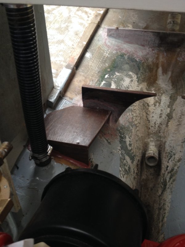

The muffler sitting in place. You can see the exhaust on the right.
In this photo you can see the height difference between the two. The muffler inlet is suppose to be twelve inches away from the exhaust elbow. I just have that much distance. The water injection point is suppose to be six inches above the water line. I do not have that so the next option is to put a vented loop in the cooling water line before it goes into the exhaust elbow. It need to be sixteen inches above the water line and close to the boat center line.
