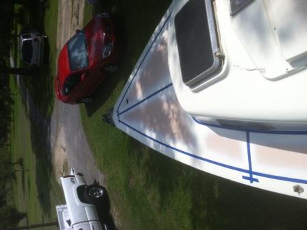

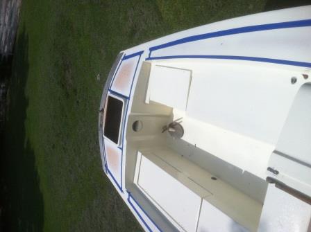

I pulled the tarp, towed it to the car wash, then parked it here. I'm thinking about sanding off the non-skid from the foredeck, and then repainting.

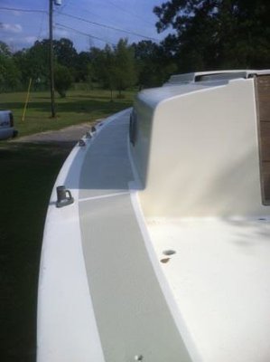

Picked up the paint and non-skid additive at Lowes. The thinner is for clean up.

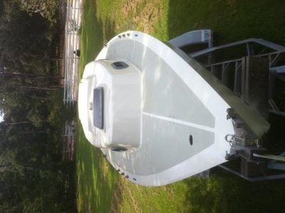

A closer look at the new fairing work: I removed this deck and installed a full bulkhead. It makes the hull many times stiffer, and when punching into large waves, no flex is perceptible.
The paint: It's 12 dollars a quart. Because the boat spends most of it's time under cover, this paint could hold up for a long time. If after awhile I change my opinion, this small area can be sanded back to bare glass in half an afternoon and the project can restart from square one.
													The Coronado 15 sails well. It has plenty of sail and a comfortable cockpit. The hull and the foils have been faired, the boat has many new parts and it gets faster every year. The trailer is also in very good condition; it received a lot of time, and resources.
