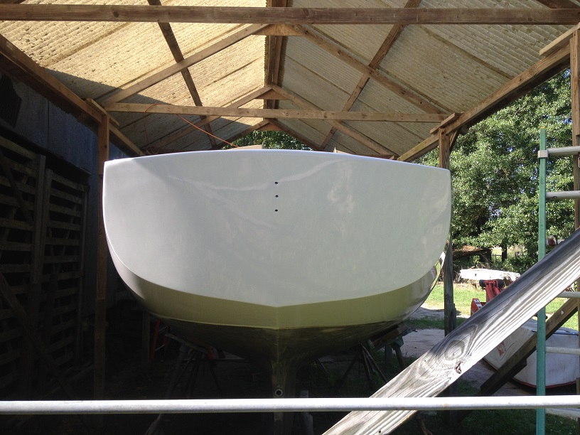

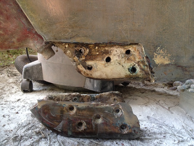

It's been a little while since any work has been done, but the summer heat is easing a smidge and I've started back. I got the old 1 1/2" seacock/thru-hull for the sink drain cut out. I beveled out the sink drain hole and the hole for the old 3/4" water intake on the other side. Epoxyed on four layers of biaxel on the out side of the hull on both holes today.
holes filled.JPG (58.04 KiB) Viewed 70977 times
engine string.JPG (47.47 KiB) Viewed 70976 times

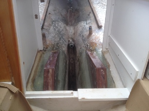

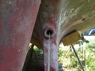

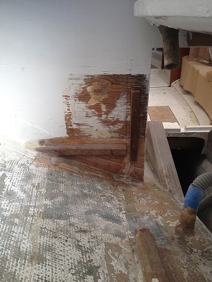

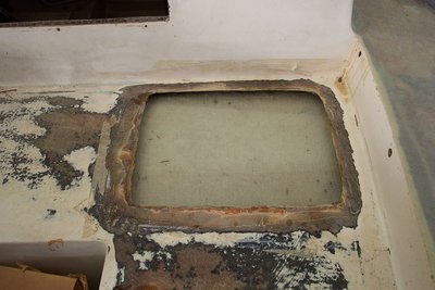

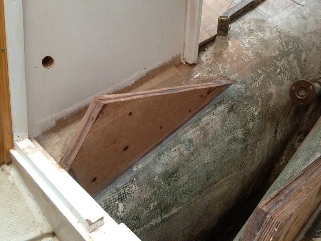

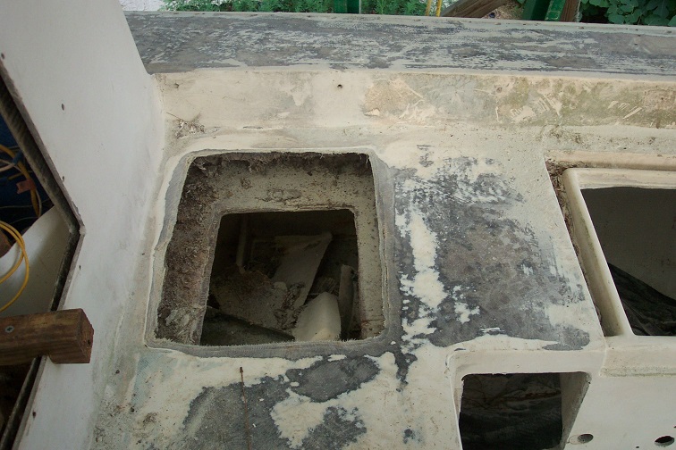

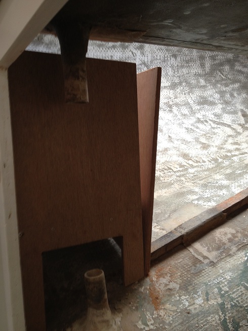

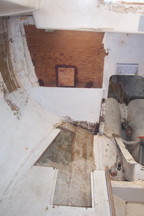

Last week I finished off filling the two thru-hull holes. Now I was able to start on the engine beds.
I managed to get two pieces epoxyed into place on each side after cutting them out and fitting them. Today I put the third one in on each side. One more to go, then tabbing them.

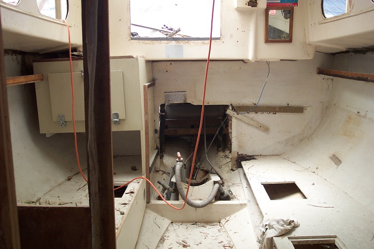

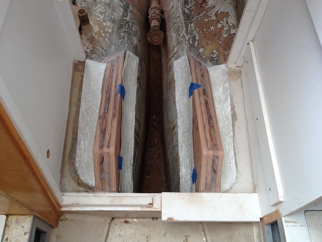

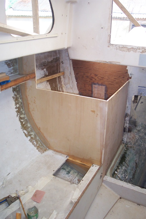

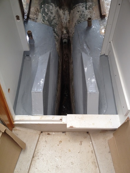

Still working on the engine beds. After getting all four plywood blocks epoxyed into place I cut out two layers of biaxial tape (one 6" and one 4").
I then epoxyed them in place. I used the extra epoxy to coat all the plywood also.
I plan on covering the engine beds with one layer of biaxial cloth lapping down over the tabbing holding them in place.

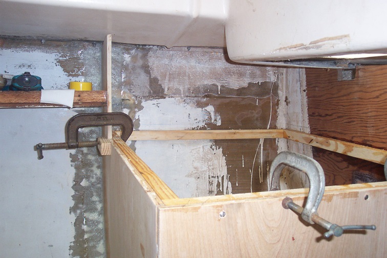

So while all that was wet I started on the starboard battery box. It is located in the starboard cockpit locker (forward end) aft of the ice box. This one will hold two 6 volt batteries. Most of the pieces are cut out, except the lid. Still have to glue-screw into place.
I am waiting on a few parts for the head and poobox (thru hull, valve, thru hull for the box) to come in so I can continue work there. If it will fit I want to put the thru hull-valve beside the head.

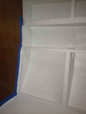

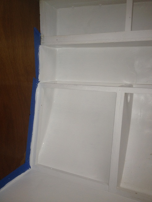

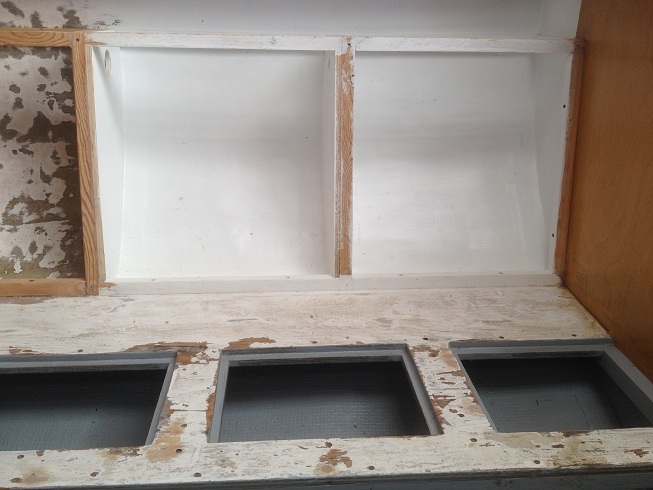

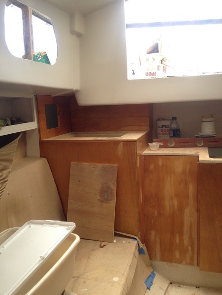

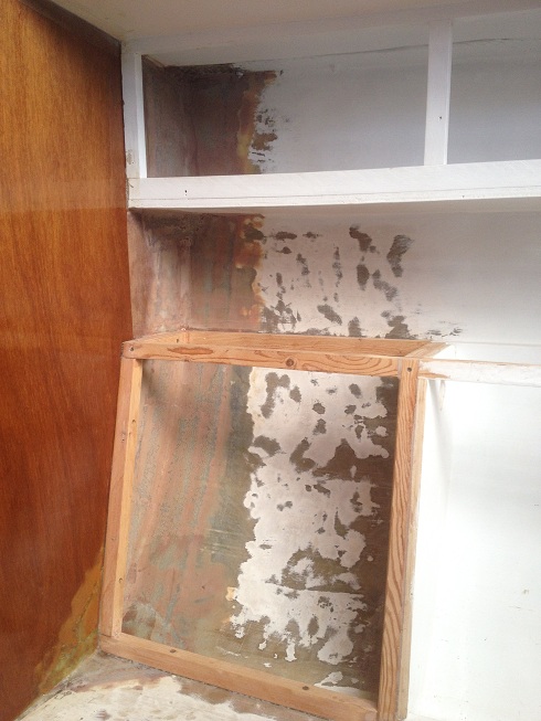

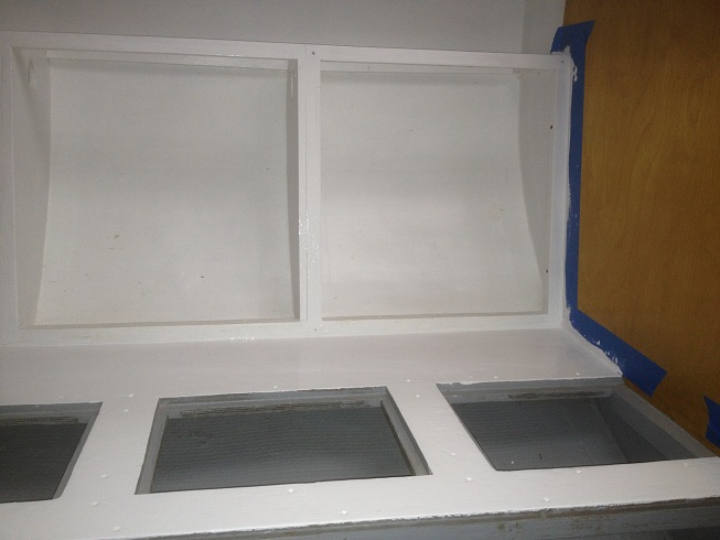

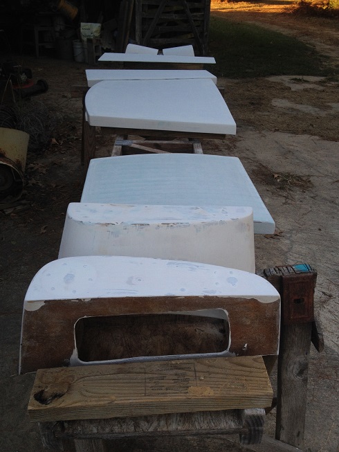

I haven't done any work on the boat since last fall. Saturday I decided to something, so I cleaned up an area.
Then I put two coats of primer on.
If nothing else that made it look better. I hope to get a coat of finish paint on it soon.

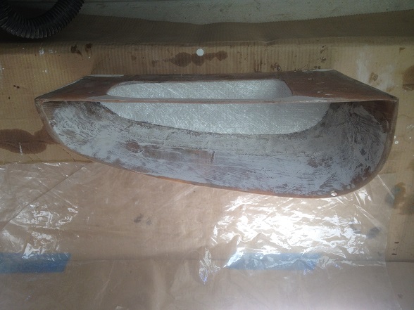

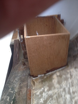

Last fall I got the two battery boxes epoxied in place. One is on the port side and the other is on the starboard side. A couple of pictures from then.

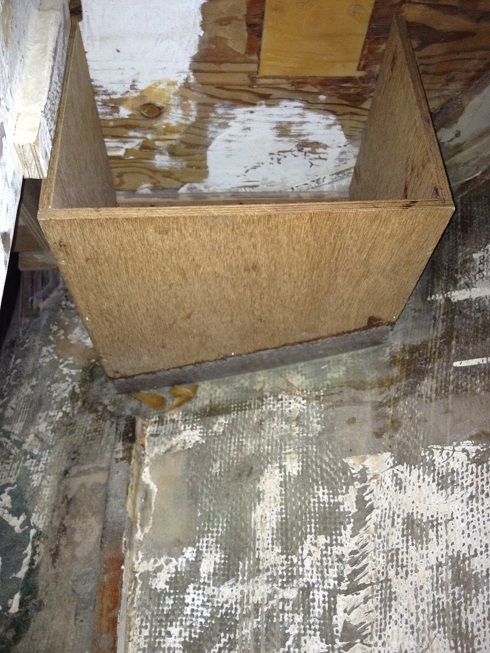

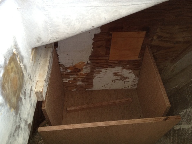

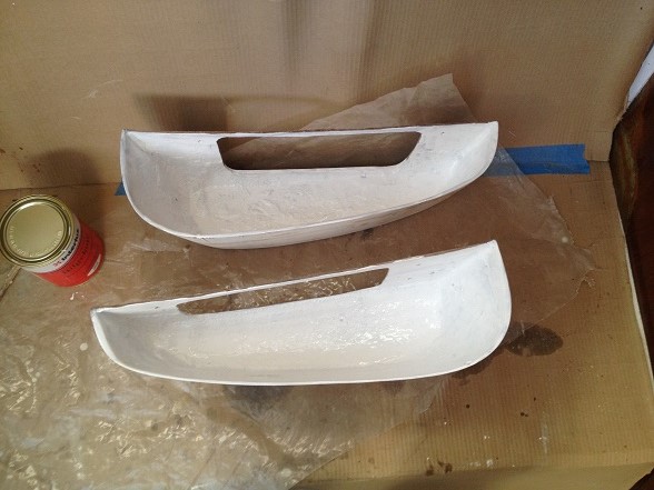

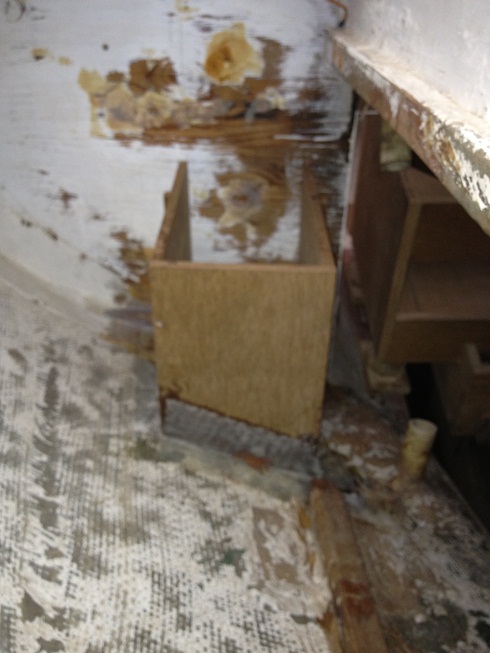

Well it's been awhile. Three weeks ago I got some free time so I decide to work on the Bristol. I had decided that I had put the battery boxes in wrong. I had set them up for the batteries to line up for/aft. I wanted them to line up side to side. So I cut them out.
I rebuilt them (added a fourth side), refit them and epoxied them back in.

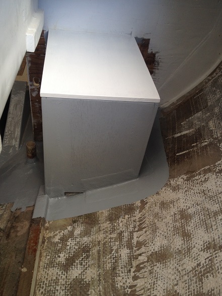

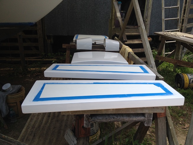

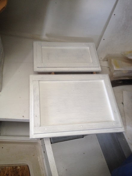

The next weekend I made the lids for both battery boxes and started painting them.

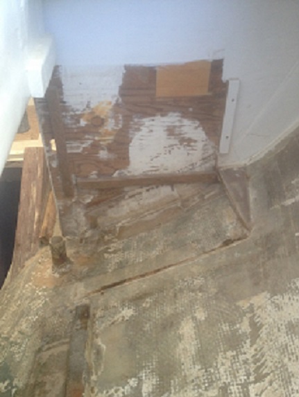

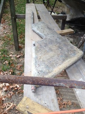

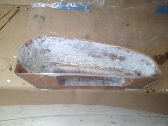

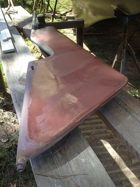

I also started working on the port wench base. The wood on the underside had rotted out. I got it all cleaned up and cut all the blocks out. I epoxied in one of the new blocks.
I went to mix up some more epoxy and was out. So I cleaned up and headed up to the house to put in an order. I ordered epoxy, biaxial cloth, 6 oz. cloth, 1 1/2" thru hull and some hose.

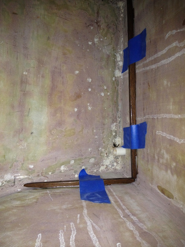

My order came in Friday so today I got some tabbing done on both of the battery boxes.
Also got one of the bottoms epoxied in place.
Finished epoxying in the blocks in the port winch base.
Then I got the last layer of biaxial cloth on the engine beds.

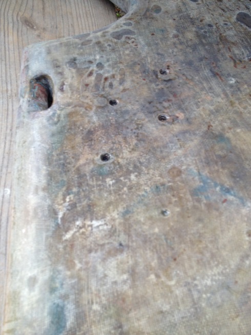

I got a layer of biaxial cloth on the underside of the port winch base. Picture was before the epoxy was added.

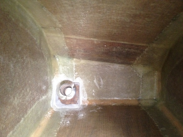

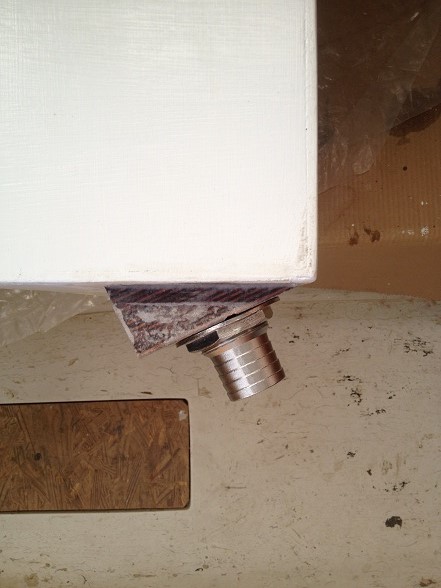

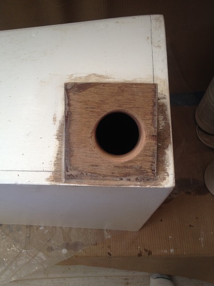

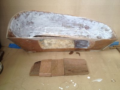

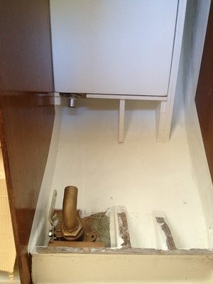

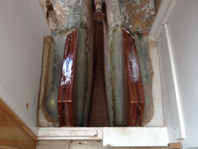

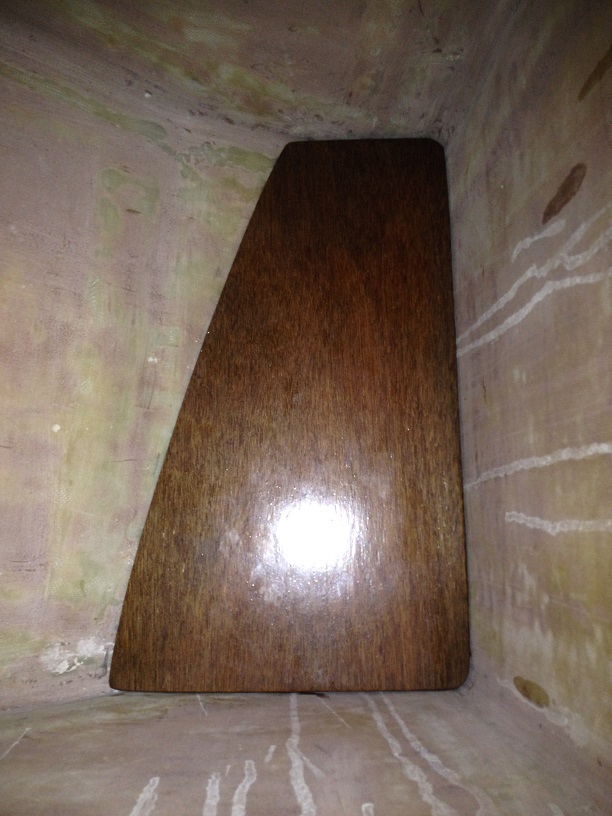

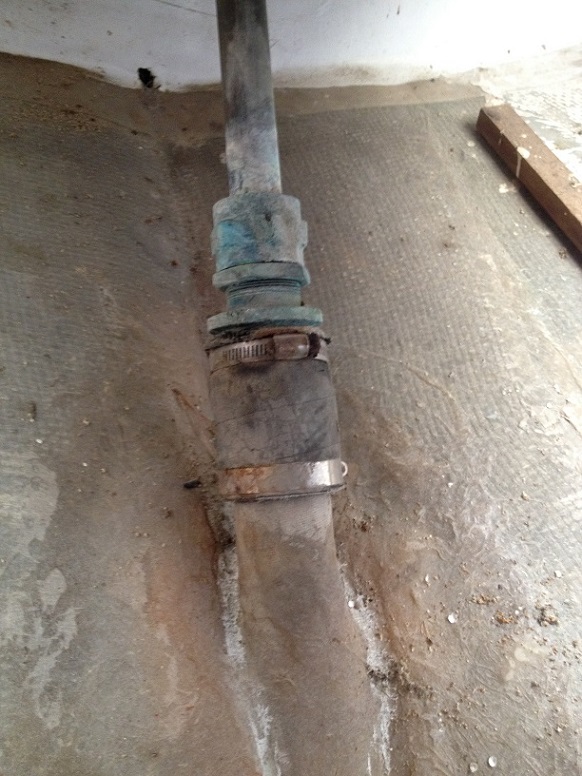

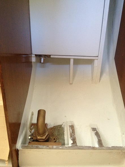

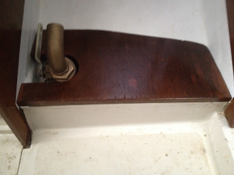

Some Poobox work.
Added a block outside
and one inside the box.

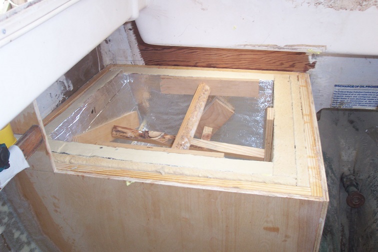

They are there to hold the thru hull fitting (bottom drain) on an angle for better hose attachment.
Then I cut the base for the Poobox for the new block on the outside.
The hull thru hull is just sitting there in the picture (not installed yet) but that is where it's going to go.

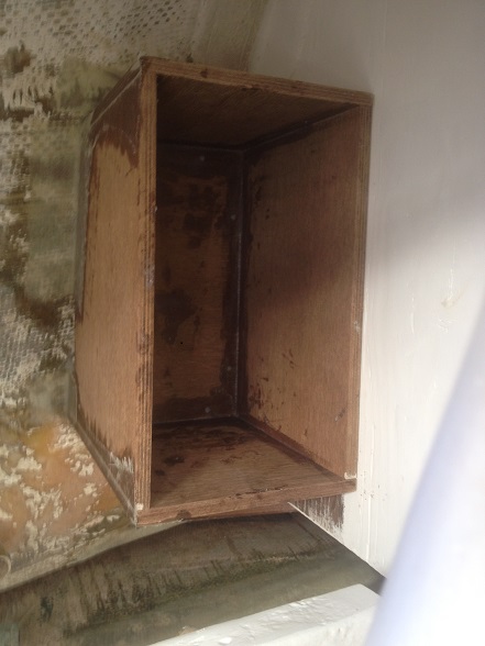

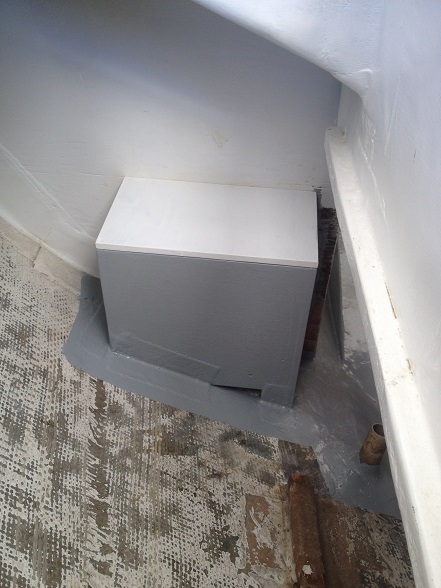

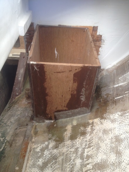

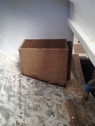

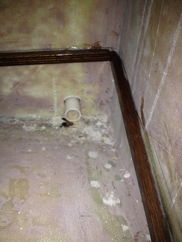

Well the battery boxes are painted.
Starboard, two 6 volt batteries.
And port, single 12 volt battery.

Can they breathe? You don't want to accumulate Hydrogen gas (lighter than air) during hard charging periods...
Posts: 188
Boat Name: Ella Marie
Boat Type: Bristol 27
Location: Pelahatchie. Ms
Re: Bristol 27
Post by Lloyd »
No vents yet. I haven't decided how/where to vent them. The cockpit lockers are open to the motor/bilge areas right now. Any ideas are welcome.

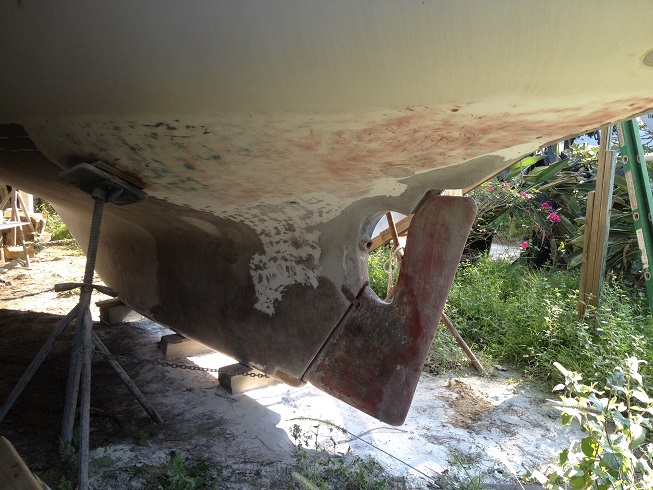

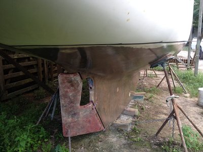

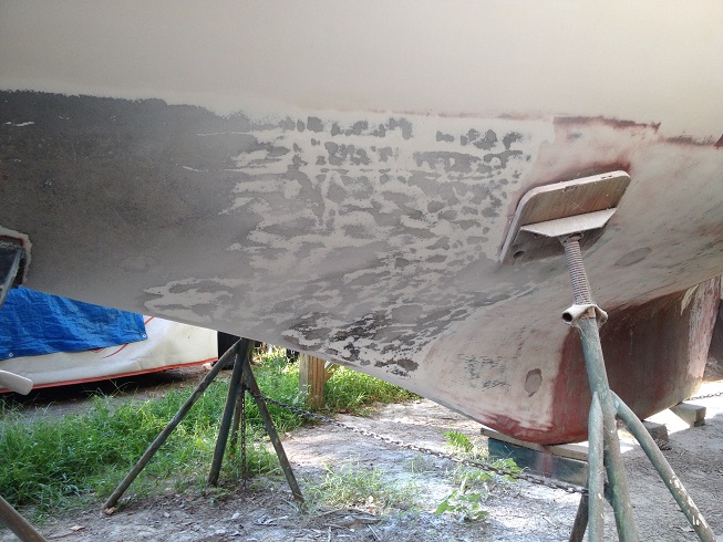

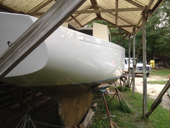

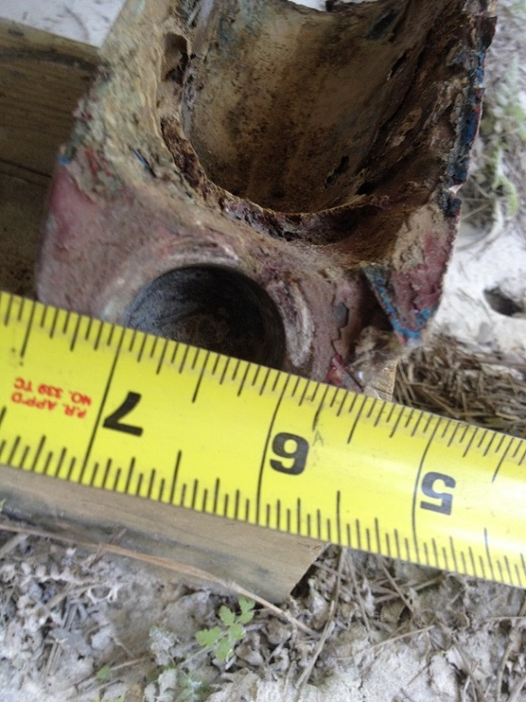

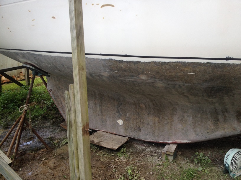

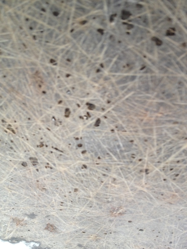

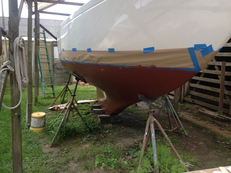

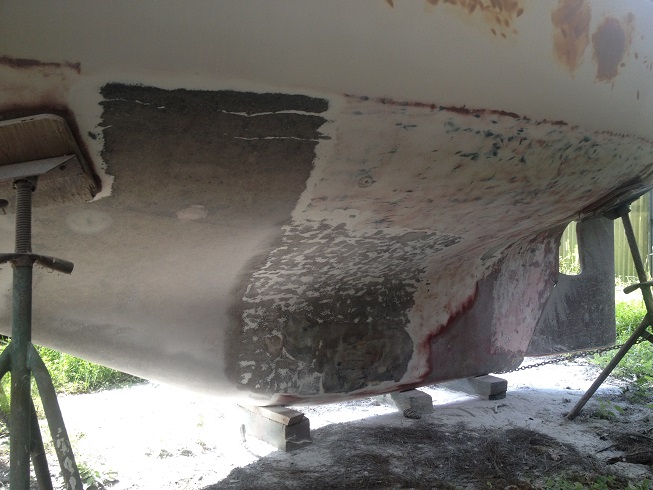

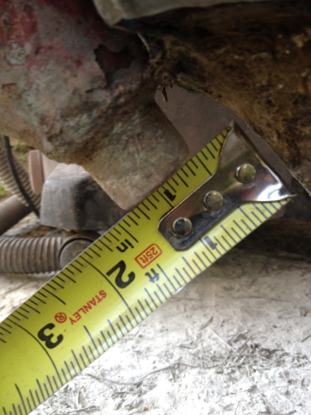

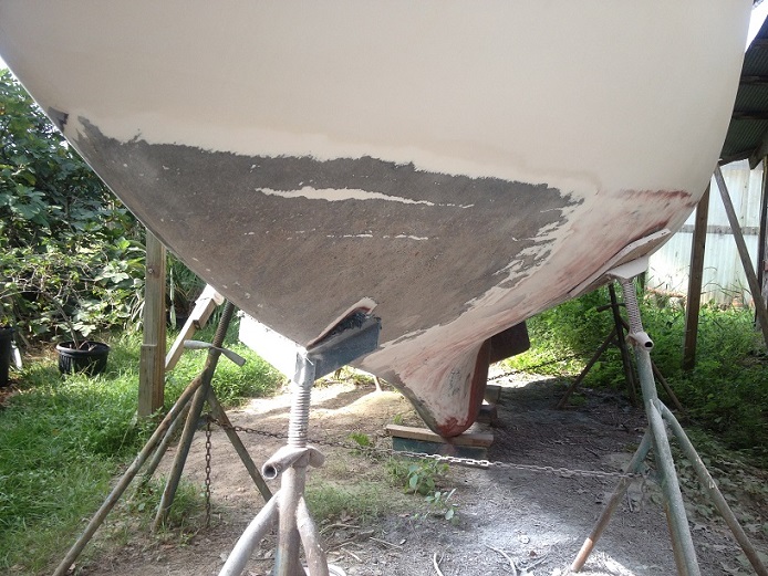

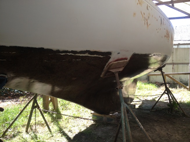

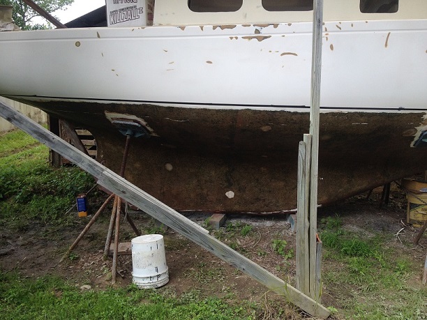

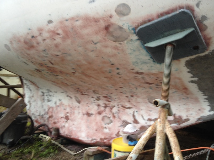

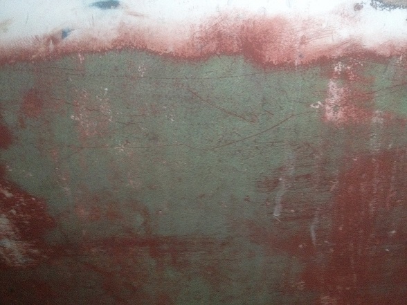

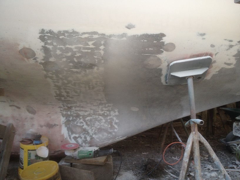

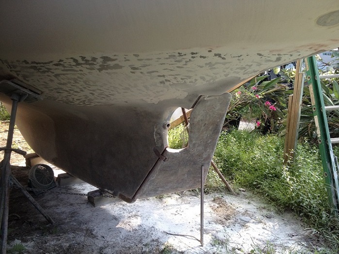

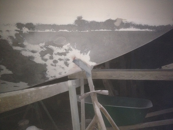

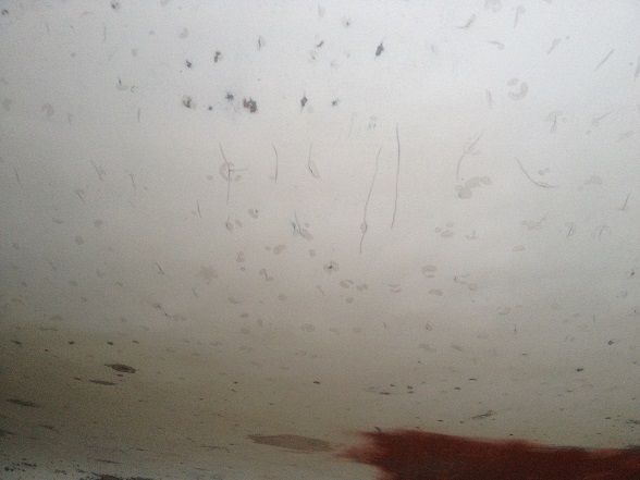

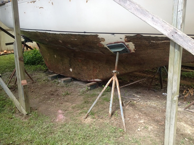

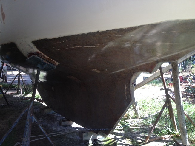

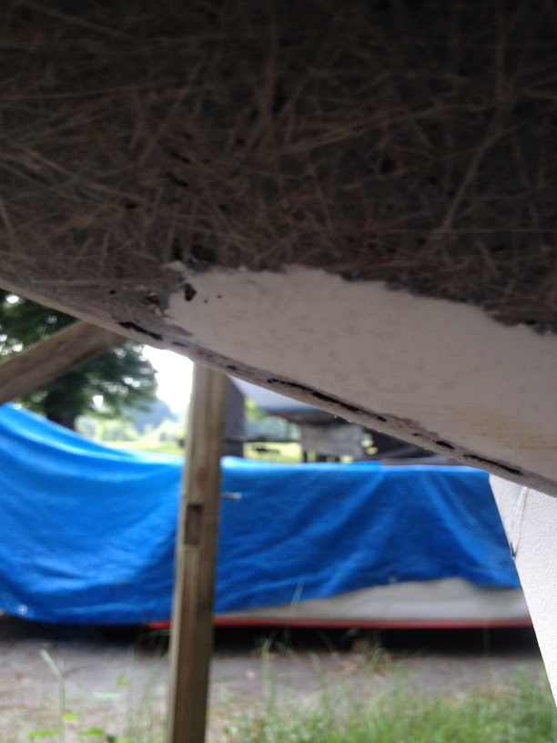

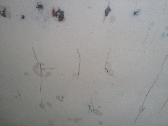

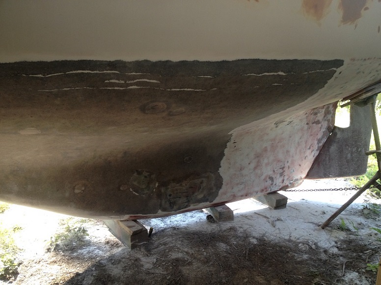

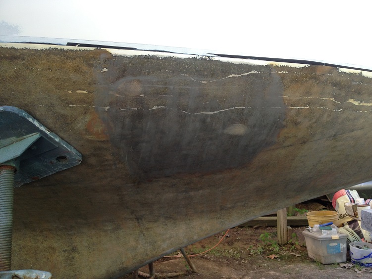

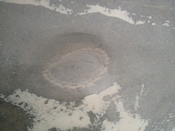

Bad news. I always thought the bottom was in good shape.
I was working on the starboard topsides sanding and decided I needed to get the bottom paint out of the way. So I sanded the top six inches along the water line. I didn't like what I was seeing and sanded a bigger area.
And a close up.

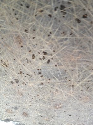

The gel coat is full of blisters and cracks. Oh NO.

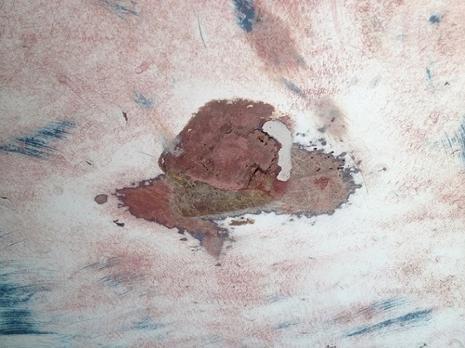

So I tried to sand the gel coat off to see how deep they went.
And what do I find? A big one. About two inches across.
The little blisters do not go into the glass. The big one goes through the first and second layers of glass, as far as I can tell. Sounding some more of the bottom I found a couple more two inch ones. So the question now is, do I take all the gel coat off and then rebuild it back up with an epoxy barrier coat after filling the big holes with some glass?

I've been reading through a few articles on the subject. Two authorities on the subject are David Pascoe, and Jan de Groot. Both of these guys have a lifetime of experience.
Jan: http://www.yachtworld.com/mustangyts/mustangyts_5.html
David: http://www.marinesurvey.com/surveyguide/
http://www.yachtsurvey.com/moreonblisters.html.htm
The general consensus seems to be repair as much as possible and continue on enjoying life. Also, you can consider yourself lucky that a previous owner didn't find the problem and then completely futz everything up with a mess of bad repairs. Even adding barrier coat is controversial; considering that laminate water intrusion is very likely to also be coming from inside the boat.
Here is a link to the West System blister repair guide. http://www.westsystem.com/ss/repairing- ... -blisters/

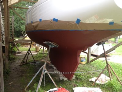

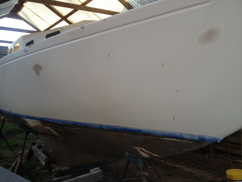

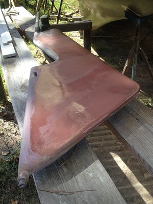

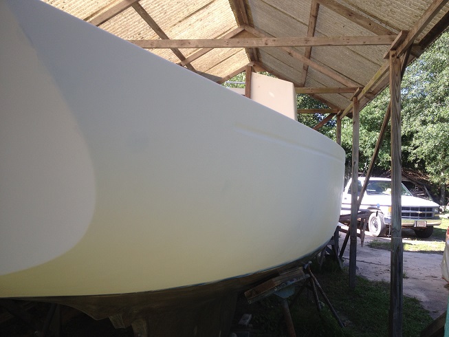

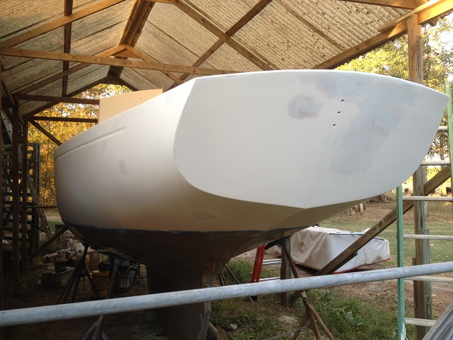

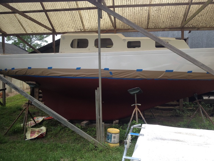

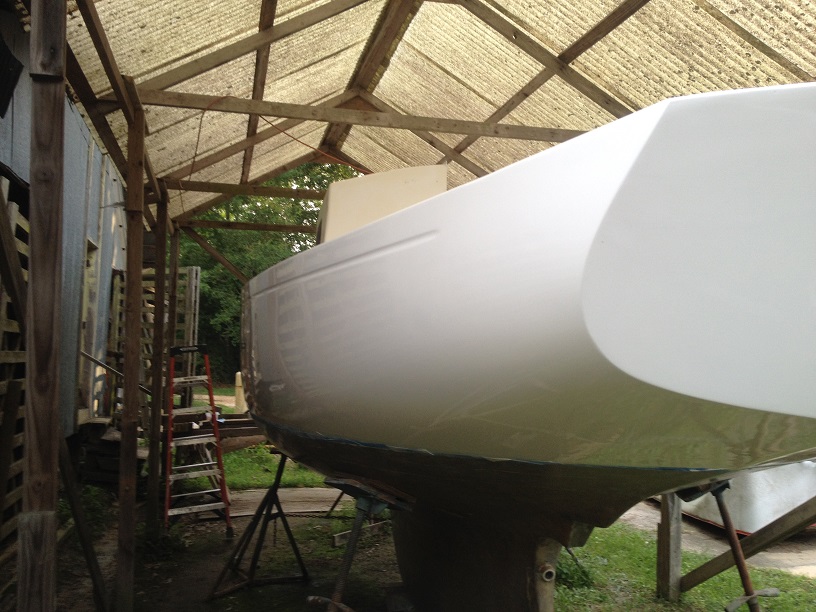

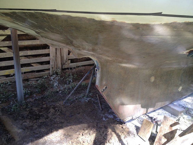

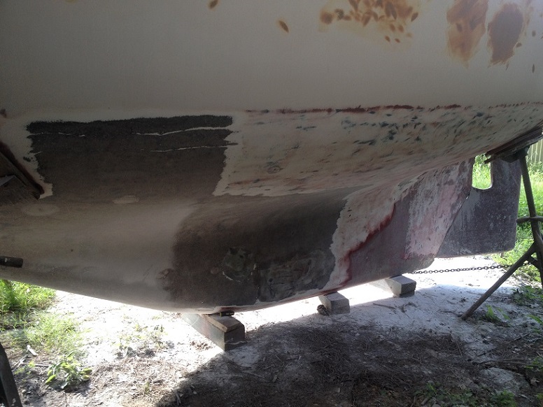

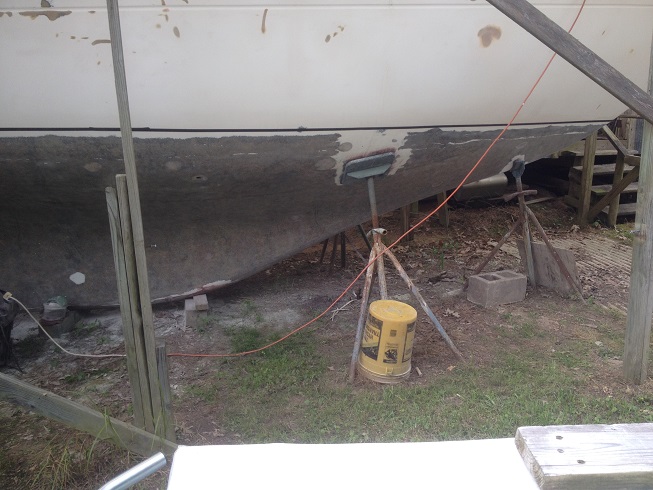

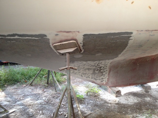

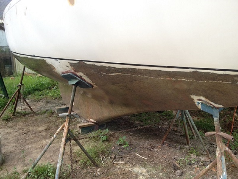

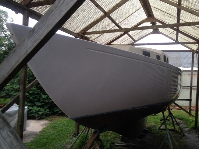

Slowly sanding gelcoat off. I have gotten the starboard side mostly done. Have not gotten under the stands yet. Figure I will move the stands after I finish redoing the rest of the area. Have not figured out how to get under the keel and keel blocks. Might end up skipping that area.
Next up is to coat with epoxy, patch holes, fill/fair all the little holes, sand it all smooth, then build up layers of epoxy.
Then start the port side.
Sounds easy enough. Yea right.
I was so hoping to paint the topsides and deck this Summer. Guess that will happen next year if I am lucky.

Post by Lloyd »

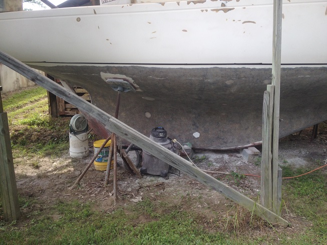

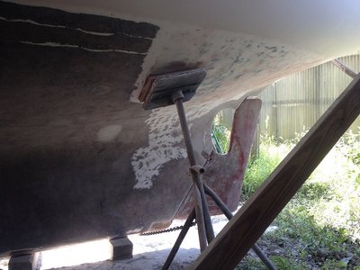

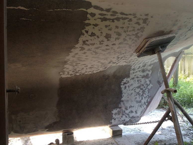

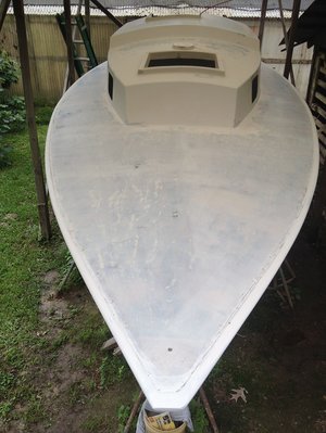

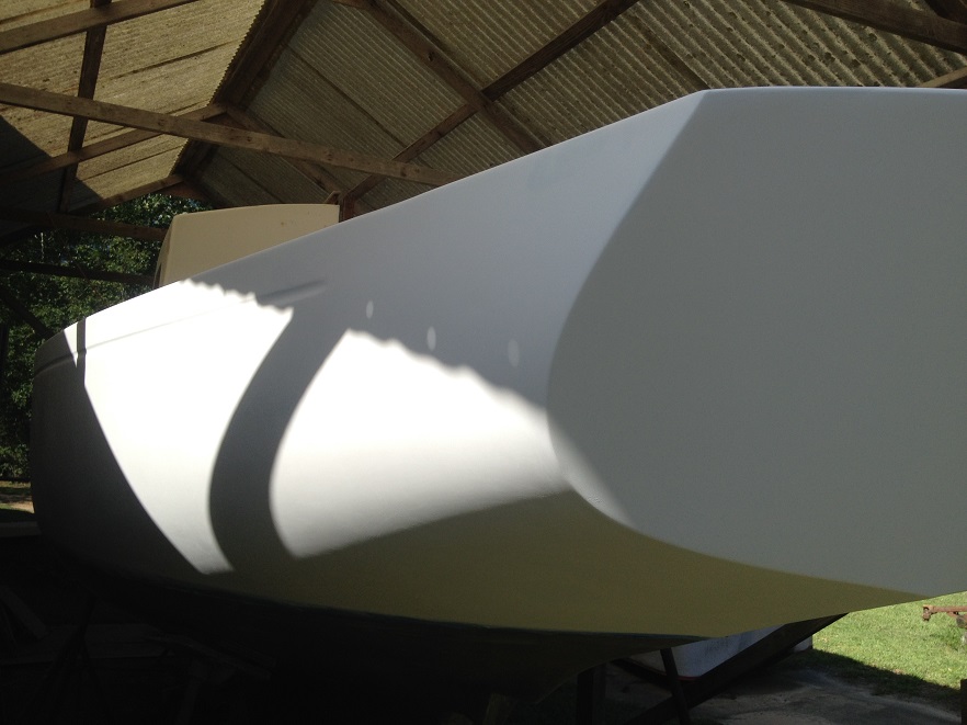

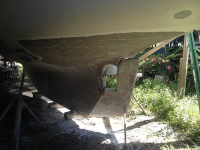

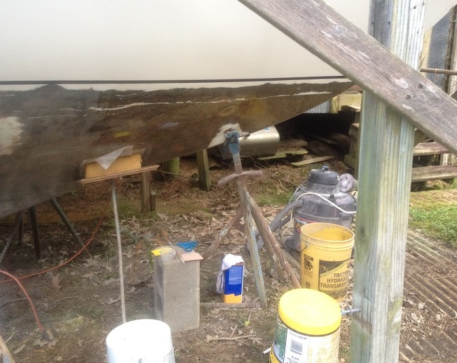

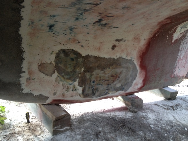

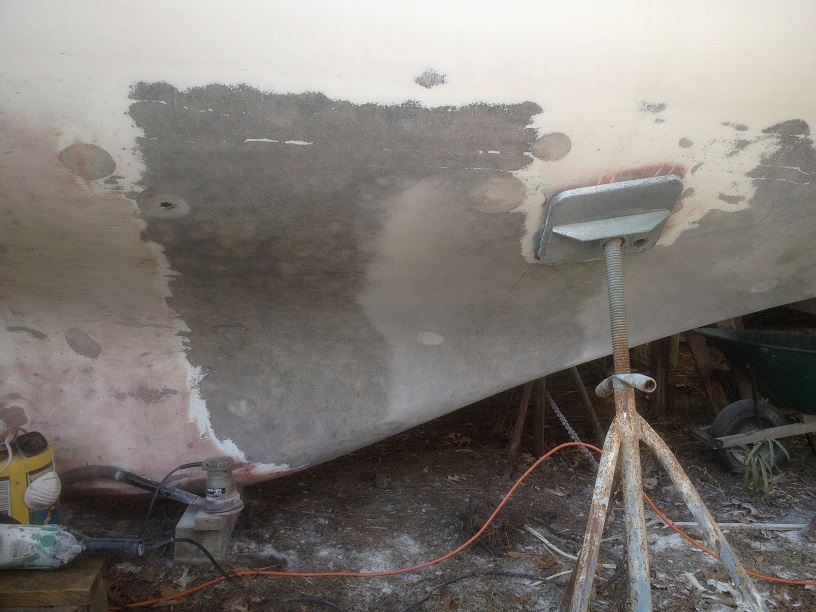

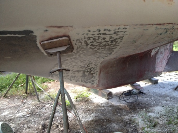

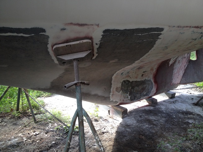

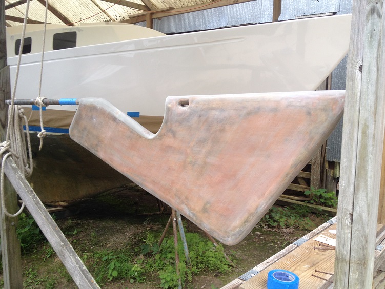

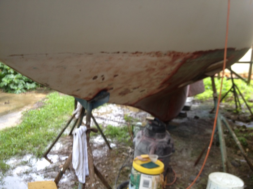

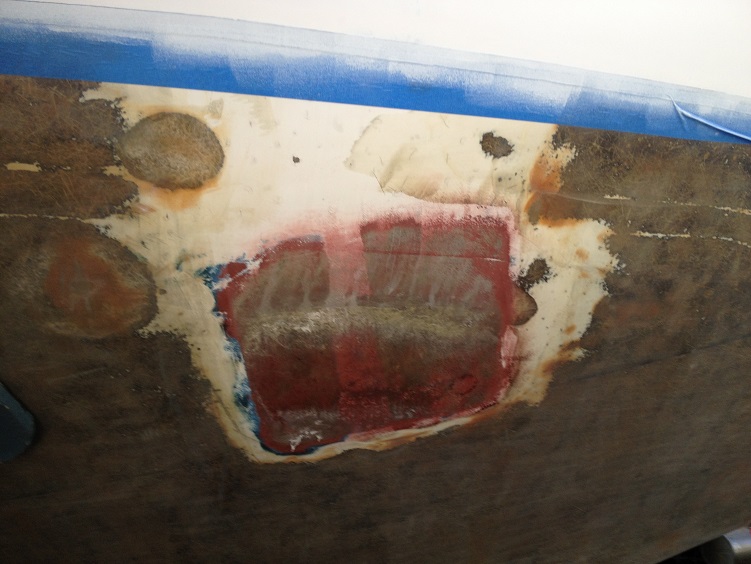

Some more pictures of the work.
Bottom paint sanded off.
Gelcoat ground off.

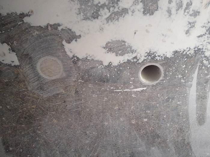

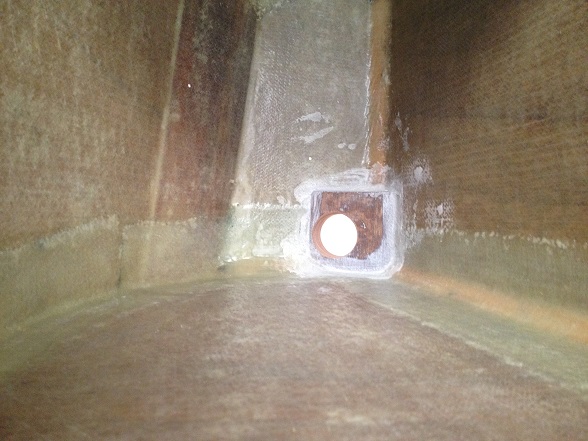

Then sanded smooth. The hole in the picture is where the glass was bad all the way through the hull.
Starboard side sanding done.

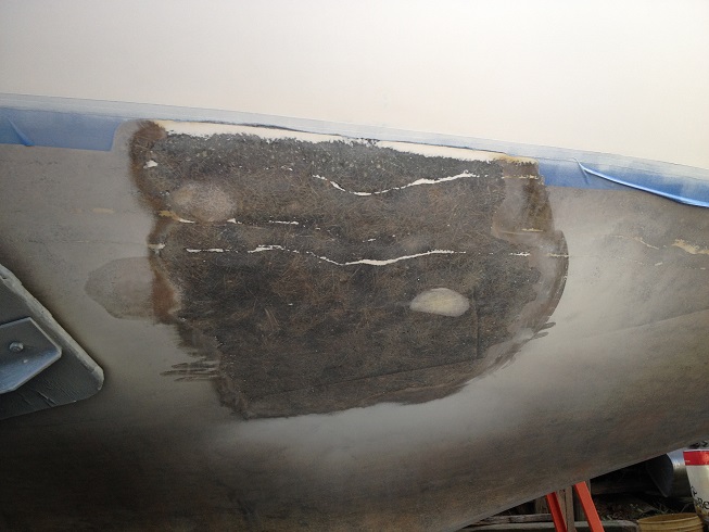

After cleaning the dust off and acetone wiped the first coat of epoxy is put on.
Then a coat of epoxy filler over all of it.
Holes being patched with epoxy/cloth.
Also started sanding the bottom paint off the port side. Rain was blowing in on the starboard side so I moved around to the port side and continued working.

Post by Lloyd »
Back on the starboard side I used epoxy filler on some spots this past week.
I water washed/scrubbed the spots then sanded them.
This morning I vacuumed, then acetone wiped the starboard side bottom.
Then I gave it three coats of epoxy.
Next up is water wash/scrub the epoxy then give it all a light sanding. I hope I do not find anymore places that need filler. Then start the epoxy with aluminum power for the outer coats.

Small interior projects. I cut out a bottom shelf for the ice box and a couple of cleats to hold it up. Coated them with three coats of epoxy to seal them up. Also got the cleats epoxied into place.
Trimmed the head plywood base to allow a space for the thru hull on the left hand end of it. Also gave it three coats of epoxy.

Ok, I took a few pictures.
First one is a shot from the front of the new bottom.
Then a shot from the back of the new bottom.
Cleats being epoxied into place in the ice box.
Then the cleats showing the drain under them. The drain is not epoxied in yet.
New shelf in place in the ice box.

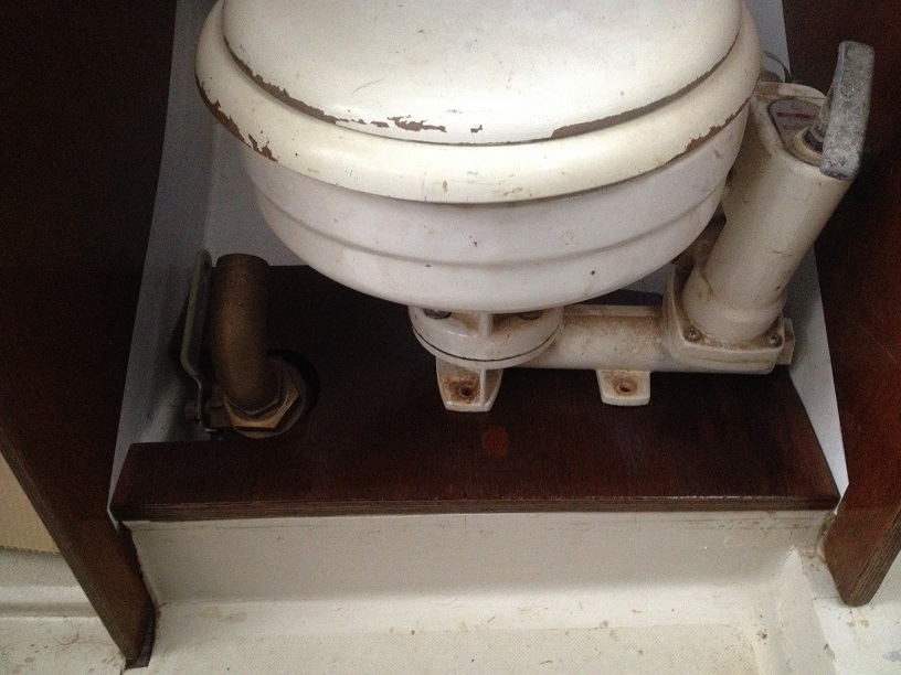

The head base laid in place.
And with the head sitting on the base.
Also started grinding/sanding on the port side bottom.
Picture of the voids I find under the gel coat (dark spots).
And a void along the leading edge, port side (long dark spots).
And that's it for now.

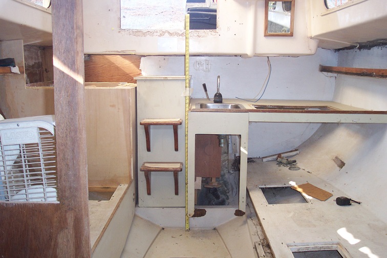

Ok here we go. Building the ice box which was back in 2002/2003, I think.
First shot is how it was. The old box was side loading with a hatch from the cockpit. It had space under it for your feet laying in the bunk. It had a nice liner that I couldn't use. Very poor insulation.
So I ripped it out.
Cut the end of the bunk to fit it in down to the hull.
Fitted in the plywood sides.
Added in cleats around the top.
Then put in two layers of 2" foam. After that I put in 1/4" plywood to cover the foam. Covered the plywood with a layer of biaxial cloth. Faired that out and sealed it up with a couple coats of epoxy.
New box.
And a shot as it is now.

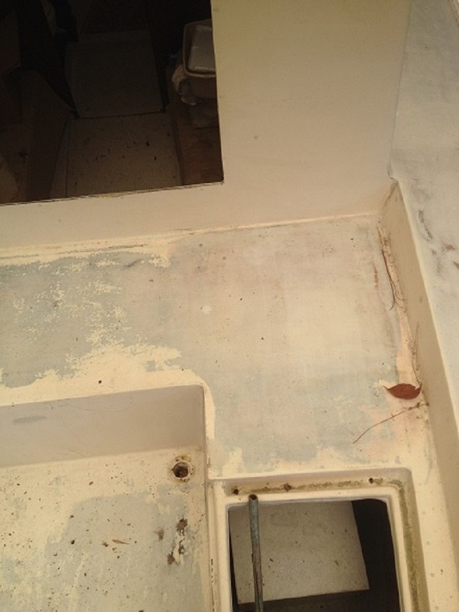

Taking out the cockpit ice box hatch and closing it in. Back I 2002/2003.
Laid in a layer of glass for the new inside surface.
Put in a layer of balsa.
Put a couple layers of glass, then faired it out. What it looks like now.

As for work done this weekend;
Some grinding and sanding on Saturday.
And then some more grinding and sanding on Sunday also.
Posts: 188
Re: Bristol 27
Post by Lloyd »
And a little more of the same stuff, grinding and sanding.
And I found an old patch job when I sanded the bottom paint off. You can see it in this picture. The gel coat was already gone and I could see where patches with cloth had been made. I sounded out the patches and about half of the area didn't sound good. It sounded like it wasn't adhered to the lead behind it. I will leave it for now and decide after I have finished getting all the gel coat off on this side if I will grind it all out and redo it. We will see.
Posts: 188
Re: Bristol 27
Post by Lloyd »
More of the disappearing bottom gel coat.
So the grinding is done and a couple more hours of sanding and I'll have it done.
Then I found this old bad patch.
It is about ten inches to the front of the port cockpit drain tube. Ground it out and it looks like an old filled in drain tube.
It will get glassed over with the rest of the bad spots I've found on this side of the port bottom.
I will be glad to be done with the grinding/sanding on the bottom. It is a killer on the arms.

Re: Bristol 27
Post by Lloyd »

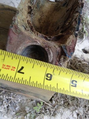

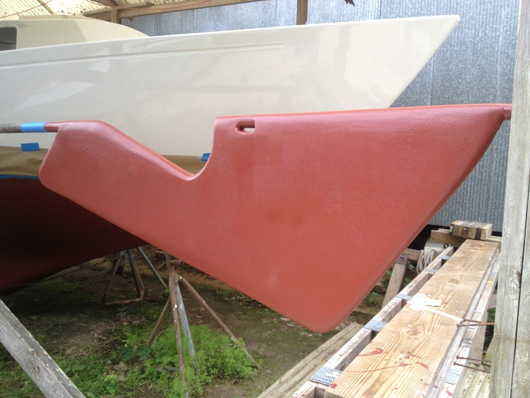

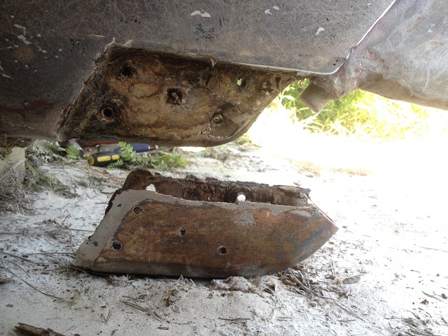

So I sanded off the bottom paint on one side of the rudder. It is very rough and appears to be not very smooth/flat. Did these boats come with wood rudders? It looks like someone put a layer of glass cloth on it and then didn't fair it out. I decided to pull the rudder off so I could work on it. First step was to take the foot/shoe off. The bolts came out easily and with a tap or two the shoe came off.
One side of the shoe the bolt holes are recessed for flat head bolts and the other side the holes are threaded.
The rudder had some slop fitting in the shoe. The rudder pin is about 7/8".
And the shoe has a hole of about 1". So I might need to fit a bushing in the shoe to get rid of the slop.
The next step on getting the rudder out is to take apart the stuffing box on the rudder shaft.
And the big news is that I got through sanding off the gel coat off the port side bottom.
Next up is putting epoxy/glass in the bad places that I ground out, then sanding them smooth. Then start the epoxy coating on the port side bottom. Also get the rudder off so I can work on it.

I got the rudder off so I could work on it.
I sounded the rudder, by tapping on it. I figured out where the glass skin was detached from the interior wood and drilled holes in it. I put epoxy in them and let it soak in.
That then left small holes to fill in. I resounded it, added a few more holes, more epoxy. I kept doing that until it sounded good. Both side were done the same way.
I then built up the rudder (on both sides) with epoxy filler to smooth it out. It had hollows and high spots to start with. I just kept adding filler and sanding, until it was smooth. Sealed it with epoxy, 2-3 coats of epoxy with alum. powder, 2-3 coats epoxy and done. Sorry no picture of the finished rudder. I still have to bottom paint it and rehang it.

So I got the bottom reworked. Sealed it first with a coat of epoxy, then a coat of epoxy filler. Sanded it smooth then another coat of epoxy, 2-3 coats of epoxy with alum. power and then finished it with 2-3 coats epoxy.
After I got both sides done I moved the jack stands and did the same to those spots.
Stands moved.
Bottom paint and gel coat sanded off.
And all finished up.
I still have to put a coat of bottom paint on, to cover it all up.
If you notice in the last three pictures there's tape on the water line. I was working on the topsides also.

I finally gave up filling holes and such and put a coat of primer on.
All that did was make more holes and such show up. Did some more filling and sanding then more primer.
I lost count of how may coats of primer I put on. Sanding, primer, sanding, primer, seems like that's all I did for a long time. But now I think the topsides are ready for paint. I wish it was perfect but it will have to do.
While I was working on the topsides I also got these pieces primed and ready for paint.
I decided to try the paint on these pieces first to try it out.
So I rolled and tipped one coat of paint on. Got some orange peel. I gave them a light sanding with 320 grit paper. Then rolled and tipped a second coat on. That came out great except some dust and bugs, which I will have to live with. Doing it outside that's what you get. But I'm very happy with them.

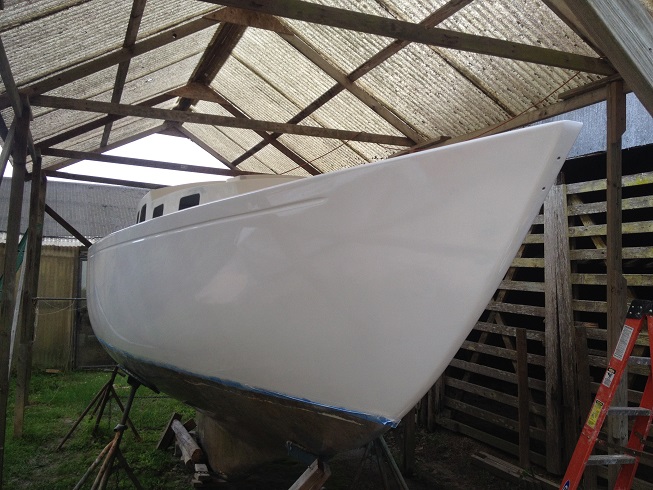

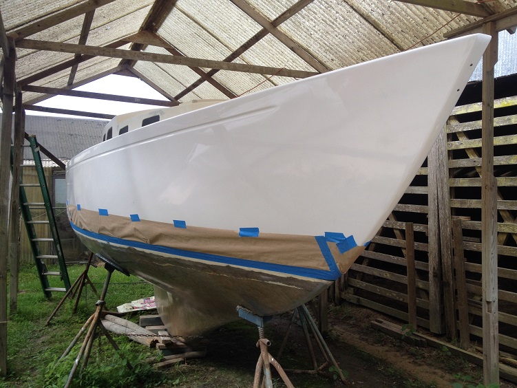

So it's Topside paint time.
I put two coats on. Roll and tip.I think the first looked better than the second coat. Ended up with more brush marks on the second coat. It is very shiny, which shows every spot that I tried to fix. Every spot. Oh well, it's done.

Post by Lloyd »

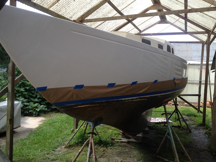

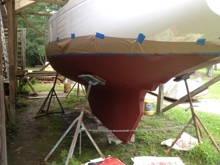

Then the following weekend it was bottom paint time.
Masking off.
I got one coat of bottom paint on.
And not to forget the rudder.
Before bottom paint.
And after.
I used about half a gallon. Thought I would use up the bottom paint with a second coat but the rains set in. I'll try to get it one day after work this week. I hope.
