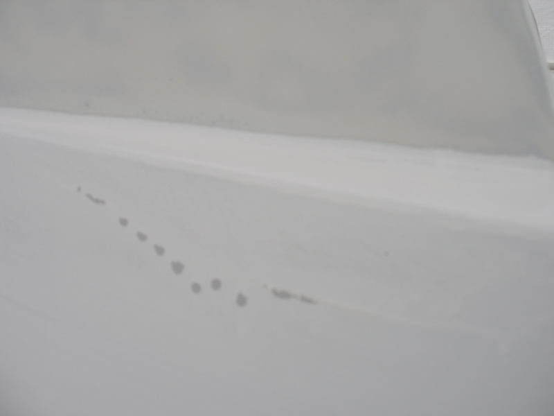

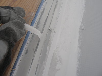

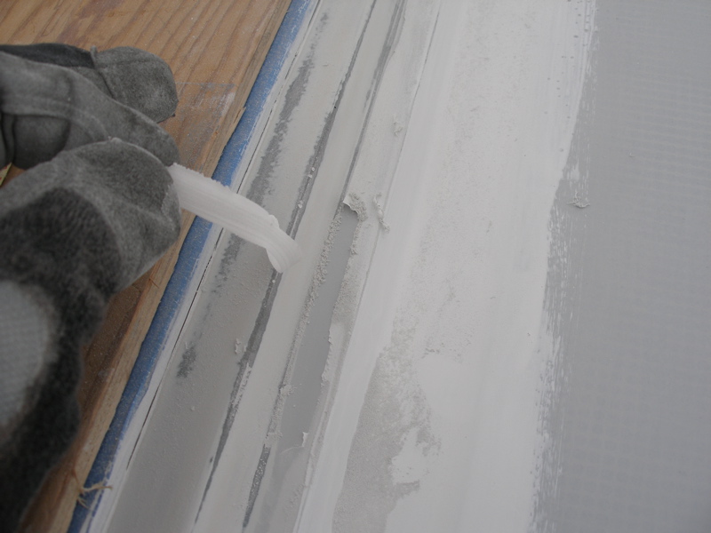

OK, I think I have figured out what happened with the paint.
First, I had trouble with the first coat running a little bit. It collected in some of the corners a little thicker than other areas.
Second, I must not have waited quite long enough (over 16 hours later!) to recoat. the thicker areas must have retained a little moisture (this is a water based product).
So I figure I trapped some moisture under the second coat, which could not escape, and prevented adhesion to the primer. According to the S3 tech folks, the topcoat develops sheet strength before it develops adhesive strength, so once it started pulling up, it brought more with it.

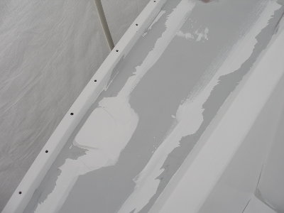

First Photo- Here is what the peeled areas looked like (this peeled one week after paint was applied). Note that I left the center area bare for non-skid paint. Second Photo (sorry its blurred)- Some drips that I sanded off yesterday (2 weeks after painting). Notice the lack of adhesion under them, but not the surrounding areas. Third Photo- This is paint being removed 2 weeks after it was put on. This area was under the heater. It should have cured by now. But its still peeling. Based on the last 2 photos, I can't trust the paint to stay on for very long. So I spent yesterday sanding it off. Only got about a third of the boat done, and that was the easy part (bow area and cabin top). In areas where it cured properly its hard. Very hard. Which is now most of the boat. I figure about 10 percent of the boat peeled, and I removed that part easily. Its the other 90% that's going to take awhile...
Dust, dust, dust. Again.

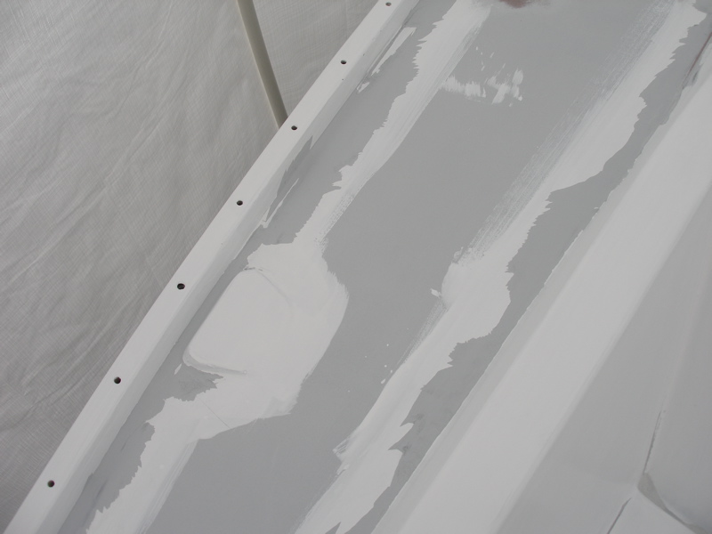

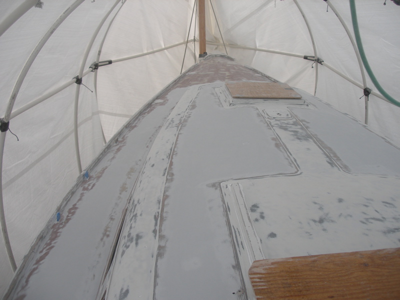

Thanks for the old thread Britton. I do take comfort that I am not the only one who has been through this!

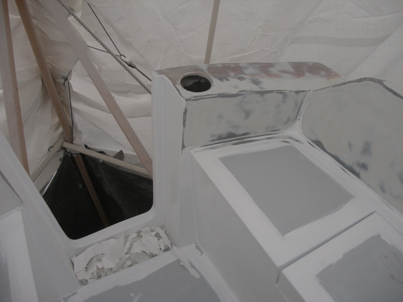

Spent 9 hours behind various sanding implements today. Ugh. Got most of it done, except for the lower part of the cockpit and the detail work around the companionway. The boat has the familiar spotted look again! The good news is that I have sanded some areas that should have been touched up prior to painting a bit more. So the end result should be better the second go around.
I should finish the sanding next weekend. I'm actually debating whether to have the yard spray the topcoat, since I am going to have ever more difficulty getting the temps stable enough. The yard has an indoor area they can maintain at a steady temp. And the boat is on a trailer. It would be some effort to remove the cover, but perhaps well worth it. I'll be inquiring about pricing this week and see if they even can schedule it in in. If not, I'll press ahead and hope for the best.
I'll sand it all up to 150 before re-priming. I'm going to leave the existing epoxy primer on the non-skid areas, since its rock solid. I'll prime over everything with whatever primer system I end up using..
Here are a couple photos.

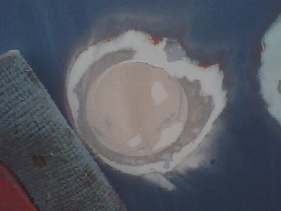

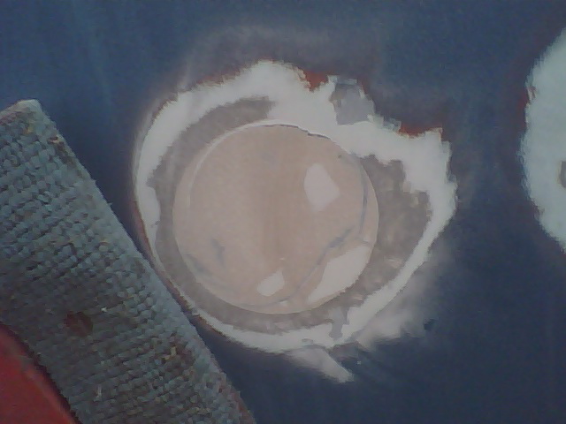

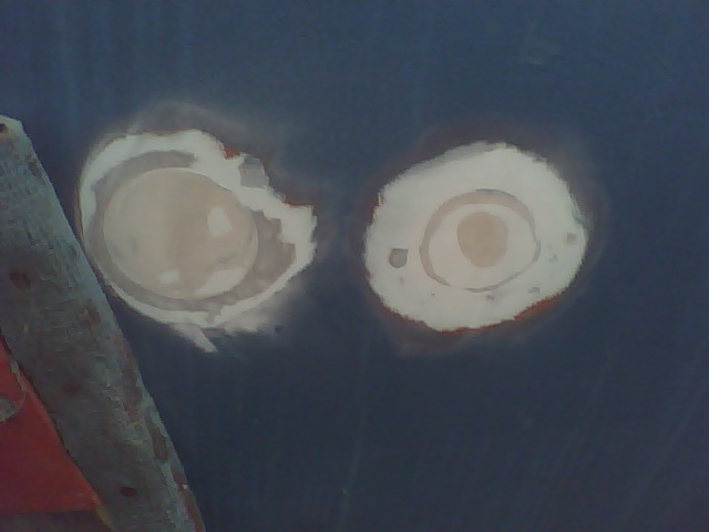

I spent the day filling in the old raw water intake thru hull hole. It was recessed into the hull so I scraped all the sealant out, sanded it down and put in a bunch of layers of 1708. I'll add a few layers over the inside when its cured. I also continued filling in the 4x4 inch hole where I had removed the strut. I had previously put in a block of white oak and filled it up with a mix of epoxy and colloidal silica and milled fiberglass. However I didn't put enough in and there was a large void, so I repeated the process. When this is cured I will put a 3 layers of 1708 on the hull side and two inside. I also cut off the end of the plug which I had placed in the old shaft log and epoxied in place. The outside will get 3 layers of 1708 and another two on the inside. I ended up using 4 pieces of 1/2 inch fiberglass fence post to fill the shaft log.

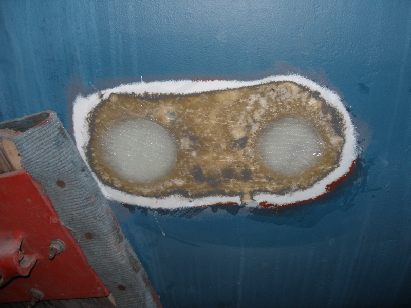

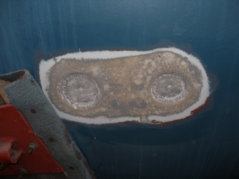

I also made an unfortunate (or fortunate if I think about it) discovery. I had noticed several circular cracks in the hull paint on the starboard forward side about 2 feet below the waterline. I suspected this was a poorly done repair of an old thru-hull from the head. Sure enough someone had put some kind of putty (probably thickened epoxy) into not one, but two thru hull holes and then gelcoated over them. No fiberglass cloth. Failure waiting to happen! I'll have to dig out this junk and see if someone actually put glass on the interior (which may be why I couldn't find anything on the inside of the boat. Access is poor from inside the boat, so this will be a major exterior grinding job. Ugh. I was hoping that I was getting near to the end of major grinding, but I guess not.
Here is a photo of both thru-hull patches
Here is a closer view. Note the cracks in the filler material and it separating from the edges. I also spoke to our local metalworker today about manufacturing new chainplates and spreader brackets. I have decided to move the chainplates to the outside of the boat. They are currently glassed into the interior of the boat, making inspection and replacement impossible. I'll post more about this later.
Doug
I forgot to bring my camera so I didn't take good photos today. Too late I remembered my cell phone cam, but only got a few lousy pics.
Doug

Mystery solved. What I thought were poorly patched thru-hulls on the starboard bow appear to be the original thru-hull locations for the head, but they were never actually used. When I removed all the filler material, I could see light shining through untouched hull material from the inside. I cleaned them out and put in 6 layers of biax to fill them up. I'll sand them down and fair them to the hull next work day.
Doug

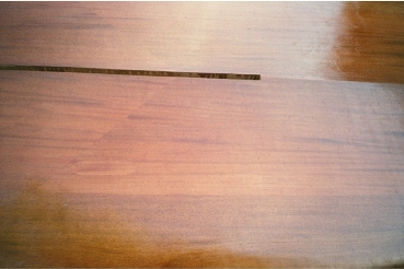

This weekend I worked on the sliding hatch for the companionway and continued pondering the chainplate issue. I also cleaned out some core material that was exposed around the rudder shaft in the cockpit. A little water had gotten in and rotted the balsa out, but it didn't seem to extend much beyond the bolt holes. I filled it with thickened epoxy. There is a layer of 1/4 inch marine plywood that is fine above the balsa core. Just the size of the raised plate area.
As an aside, I have started adding some fine chopped fiberglass into my thickened epoxy to give it more strength. I have found that the areas where I placed epoxy thickened only with colloidal silica are a bit brittle. I have noticed over the past few months some cracking noises when stepping on the foredeck where I had a lot of the thickened epoxy. I hope this will not result in any structural issues. Moot point, cause I'm not digging back into it for any reason! Oh well, a lesson learned for the next boat...
The sliding hatch has involved a lot of trial and error, mostly error. The original hatch was in poor condition and did not fit well, but I thought I could use it as a template with some modifications. I cut the runners from 1" mahogany and dadoed a slot into them. Then I traced the front profile onto my mahogany and made my measured modifications. I measured three times, but when I dry fit it, it was still too short, so I wasted a nice chunk of mahogany. Turns out my measurement was correct, except that I was measuring the wrong area. Argh. After getting smart and using some cheap pine for the complicated pattern, it took two tries to get it right. So once I purchase another chunk of mahogany I should have a good framework. I still have to scribe and construct the false rabbets that I'll install around the interior of the frame. Using the shape of these rabbets, I'll make a form to bend three layers of 6mm marine plywood over to make the top. Since the fitting of the top is going to be a little tricky, I think I'm going to make two of them so when I mess up the first one, I'll be able to quickly correct on the second... Hey isn't half of life trying to work around one's own limitations?
Second try. Note shims made of an old scraper.

Interesting about those two head through-hull recesses. That would have scared me at first too.

I started out the day by fairing the hull patches. I didn't get any photos of them.
I then dry fit the hatch. It fits perfectly so now I can move on to the next step.
I acquired a Yamaha outboard motor a couple months ago. Hi thrust extra long shaft. So today I test fit it to make sure it would fit in the opening I made in the transom last summer. It fit perfectly. Instant propulsion! I'm pretty pleased with how deep the prop will be.
It takes up a lot less cockpit space than I thought it would, both up or down.
I also spent some time grinding and sanding off the paint and dirt from around the inside of the transom. I am going to add a few layers of 1708 in here to reinforce the transom/hull area to provide better support for the motor. The transom hardly moves (in fact its really quite solid) when I flex the motor, but I want this to be bomb proof to handle any extreme loads from the motor when sailing in waves. The holes are for the single cockpit drain. Unfortunately, I can only reach much of this area with one hand while lying on my side, so sanding was a real pain!
When I was moving around in the lazarette, I grabbed the rudder tube and found that it flexed a little more than I would wish. Probably not a big deal, with the rudder also being supported at the cockpit sole, but again, while I'm in there, I may as well beef it up a little. So I sanded this area too. Thanks to the flash, it looks like I have a little more sanding to do.
Finally at the end of the day, I removed some of the teak trim around the companionway. I had heard from other Ericson owners that there is a gap in there that can allow water ingress. So I will be filling this area with thickened epoxy soon.

I spent yesterday getting out a tricky thru-hull, doing a bit of glassing, and sanding some of the fairing compound.
I have tried various weapons over the past few months to get the sink thru-hull out all to no avail. It was installed with a crusty plywood backer, but someone used a nasty bedding compound so it was in there to stay. During yesterdays particularly vigorous session I noticed the hull flexing and decided that I would just cut the danged thing out before I caused alot of damage. By then I had bashed the threads in anyways so the thru-hull was unsalvageable.
I also glassed two layers of scrap biax to the transom to reinforce the area underneath the motor cutout. Likely unnecessary, but I like solid things. I'll cut the cockpit drain hole out later. This was lots of fun because I can only reach this area with one hand. I spent quite awhile afterwards cleaning epoxy from various surfaces, clothing, and skin. I have no hair left on a large portion of my right arm!
And I tried to reinforce the rudder tube. We'll see how well this worked. Its extraordinarily hard to get biax to lay where you want it to at the bottom of a tube like this and get all the airbubbles out. I'm sure I missed some, but hopefully it will have provided an extra margin of reinforcement.
Chris sorry to hear about your delays. I would count myself lucky to have the boat in the water by summer, given my current 6 hours a week of time actually spent at the boat (a little more time available at the shop in my basement). I had some extra motivation to get it done yesterday with sunny skies, temp around 65 and a perfect east wind at about 12-15!

Hatch is FINALLY almost ready for finishing! Unfortunately, I made a horrible amateur mistake that almost caused me to trash the whole thing. One of many in this whole endeavor.
The hatch top radius was a little lower than the frame, so when I glued it together I needed to trim about 1/4 inch off. I set up my trusty router table and started off. The first two sides went off clean as a whistle. But in the middle of the third side, the bearing decided to seize. It burned a small hole in the top skin of the plywood. But that wasn't the mistake...
No, the mistake came when I tried to sand the remaining portions off. I wasn't feeling well that night, which was my first mistake (well, working while not feeling well was the mistake), and when sanding the last corner I wasn't paying as much attention as I should have been, and sanded a big hole in the top skin of plywood. Arrgh! So basically I ruined the entire assembly. Monumental stupidity!
Here is a photo showing the damage.
I did add 4 large screws in each corner to reinforce the entire assembly.
Here is the entire thing with the first coat of epoxy.
And the offending blotch. I put a little wood filler over it to try and hide it. Short of staining it black or painting it, it is always going to show.
After thinking about it for a few days, I figured that there is really no sense in me spending another month and $$ doing this project over, so I will enjoy this little reminder of a stupid error for as long as the hatch lasts. I have enough other things to do and $$ to spend!

Quetzal/Doug I took your advice and cut a neat line to eliminate the ragged edge. Worked great. I cut some mahogany triangles to fit and glued them in with some epoxy thickened slightly with wood flour. It should look pretty good! Assuming that is that I don't burn through again when sanding them flush. I'll sand them tomorrow and see how it looks. Two coats of epoxy and I'll be back on track with only 4-5 days missed.

Be careful sanding those flush! That's always the trick.
But the accents will look good when complete.

Rather than sanding the accents smooth, how about leaving them proud and adding a very small chamfer? Or a roundover, but I don't think that would look as nice.
Did something similiar to some kitchen cabinets Iseveral years ago and looked great. Also, would give something to slightly grab hold of when pushing/pushing hatch?

Just wondering. How did you cut that clean line without taking everything apart. An exacto and/or chisel? Fein?

Hi Marshall. I used a utility knife to score the plywood and dug it out with a small chisel. I sanded the wood flush before I saw your post about leaving it raised a bit. That would have been interesting.
Anyway, its sanded flush and I did a final test fit on the boat today. Now I can finish it with varnish.
I also removed some companionway trim and filled the gap between the liner and the deck with thickened epoxy. This should help keep water out of the interior.
At the end of the day I removed the top portion of the rudder packing seal. Its kind of a strange deal, tensioned by 4 screws that thread somewhat loosely into the tube portion of the seal. I could loosen them by hand and there does not appear to be any method of keeping them from coming unscrewed from vibrations and loosing the compression on the packing. I will probably use some kind of loctite to make them hold position a little better. I could also get longer screws and use a lock nut.

I installed the cockpit drain today. I took Ray's advice and glassed a piece of G10 fiberglass tube between the cockpit floor and the hull. I used 1.5" ID tube (1 7/8 OD), because that was the size of the existing hole in the cockpit. I needed about 8 inches and I had to buy 39 inches worth ($$) from McMaster Carr. If anyone wants to buy some tubing, let me know!
I had to redrill the hull side because it was too small. Luckily I had glassed over the hole on the inside which gave the pilot drill bit something to grab. The McMaster-Carr holesaw took all of about 10 seconds to blast through the hull. Nice tool.
I mixed up some thickened epoxy and tried to fillet around the tube (remember I can only reach this area with one hand). It was pretty ugly, so when it started to firm up I put a bunch of layers of fiberglass tape around it so I could mold it a little bit. I'll go back in a few days and run a bunch of 1708 around the whole thing and it should be bombproof. As Ray mentioned, there is not much room for movement or flex in this area, so I am not too concerned about the tube working free.
Here are some photos:
Cockpit aft. I figure I don't need too much drainage capacity since any major fillings will go over the outboard cutout pretty quickly. Hopefully it won't drown the motor on the way in or out...
Drilling the hull side to match the cockpit drain. I had to file a bunch more away to get good fit.
The fiberglass tube cut a little proud. I will sand it flush when its cured.
The messy fillet job.
All wrapped up. Yes, there is a void on the left top side of the tube. Nothing I could do to work it out, so it stays. Maybe I'll drill a small hole and inject epoxy later when I'm putting the biax in. Or not.
In other news, over the past couple weeks I only spent a little time at the boat. Skiing and family illnesses cut short my time. I did manage to remove the trim from around the front hatch. I also laid out the trim pieces from the front hatch and companionway on a piece of teak and will cut them out and shape them over the next few weeks. And I put the fourth coat of varnish on the companionway hatch today. I also made templates for backing plates for most of the hardware (some still to be determined) and will start cutting those out and installing.
I am also in touch with a rigger in Seattle who I hope will be down in the next few weeks to inspect the mast and rigging, and provide some advice on the glassed-in chainplates. Replacing the chainplates will be the last major bit of glasswork on the boat, and then I can think about painting again...
Doug

Doug, very nice job on the drain tube! Here is an excerpt from Allan Vaitses' "The Fiberglass Boat Repair Manual" on how to repair/strengthen the rudder tube. It's similar to what you are doing with the drain tube.

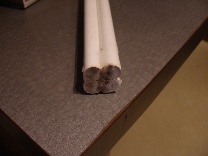

Toxic Pipe... The invoice from McMaster Carr said the tube contained some kind of toxic product known in California to cause cancer.
It sure looked like it had a radioactive glow to it! Note drill-hole in top where I injected epoxy.
I also got the right sized thru-hull and adaptor plate (after a mis-measurement and receiving the wrong size), so I measured to see how much of the thru-hull I'll have to cut off. I'll be using two 1/2 thick pads of G10. I'm going to install the adaptor using bolts tapped into the pads, and I want to tap them pretty deep. Sorry for the bad photo.
Here's a couple photos
