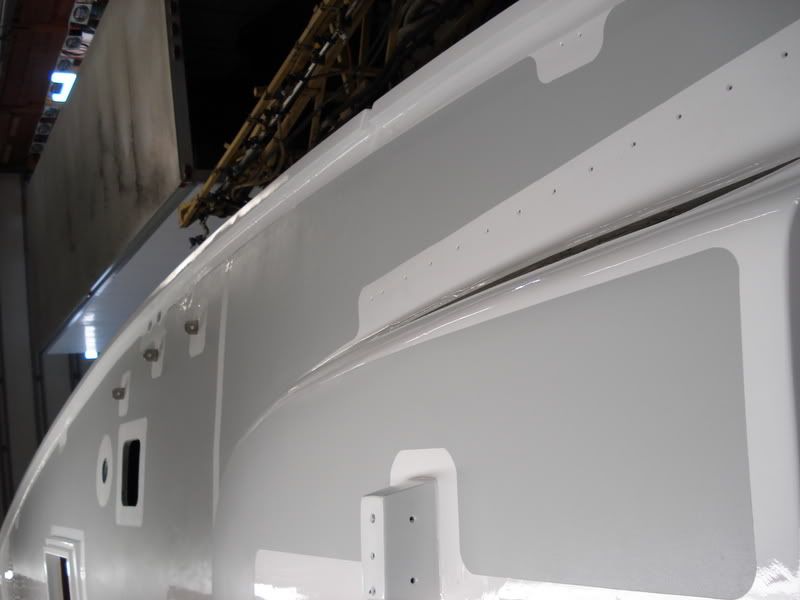

We are at the point of doing the non-skid paint on our decks we are going to use Interdeck from interlux. I mixed up the custom color of 2 parts white and 1 part gray. From reading on the can it says that recoating in around 24hrs, but can't walk on it for 4 days? does this mean I have to do one half the boat at a time? Do I thin the paint at all? and what kind of roller do i use to apply the paint. Thanks.

Scott, I think you are going to love the color. I arrived at the two parts white after several false starts, so I am glad you were able to benefit from my blunderings (this place is great for that, a true wealth of info).
I would encourage you to mix enough to do a single coat of the entire boat or simply mix it all at once if storage is not an issue.
Any thinner will change the color a little, so get a single coat on the boat each time. We walked barefoot on it the following day with no problems.

Wow -- that looks great!
I understand what you're saying about that color getting too hot in Texas, Charlie, but that's the exact shade I wish Interdeck would come in for those of us who think 75? is a nice summer day :-) The really dark grey seems more like a workboat color, but I can't imagine that workboat people are rolling on Interdeck...

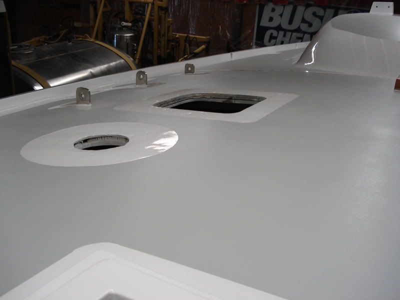

Nice masking job, rounded corners sure add pzazz.
