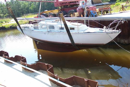

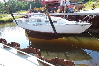

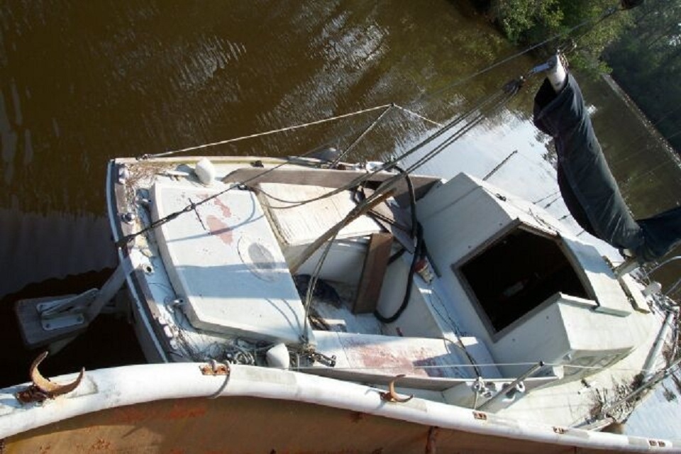

This is my Bristol 27 coming out of the water the day I bought her waaaaaaaaay back in 2002. Not alot has been done to her since then other than stripping her down, until here lately. I finally started working on putting her back together. I'll have more on that later after I get this posting stuff figured out.
I am a new member here although I found Tim's Glissando site back in 2002 and have been lurking here ever since. I guess I need to thank Tim for infecting me with this boat restoration bug. His Glissando site was a wonderful thing to find back then and I have learned a lot from it and this forum. I would like to thank all of you that post here for allowing me to follow along, thus keeping my interest in my project going

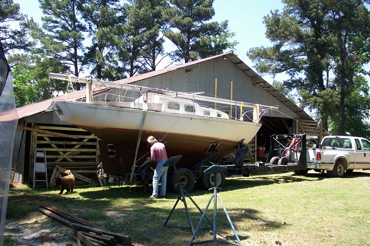

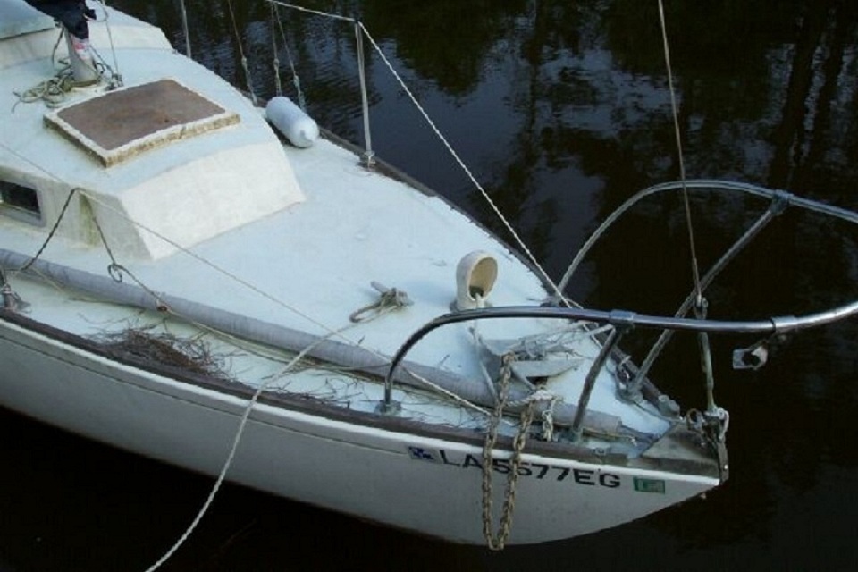

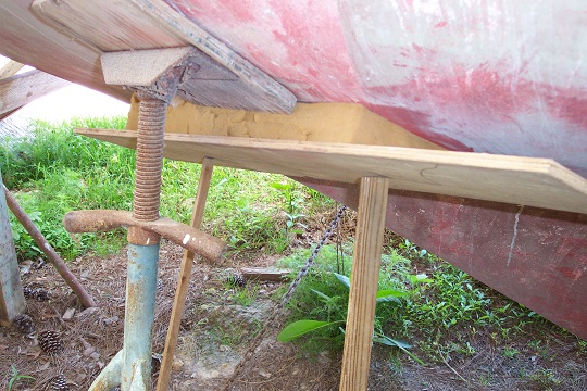

Actualy I bought it from a fellow In Pass Christian Ms. He had gotten it from the Boy Scouts in Louisiana in 1999. And no I had it hauled up to my farm in central Ms.
The boat was a mess.

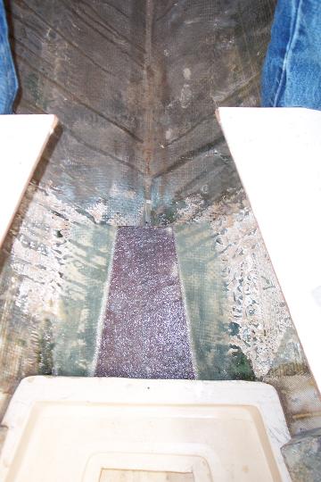

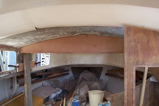

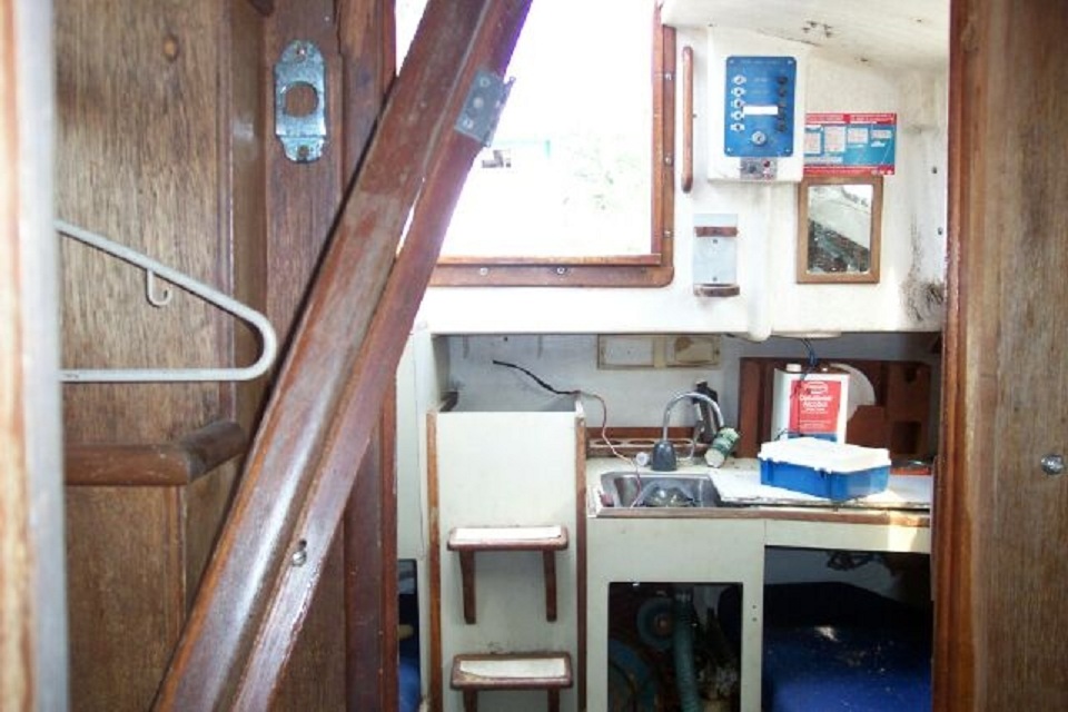

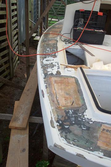

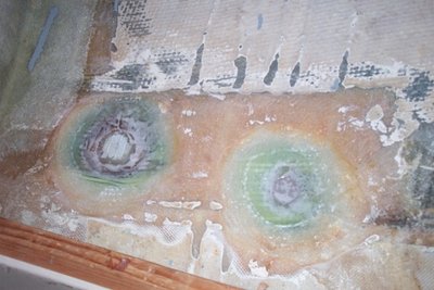

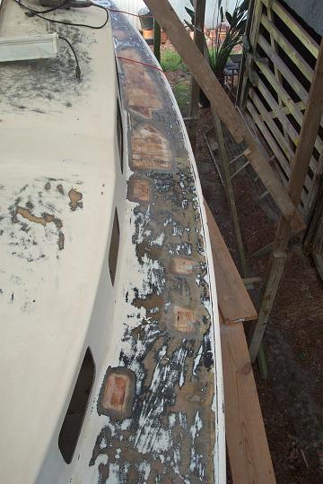

The owner told me a can of starter fluid had leaked in the boat (forepeak) and somehow was ignited causing a small explosion which lifted the foredeck, blew the forward hatch off and pushed the forward bulkheads back.

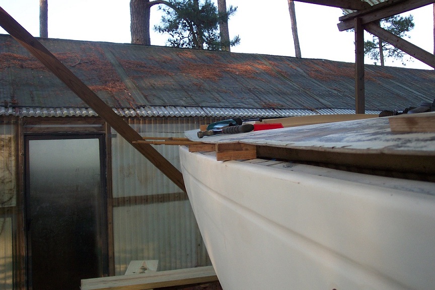

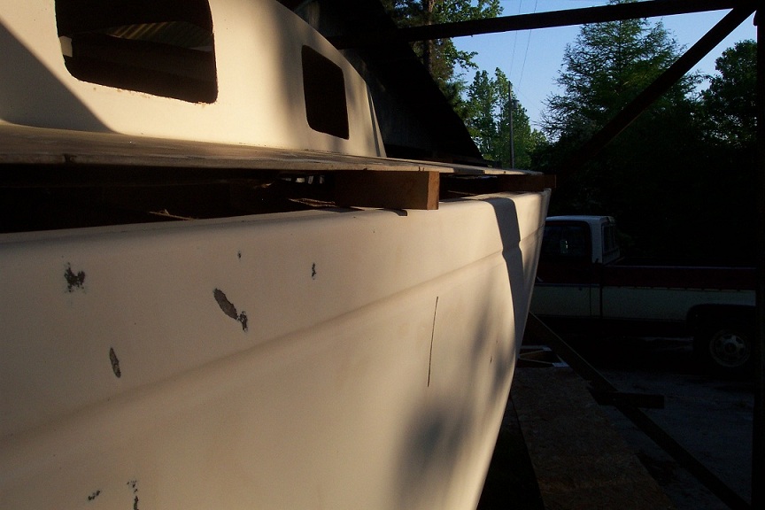

So over a long period of time I unbolted the hull deck joint, cleaned it out and put back toghter with 5200 rebolting it.
I am in the process of taking the bulkheads out and replaceing them.

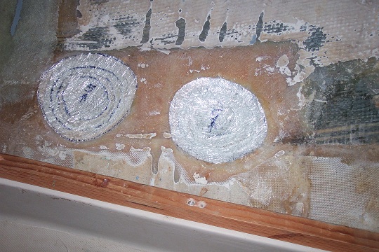

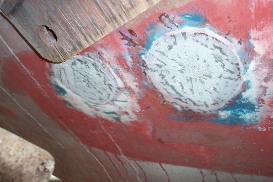

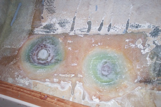

Just an update about the little bit I got done in the past week or so.

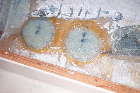

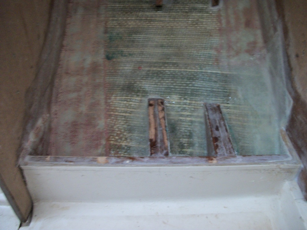

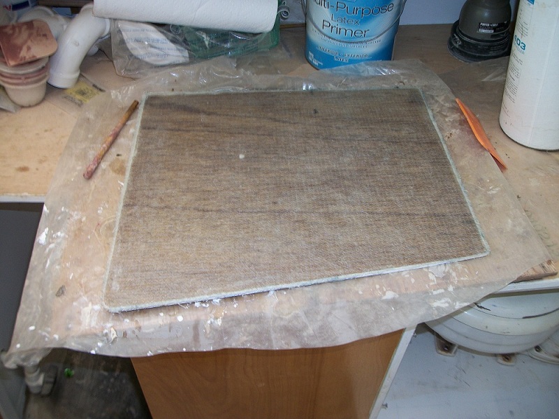

Working on epoxying in balsa core. I managed to get a few more pieces epoxyed in.
Slowly crawling along.

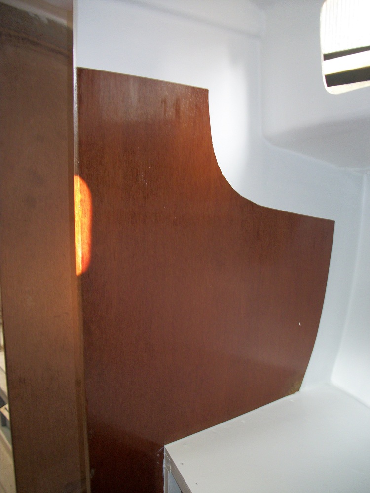

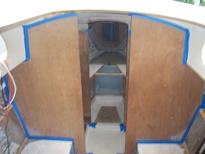

I am finally getting around to putting in new main bulkheads. I tabbed in the first one with 4" and 6" wide pieces of biaxial cloth. How many layers do I need to put on?
Re: Bristol 27
What weight of cloth are you (or did you) using?

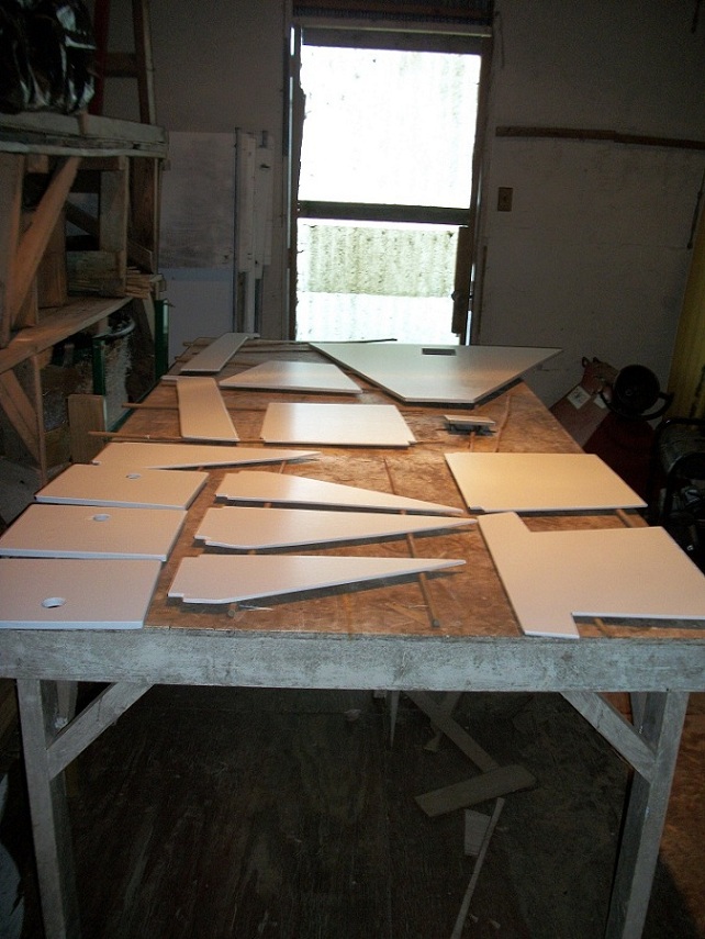

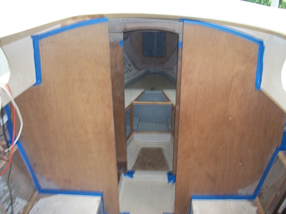

I have been busy this past month and managed to get some work done on the boat.

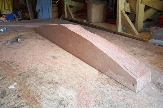

Built a new mast beam and put it in.
Also managed to rip out the starboard bulkheads and clean up the area.
old bulkhead star 1.jpg (21.05 KiB) Viewed 141290 times
star bulkhead area 1.jpg (20.48 KiB) Viewed 141299 times
Then made new ones and got them in.
new bulkhead for star 1.jpg (17.13 KiB) Viewed 141294 times
tabbing bulkhead star for 1.jpg (19.13 KiB) Viewed 141291 times
I have installed both 1/2" and 3/4" bulkheads on both sides of the boat. Still working on getting all the tabbing on them and the tabbing done on the mast beam.
Moving along verrrrrrrrrrry slowly but still moving along.

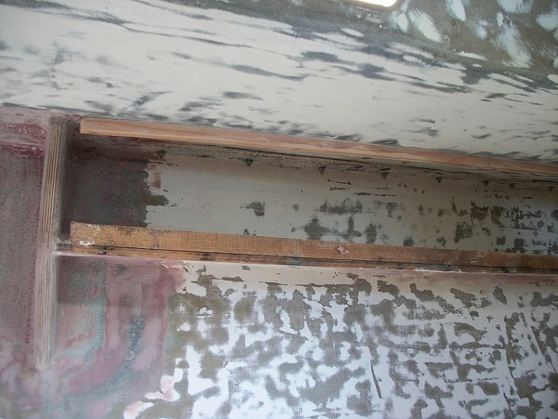

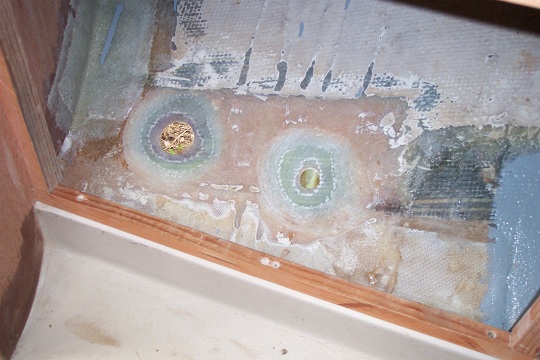

A little more work done this past month.

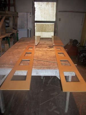

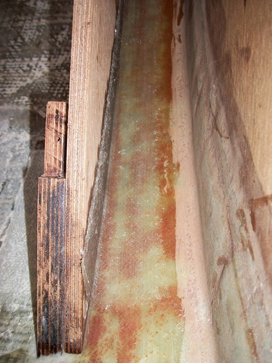

The floor pan is made in two pieces. The main cabin area is one and the v-berth/head area is another. They come together at the 1/2" bulkhead between the main cabin and the head area. They are not joined together in any way with a 1/8" to 1/4" space between them. Underneath there is nothing holding them up.
floor beam space 2.jpg (20.71 KiB) Viewed 141189 times
So I built a small floor beam to go under the area where they meet.
floor beam1.jpg (21.18 KiB) Viewed 141190 times
floor beam 5.jpg (20.12 KiB) Viewed 141186 times
I have it pushed in place only (it is very hard to reach through the acess holes in the floor, fore and aft of it, and reach it) and it seems to hold the floor up nicely. I will try to put a fillet on each side of the beam to hold it in place.
I also got four new knee blocks cut out (not yet installed).
Knee blocks 1.jpg (23.05 KiB) Viewed 141181 times

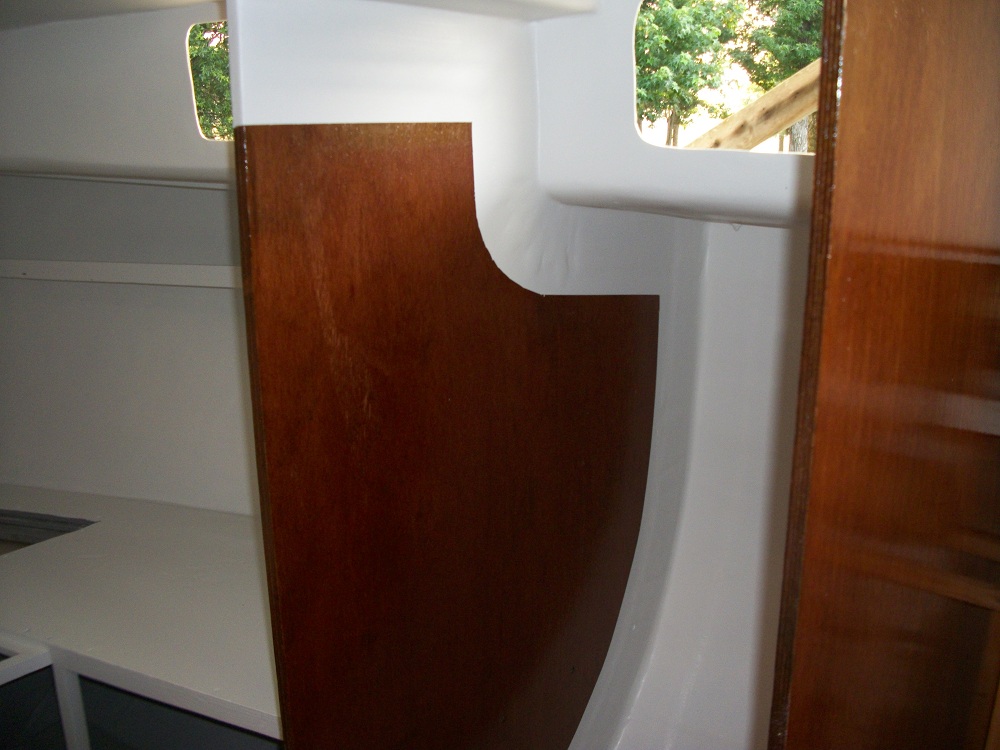

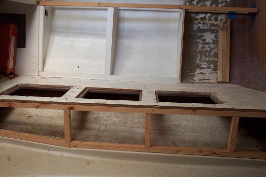

This morning I managed to get some work done on the starboard settee locker openings and bracing under the front of it. No pictures yet.

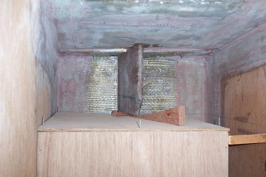

Re: Bristol 27

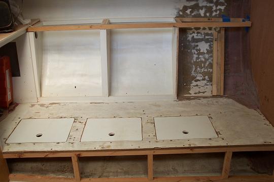

Post by Lloyd »
Pictures of yesterdays work.

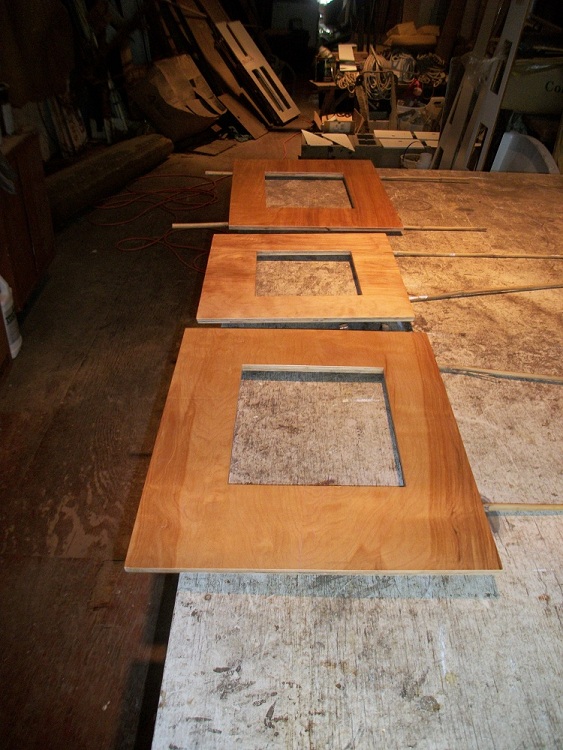

A little framing under the front of the port settee getting it ready for a face.
And the tops of the lockers in place.

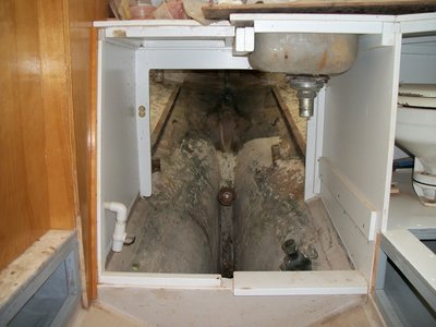

Today I cut out a couple of dividers to go under the settee to make three compartments.

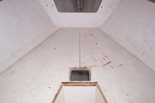

I moved on to the v-berth area.

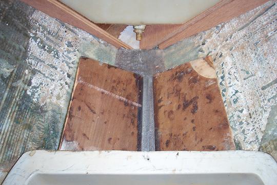

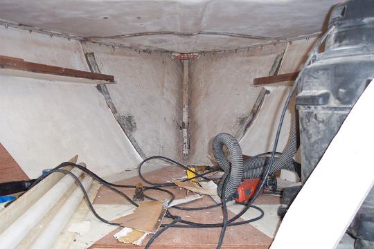

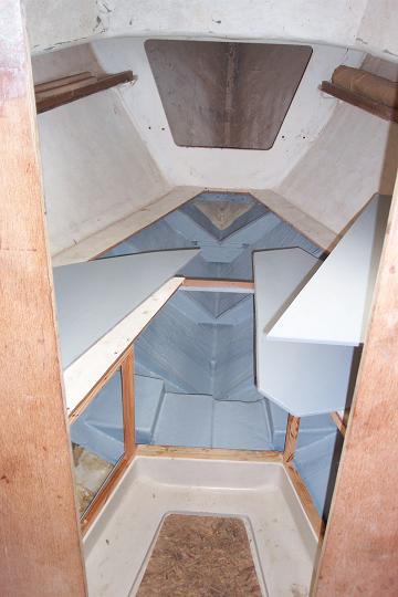

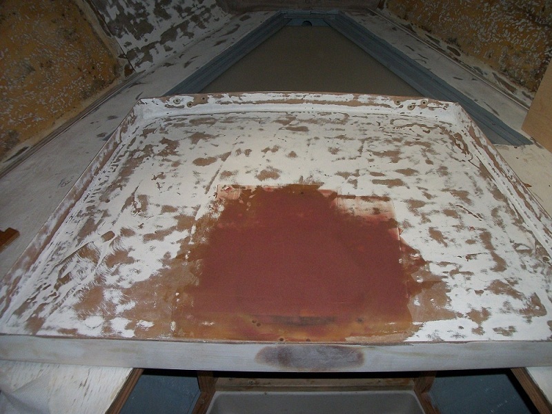

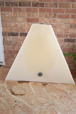

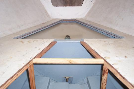

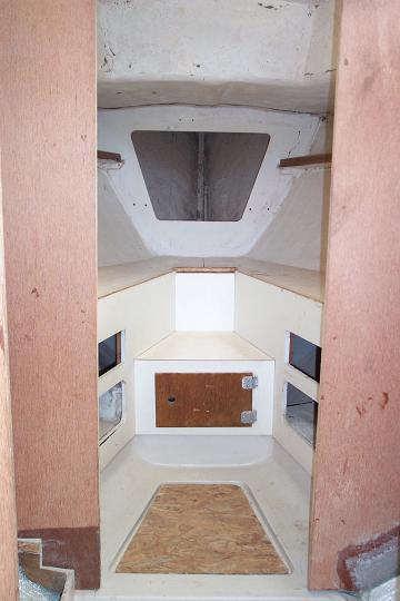

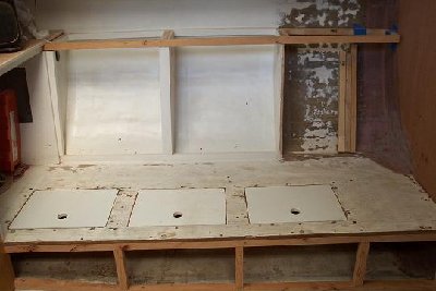

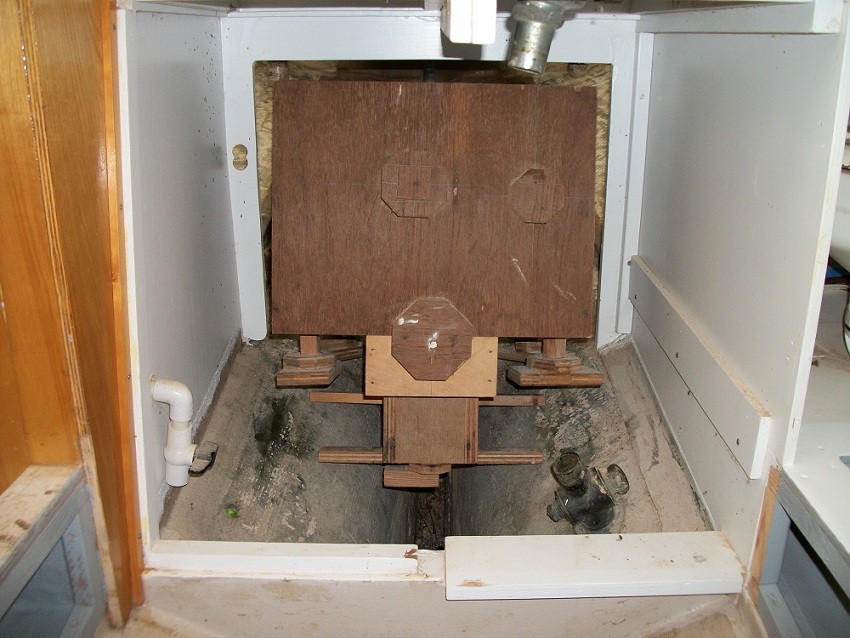

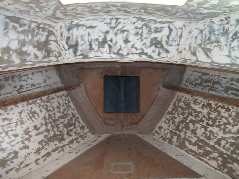

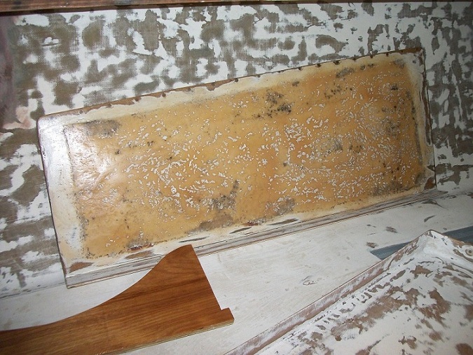

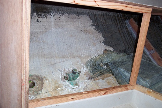

After cleaning out all the junk I, checked out the water tank under the forward part of the v-berth.
Sticking the camera in the opening in the plywood for the fill fitting for the tank and taking a picture I could see that the tank had dropped down. It was suppose to be up against those blocks with the vees in them. So I got the saw out and cut an area out of the v-berth so I could get the tank out. Once it was out I could see that tabbing had come loose which had let the tank drop.

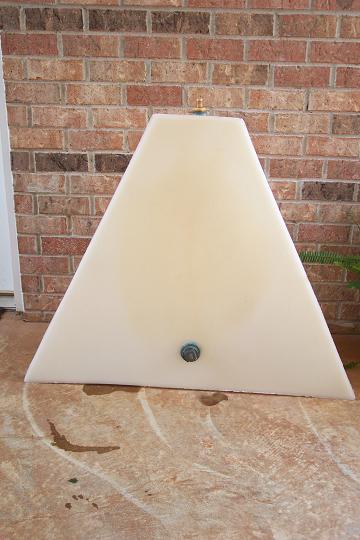

I cleaned up the tank which looks like I will be able to reuse, once I figure out how to remount it back in the hole.

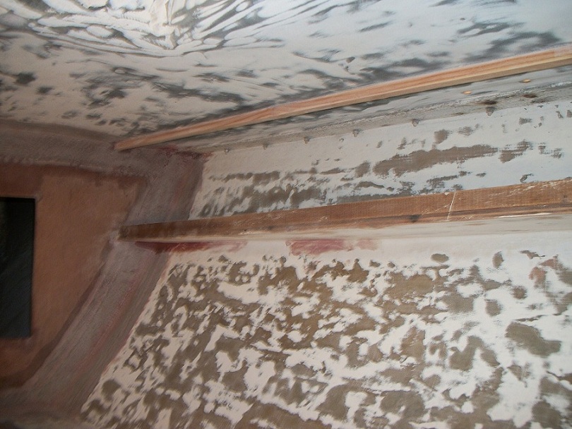

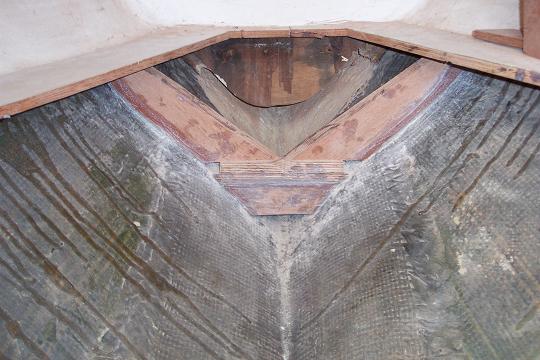

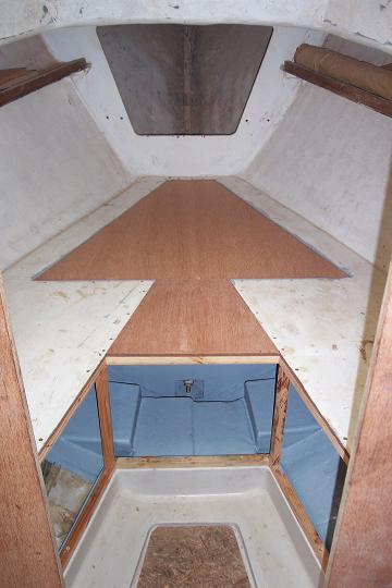

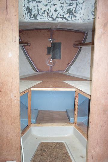

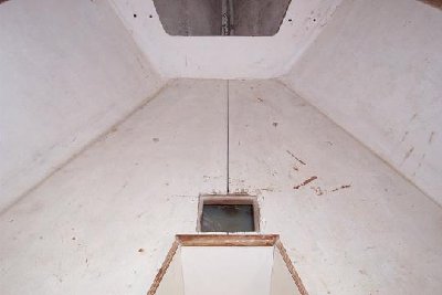

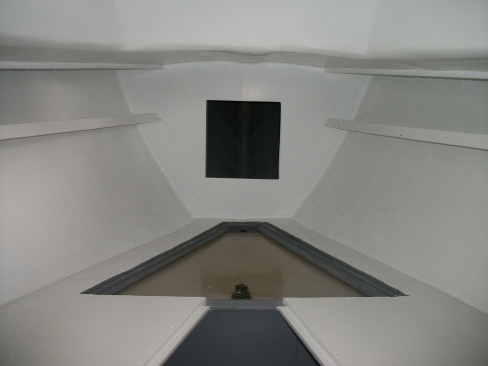

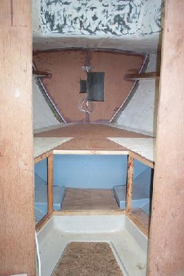

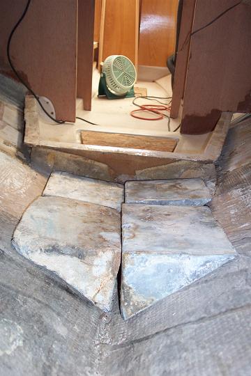

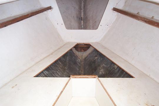

This is how the v-berth looked before I took out the little step/seat and the faces of it.

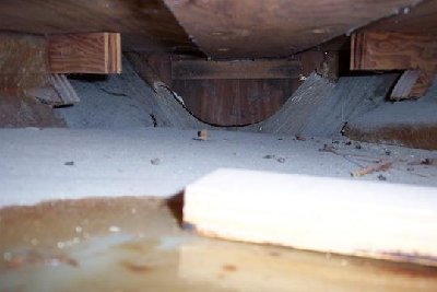

And this is looking aft from inside/underneath the v-berth. Notice on each side lead weights glassed in place.

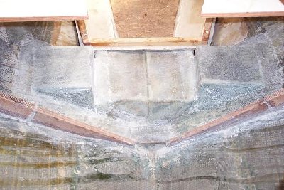

I cut out the lead weights and moved them around trying to find a better place for them. I weighed them while I had them loose- 62, 65.5, 68 and 72 lbs apiece.
This would have been a nicer way to put them but they went to far forward and were in the way of the water tank. I think I will leave two like this and put the other two up and out from the first two against the hull with a small floor under the first two. That way there will be a passage space under them for bilge water from the chain locker. We will see.

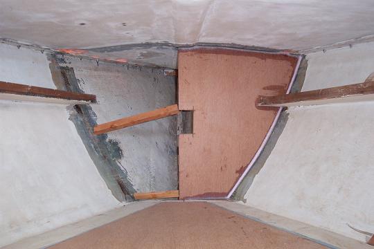

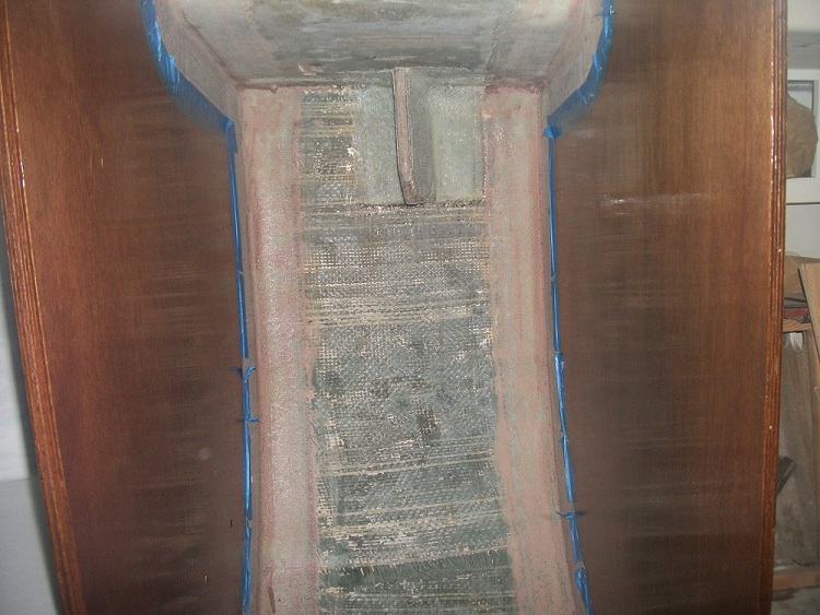

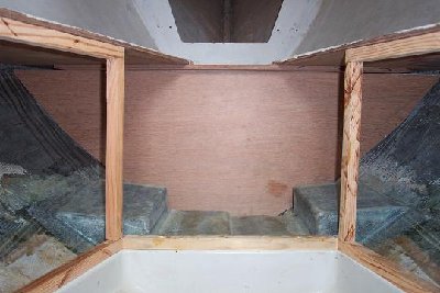

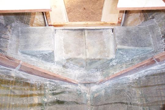

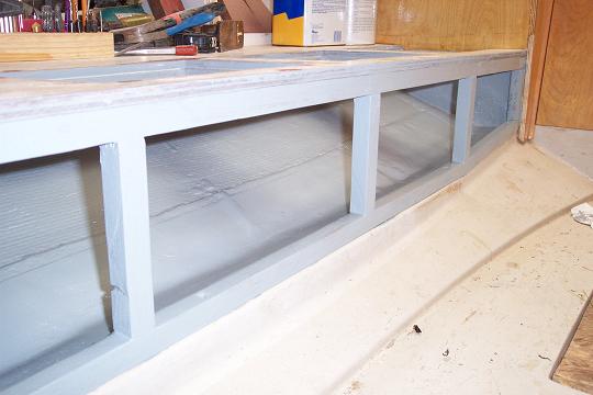

Here is the small floor I put in for the lead weights.
And some blocking to hold them levelish.

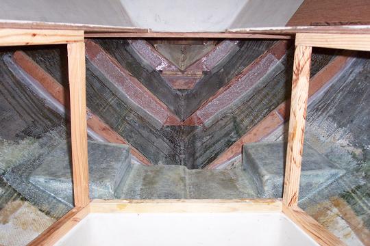

Then lower two glassed in.

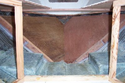

And all four glassed in.
That picture also shows the aft framing to hold the plywood for the water tank. This one is the forward framing.
I am thinking one more set of framing to hold up the 1/2 plywood base.

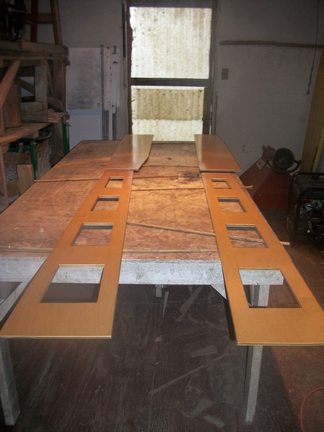

More pictures to catch things up.

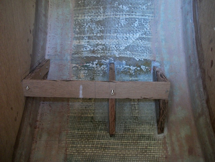

I got the third set of bracing in for the water tank and a little tabbing on each one of them.
Then cut some plywood for the water tank to sit on. The plywood to port was cut out of one of the old bulkheads I took out.

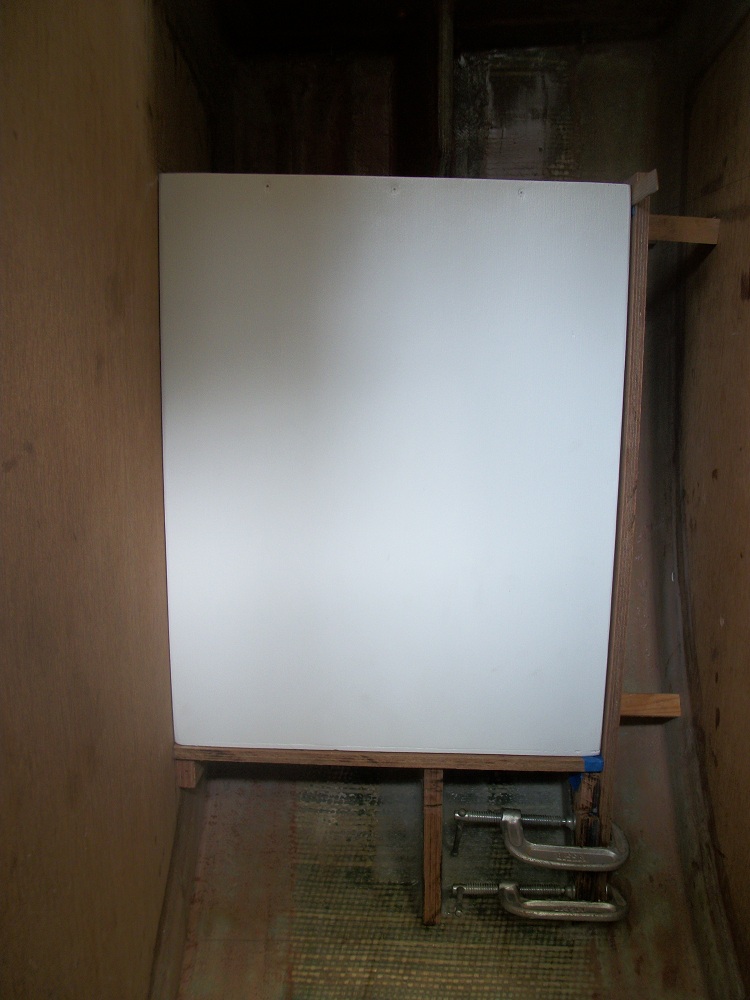

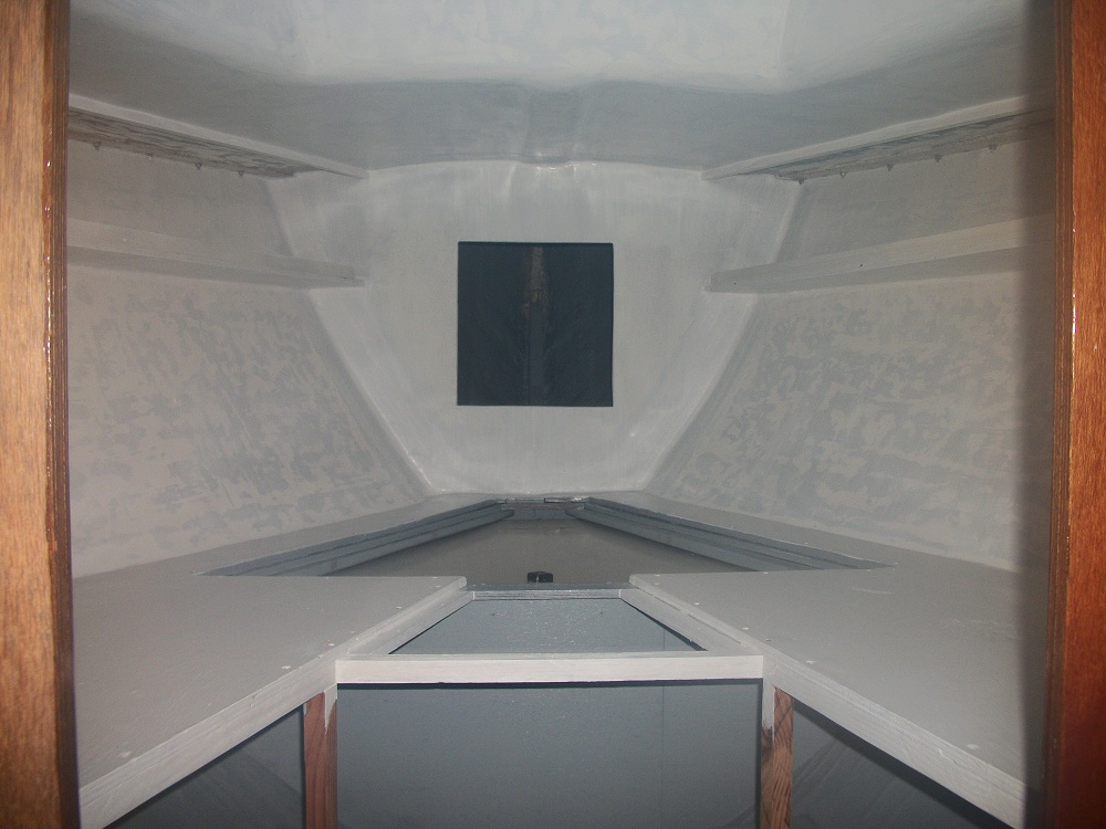

Also cut a bulkhead for the aft end of the water tank space. It will only be screwed in place.

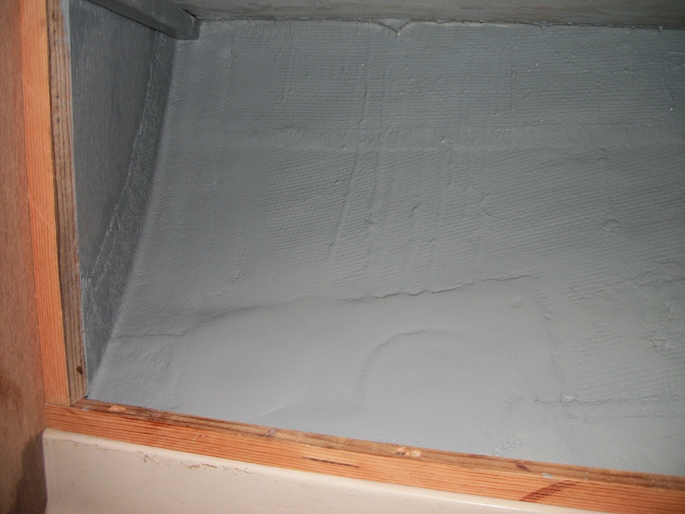

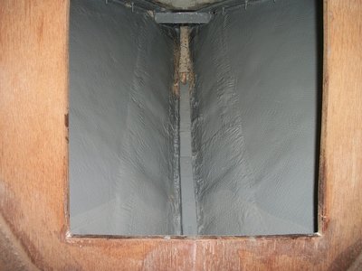

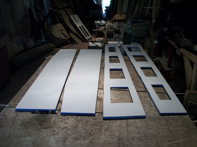

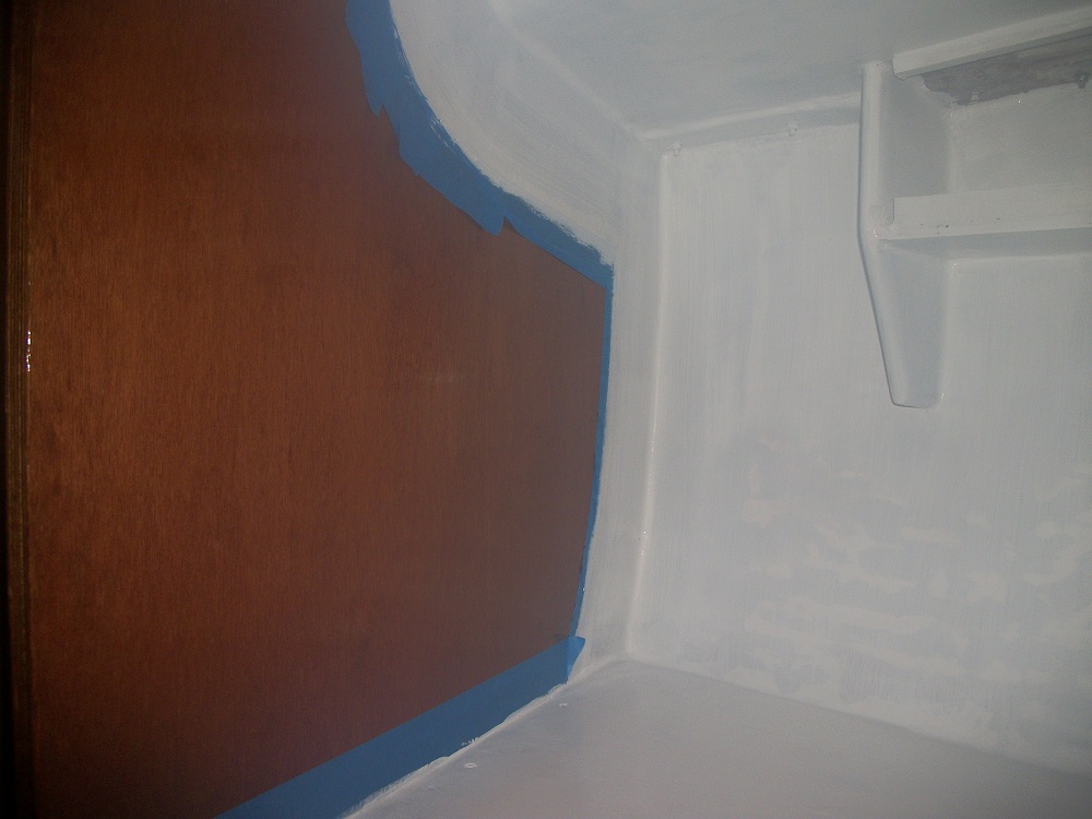

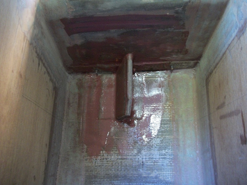

I got the bilgecoat paint out and painted out the area.

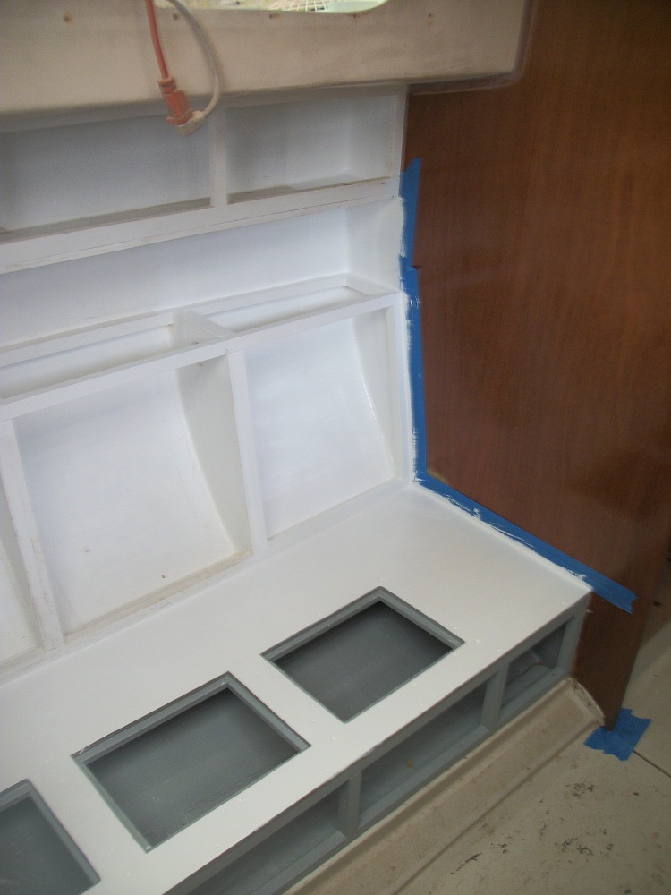

Also while painting, I painted under both the port and starboard settees.

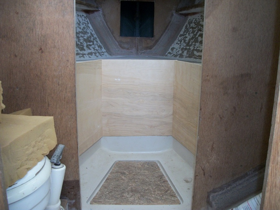

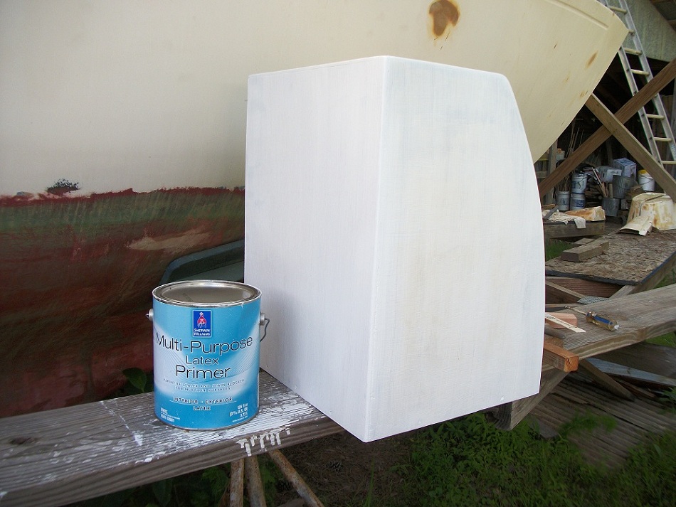

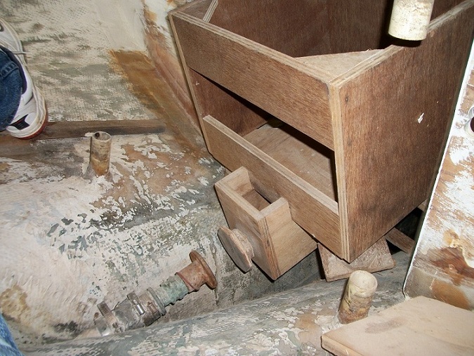

So while waiting on paint to dry, I started working on a poobox.
It will take up the space behind the head, fit to the hull. It will be a plywood box, glassed over inside and out. The back side of it is curved to fit the hull. The top of the box will bump up to the bottom of the chainplate knee (not yet installed). I left a space between the box and the forward bulkhead for piping going up and down. Rough figuring it comes out to hold about sixteen gallons, give or take.

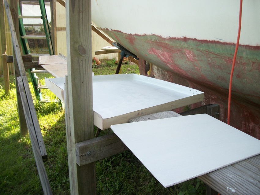

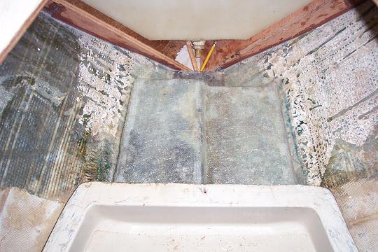

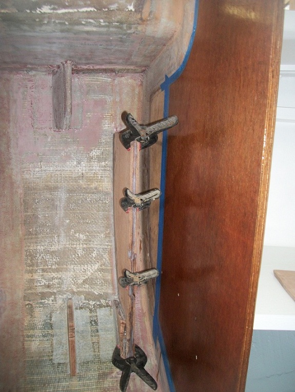

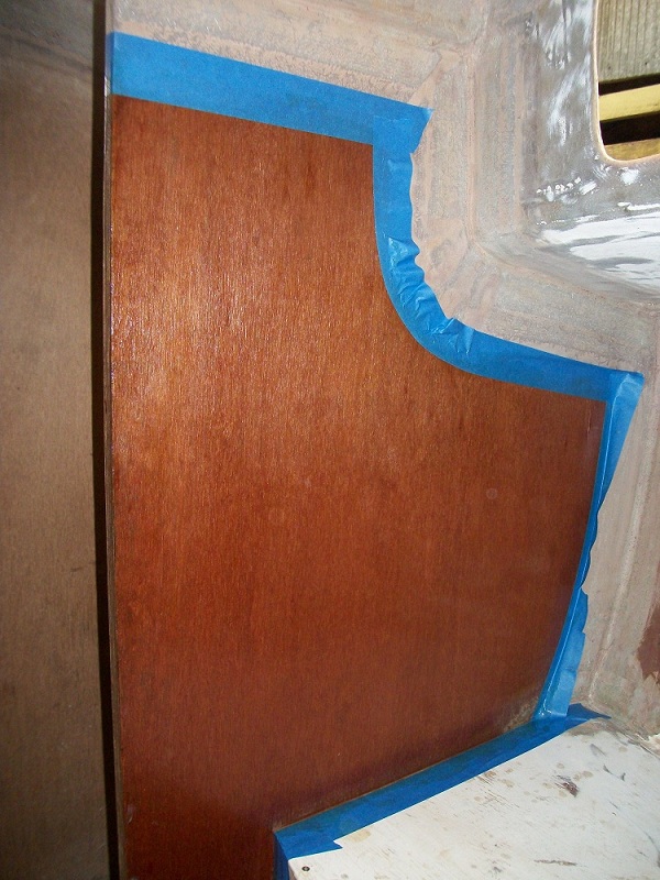

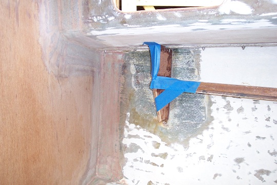

A little more work done in the last few weeks.
I set the water tank in place after letting the paint in the area dry.
Then I got the plywood filler pieces cut and set in place.

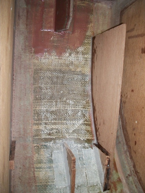

I got both port and starboard aft chain plate knees epoxyed in place. Tabbing yet to be done.
I started to put a small floor in the chainlocker but when I went to screw a cleat into the bulkhead found it to be in bad shape. So out it came.
I then made a pattern for a new bulkhead and figured out it wouldn't go in in one piece.
So it was put in in two pieces.
Since the picture was taken the tabbing on the chain locker bulkhead has been added. Two layers of biaxial, one 6" and one 4". The tabbing on the two chain plate knees has also been added. Same two layers.

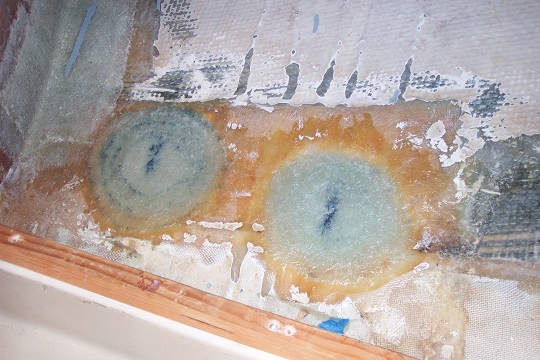

OK, I'am a little lazy. Winter is for laying on the couch and watching TV. But now it's Spring, I guess it's time to work on the boat some.Old head thru-hulls, in and out. The out valve has already been taken out.
Grind beveled holes, inside and out.
Cut out cloth for the inside and outside, first round 4-5 layers each.
Epoxied in place, outside, then sanded.
And looking at it from the inside before the inside pieces are epoxied in.
I also got the forward, port, chainplate knee epoxied in place with fillets.
Posts: 188
Boat Name: Ella Marie
Boat Type: Bristol 27
Location: Pelahatchie. Ms
Re: Bristol 27
Post by Lloyd »
Inside pieces epoxied in place. Four layers, biggest to smallest.
And second round of inside pieces. Two layers, smallest to biggest.
Then I sanded them both smooth.
The outside got three more layers and then sanded smooth. (No pictures)
And this is how I held the outside pieces in place. A piece of plastic, foam, plywood and sticks to hold it all up in place.
As always small steps, but steps none the less.

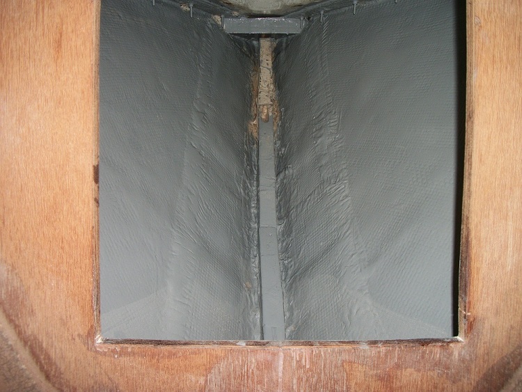

Still working on her.
I got the patches painted.
And while I had the paint out I hit the anchor locker, and I ran out of paint. This is the second time I have painted in the anchor locker. I just can not seem to reach into it and be able to get to much of it with out leaning on wet paint. So I am doing it in stages. Left to get to is the top and the forward side of the bulkhead.
I also primed and painted several misc. pieces (storage area floors, dividers and lids).
I cut out two cleats and epoxied them into place above the v-berth shelves, port and starboard, to hold a plywood face on the shelves.
I think I have the all the v-berth area sanded and ready to be primed and painted.
I have a little more done and I will post somemore pictures another day. Bed time now.

OK a few more things I got done.
I got the three panels cut out and fit into place for under the v-berth. I still have to decide on the size of the openings in them. They will all have openings with some kind of cabinet doors on them.
I started varnishing on the forward side of the v-berth bulkheads (port and starboard) so I can then start priming and painting in the v-berth area. I figure it will be easer to clean paint off varnish then unpainted wood that will be varnished.
I added some fairing epoxy to the underside of the aft hatch where I had filled in an old vent hole in it. Getting it ready for painting.
Both of the cockpit locker lids had some pin holes on the underside of them into the core. It would get mold in them. So I coated them with clear epoxy to try to seal them up after I sanded them.
I got a coat of primer on the outside of the poo box, poo box lid and the underside of the aft hatch.
And the last picture is where I am getting the other bulkheads taped out, getting them ready for varnish.

I had been putting it off for years, but about a year ago I broke down and ordered nine sheets of Meranti BS 1088 out of Florida and had it shipped. I got 4 sheets of 3/4", 3 sheets of 1/2" and 2 sheets of 1/4" for $941.25 including shipping. I had it shipped to a business for a cheeper shipping cost. The two 3/4" bulkheads I thought would have to be cut out of two sheets but they actualy only needed one.
An update on work done, painting and varnishing. Not much to show in pictures, just just more coats of white on misc. small pieces and varnish on the bulkheads.
Heading down there now to cut out the faces for the v-berth shelves and the faces of the two settees.

All the face plywood is 1/2" birch from Home Depot.

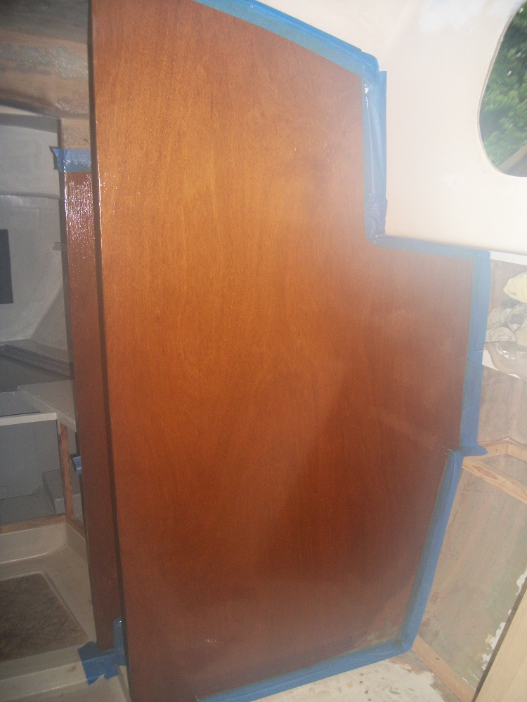

I got the face plywood for the v-berth shelves and the settees (port and starboard) cut out, fitted, sanded and the first coat of varnish on them. The faces will be varnished and the backsides will be primed and painted white. No pictures the camera was dead today.
Posts: 188

Post by Lloyd »
I got rained out this afternoon at work so I worked on the boat.
A coat of primer in most of the v-berth area.
And a second coat of varnish on the settee faces and the v-berth shelf faces.
Also the fifth coat of varnish on the bulkheads.
Hanging locker area.

I was curious why you put the extra ballast back in? I had read that about three hundred lbs helps bristols hobby horse a bit less in that position on bristol owners. had you read anything else on it or have another source? Id be interested to hear how she sails once she is in the water.
Posts: 188
Re: Bristol 27
Post by Lloyd »
I was just moving the extra lead to a better place in the storage area under the v-berth. I was taking the drawers out so as to open up the area for more storage. The way the lead was placed in there just messed up the area. I have no knowledge of how it affects the trim of the boat. As for seeing how she sails, well that maybe a while, a long while. Does your Bristol have the extra lead in it also?

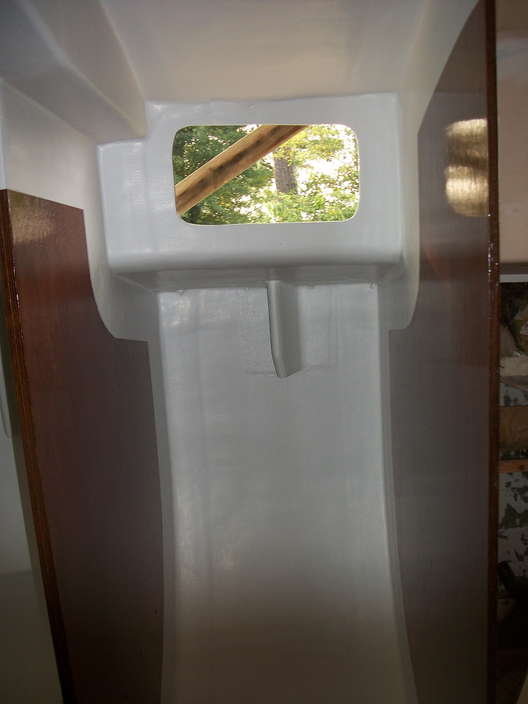

White paint, white paint and more white paint. Oh and a little varnish.
And the beat goes on.

Post by Lloyd »
Thanks for the nice words. The paint makes me feel like it is comming together. Still a lot to be done.
Speaking of paint. I got the backsides of the V-berth shelf faces and settee faces primed and painted.
Working in the head area, I added a couple support blocks under the platform for the head. I plan on putting the 1 1/2" thru hull in the space to the left, if it will fit and the hoses work out.
Also in the same area, I am puttng in a shelf for the poobox to sit on. I cut out a pattern for a mimi bulkhead to be epoxyed into place along the edge of the shelf going up to hold the poobox in place (forward side). That will leave a space for hoses going up. One from the head into the top of the poobox and another from a tee (line to thru hull) under the poobox for pump out.
And spread a little epoxy fill to smooth things up (not sanded yet).
It's starting to get hot, so after working outside all day at my job it is getting harder to work on the boat at the end of the day. I would rather head to the house and soak up some AC and relax. So I guess Summer is here and boat work slows down.

Ghostwriter247-- The ceilings in the V-berth area had a light weight cloth on them so they were smooth, not faired. There were two different coats of paint. The last paint put on was flaking somewhat. When I sanded I tried to make sure I sanded the flaking layer all off and the first layer off only on the high spots. See the pictures above pre-paint. It is all spotty, paint and fiberglass.
The ceiling in the hanging locker was just the hull heavy roving no light weight cloth. I just sanded the high spots of the roving not worrying with the low. It didn't have the same two coats of paint and the paint was still sticking just fine. Also I was not worrying about any print thru in the hanging locker area.
Finish; Two coats of primer, sanding after each coat lightly. Two coats of paint, no sanding.

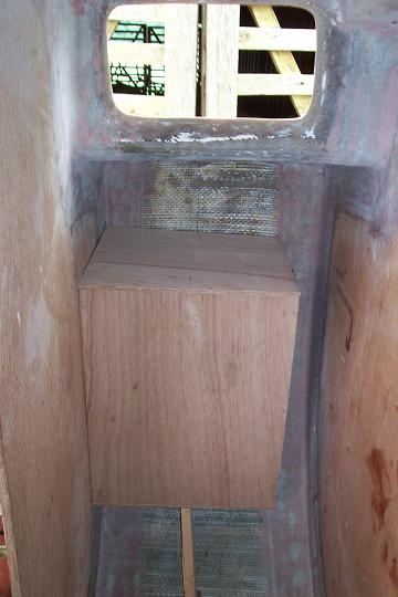

More stuff done.
I got the poo box mini bulkhead cut out, fittted and epoxyed into place.

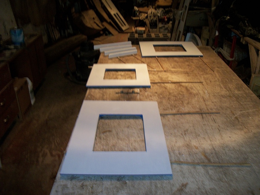

I also cut out the openings in the V-berth plywood faces and got two coats of varnish on them today.
Later in the day I added a fillet to the aft side of the mini bulkhead and a 4" piece of tabbing to the forward side of it.
I then cut out a piece of biaxel cloth and epoxyed it on the underside of the poo box lid.

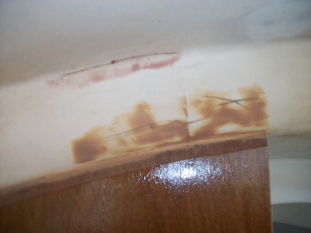

I have also been working on all the hair line cracks in the main cabin's head liner. Scratching out the cracks with the point of a chisel and then filling with epoxy filler. I am not sure if this is going to work, long run, but I am giving it a try.

I also added a 1 1/2" strip of 1/2" plywood to the forward inside edge of the poo box mini bulkhead. I taped off the bulkheads in the head area and got two coats of varinsh on them.
Moving aft in the boat, I cleaned out the motor area.
I dug out my old motor mockup and set it in place. The old sink seacock/thru hull needs to be taken out and the hole filled in. I am going to use a shower sump for the sink drain and ice box drain that will pumped out somewhere (transom ?).
I need to check the dimensions of it then get it set up right so I can figure out the beds for it. I am thinking of going with a Beta Marine 10. Thats what my mockup is based on.
