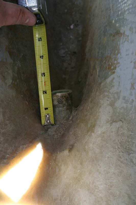

Not much to report but here are a few pictures of my cheap and dirty fix to my altogether-too-short prop shaft tube. Note: I am only extending it to get a second clamp on the shaft seal hose. Nothing structural or truly necessary. Simply piece of mind seeing two clamps on the hose that could sink my boat.
Original tube:

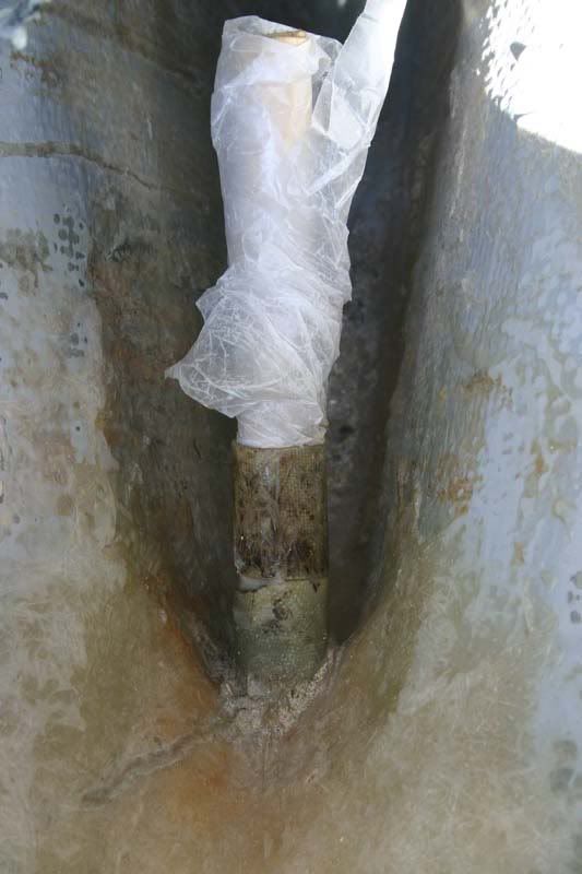

It turns out Pearson seems to have used one size of fiberglass tubing for everything. This is a piece of the old cockpit drain tube (I save most everything off the boat) I just glued it in to provide some continuity with the original tube and offer some rigidity to the final structure.

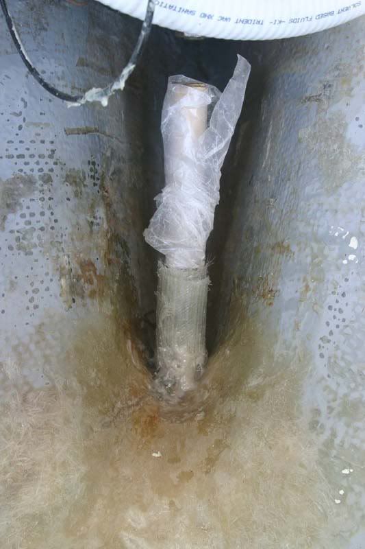

And finally, I wrapped the whole thing in a couple of layers of biax tape. I will give it a day and then remove the temporary wooden alignment dowel, dress it a bit, paint it, and call it a day.
Like I said. Small project. Not really worthy of its own thread.
