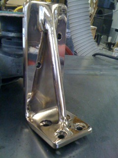

On my last Triton I used a similar bracket, not as well done but effective, made of 3/16" x 1 1/2" stainless I believe the brackets were 3" on the base and 5 1/2" high with a brace welded to one side. Onto them I bolted a piece of mahogany approximately 12' long by 3 1/2" wide rounded on both ends with all edges rounded and painted light grey with nonskid inboard.
It started at the step in the cabin trunk and ran forward to just aft of the forward post on the pulpit. The brackets were mounted up against the existing toe rail with the plank outboard, a space was left between the toe rail and the plank. I saw no need to go any farther aft, the goal was to keep things,myself included, from going over the side on the foredeck and to provide footing while reefing close hauled. By painting light grey and not running full length they were hardly noticeable.

That sounds like an interesting idea - for a smaller boat especially. I'd love to see the photos. If you can't get them uploaded feel free to PM me and I can try to help you.

Thanks Barry. I've been pondering this for a long time, and I really like your idea. Looks/appearances have never really been high on my list of priorities (safety and comfort are more important to me), but I have to say that doesn't look bad at all!

Looks great Barry! What a great idea.

Those bulwark/toerail pieces do look really nice, and functional. If you ever come across a photo of the whole boat (say from a bit more of a distance), that would be nice to see too. Thanks again for posting the photos.

They look nice. The simplicity appeals to me.
What was the source for the brackets?

They were made by the person that made my vane, but any local welder could make them. I had them made at 90 degrees and they worked fine but if I were to do it again I would adjust for the angle of the deck.
