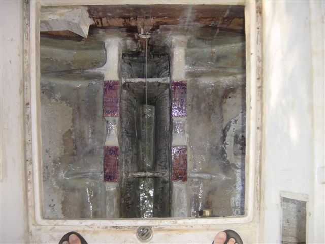

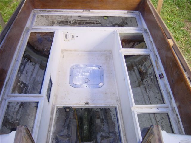

There had been a lot of water damage to the interior requiring the hull interior to be gutted and all but one bulkhead replaced. This gave me a lot of practice with the "Tick stick".The stuffing box was almost impossible to access so I installed an access hatch in the rear floor of the cockpit.
