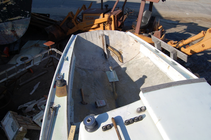

Today: Pictures on the blog.
Today I took off work around 3:00 and went till 7...

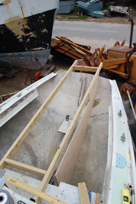

I started out with a template of the stringers that will become the cockpit sides.
The easiest way I've found to start a project that hangs in space... Is to build a 2 dimensional outline that can be hung in space, defining a few planes.
In this case, I have some very straight 2x4's that are marked out in 6 inch increments from the aft end of the cockpit back. In addition to this, I have lines drawn square to the faces... so I can measure down with a tape measure or folding rule (folding rule gets a better fit) and jot down the measures on a notepad. The easy way is feet, inches, 8ths. When you go to warp a batten around something 16ths don't matter very much.
Good batten material: buy a #1 kiln dried treated 2x4 that is perfectly straight, no knots around 10 feet long... Rip with the grain... Feel around for hard spots and thin it down if there are any. Its not so important for lofting lines that it be perfectly the same width, as it is that it'll bend to your marks evenly. If you are jointing with a table saw... rip off one side, put your ripped side to the fence... rip again... then take your pass. I like around a 1/2 inch thick for big boat stuff... Rip a bunch of them, as they age some turn to hockey sticks/firewood.
From here, I marked out a piece of flat birch plywood... doesn't do you any good to make a template out of scraps that aren't straight and flat. I used a sheet rock t-square and made lines every 6 inches, then laid a piece of brown contractors paper across the plywood, and remade my lines. If it fits right the first time, I have my template for the other side... but where the paper comes to shine, is doing what I did here. See the tall section at the far end? I measured down from the underside of my 2x4's... You can either do the math to add a few inches to every measure, or just slide the paper to where it looks right... and or, find a piece of scrap that it lays over but didn't have a factory side to loft off of...
Next, take a screw and lay it on your marks... smack it with a hammer. Your mark is transferred from the paper to the plywood quite nicely. Now warp a batten around and play connect the dots with a pencil. Let it fly where ever it runs natural... this is just a template.
Take it to the boat, screw it to your bridge... now take a compass with a pencil, lay it on the hull and scribe the line. 3/4 or 1 inch is a good setting... measure it and jot it down on the piece. Go back and cut it out with a jig saw (or a circular saw like I did here... it's faster.)
If you are doing a bulkhead that has a sole that is flat... I build a carpenters square that stands on its own... a 1 ft square piece of 3/4 as the base, and two 2 foot tall by 1 foot wide pieces screwed together. Now if your floor is square you have something to align to, something to screw a piece of luan to for a joggle/tick stick...

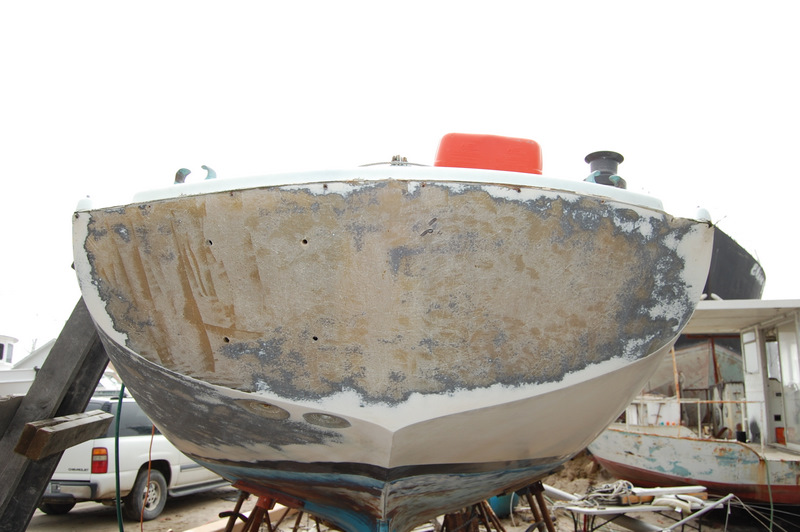

Anyway, next up I cut the transom flat. I said yesterday I was going to loft a 1/2 inch curve into it... I decided today that flat will work just fine. A Triton's transom curves out 5 inches from square, per the plans... 3 1/2 inches at the top by my measuring. Mine was 2 1/2 inches taller than flat, so you have options. Either warp a batten around it, or take a piece of doorskin and roughly scribe the transoms curve on it. Then transfer that to a piece of 3/4 plywood that is wide enough not to lose its flatness... then come back and lay a pencil on top and scribe your line. If you like it... come back with a sharpie.
Once I scribed my line, I measured it out... 32 inches from the bottom of the heart to each corner, and 21 to the middle.
I cut the transom with a thin metal cut-off wheel (1/8th inch) on a 4.5 inch grinder. I always cut this kind of thing at an angle, where the back of the cut is much higher than the line, in case of goofs. If you try to hold it perfectly level, and things go awry you have to make it grow back.
I also advise cutting a 1/4 inch higher than the mark. It doesn't take long with 40 grit on an 8 inch grinder to turn a whole boat into dust. I came back with a straight edge and played with it till it looked right.
After that the weather started going south, so I fired up the grinder and attempted to burn off all the gelcoat on the port side. Didn't make it all the way... but total time invested hit 16 hours for the port side. She has an 1/8th inch of white, on top of the black tooling gel... It's about like firing up a grinder on a parking lot.

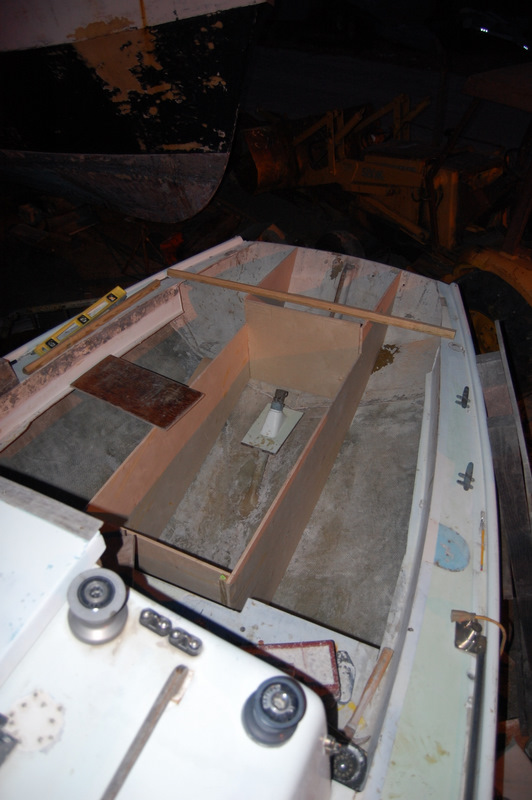

Re: Great Grinder Skirmish 2010 Edition...
Pictures from yesterday

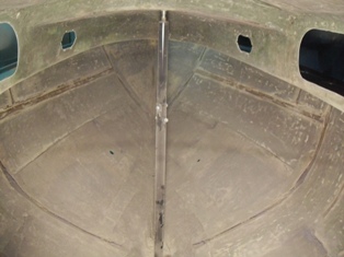

Two nights ago I laid up a sheet of divinycell with a layer of 1708 on each side. It was set up and pretty this morning...
Last night It was raining, but not blowing very hard so I could work inside and stay dry. I went from around 5:30 until 9:30.
I cut out the starboard settee with a skill saw and rode along side the tabbing. The face came out in pretty much one piece. Then I ground down the top tab to the plywood where I could see the seam, and got the aft end freed up off the lower tab with a pry bar. Once the ply was out I used a cutoff wheel to slice off the part of the tab hanging out... Saves on dust.
Then I cut out the aft shroud bulkhead, if she was still fitted out... The hanging locker bulkhead.
I used a cut off wheel on the angle grinder, cut through down to the plywood right beside the hull, then came back and ground it with some hard backed Norton 36 grit on the angle grinder. (4.5 in) I chopped the bulkhead in half with a sawzall to make it easier to remove. Geometry wants to hold a tightly fitting bulkhead in place. It won't be going back in the same spot... so no need to keep the old as a template.
Most of the plywood was in pretty decent shape, except the outer edge of the bulkhead. 4 layers thick in some areas, 1 mat, 1 roving, 1 mat, 1 roving... then finish cloth. Beastly strong... I went down to the first layer of mat, I'll come back with an 8 inch pad sander to keep everything smooth.
Took a dinner break, and came back to do some more grinding. I burned down the tabbing... Still have a few feet to go before its a fresh start on the starboard.
Pylasteki looks like 25 pounds of powdered sugar was dumped inside of her...

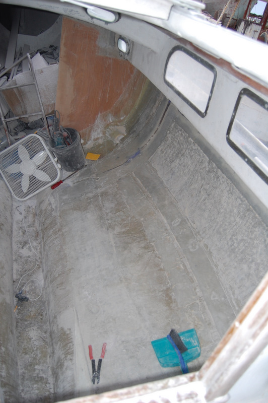

Today I cut out the port settee, and most of the head bulkhead. It too was full of water... I switched over to 16 grit Norton (bought another box...) and have been using Nortons hard rubber backing pad instead of the flexible black plastic ones you find at the hardware store. They will grind up into a corner and leave a rubber trail... instead of getting caught on something sharp and getting jagged. I like diamond flap discs when I'm working with all fiberglass, as they last forever... they get loaded up with wood, so cutting out bulkheads they aren't so great. The hard paper backed discs run about 2 bucks a piece... I've used 6 or 7 so far.
Tonight I went from around 5:00 till 6:30 laying up another divinycell panel, and grinding off the edges/prepping the face of the one from a few days ago. Should be ready in the morning. I'm planning to mock up my cockpit in the morning out of plywood, get all my templates made and then start assembling the pieces. It is supposed to rain sunday, so I will switch back over to grinding later in the evening.
Picture will come after I'm done grinding and get all the dust out. Today I scooped up a lot with my dust pan off the sides of the hull where little avalanches were forming...

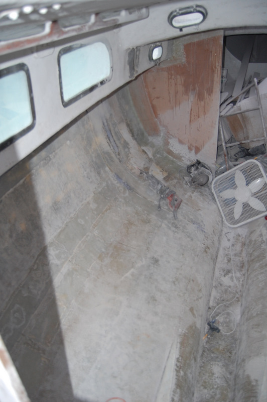

Today... Finished grinding out the tabbing for all the settees, bulkheads, and starboard shelf. I took those down too... New ones will run full length.
I pulled out the port aft lower chain plate and knee. It too, was full of water... though surprisingly not rotten.
I goofed. I was grinding with my 8 inch Makita (9227c... just get one...) full tilt with a piece of hard backed 36 on it, when it dug in... tore the paper and ran down to the bilge. On its way, the flag of torn paper took a pass across the back of my left hand. Just as an FYI... If you work with your hands and get scuffed up... put down the tools, clean it up, and hold your fingers closed in a fist and wrist bent down till it scabs up. That way you keep your range of motion without it popping open and scarring up. I took a lunch break, and waited for it to scab... then went back to it.
Finished up around 6:30 today.

Settees removed, head bulkheads removed. Chainplates pulled, galley bulkheads removed... Salon shelves removed...
Then all the tabs ground down. I ground down to the first layer of mat against the hull with my 8 inch makita grinder, and made a lot of dust. Pretty much everything was tabbed in with 5 layers. 1 layer of mat against the hull, 1 layer of roving, another layer of mat and another of roving, then a last layer of mat. I swept up close to 30 lbs of dust by the old calibrated elbow... lifting the cardboard box over the side.
I removed the paint using a 4.5 inch grinder with a twisted wire wheel. (not a cup style)
I held it perpendicular the hull, and moved it up and down following the angles of roving, then held it upside down and blasted the other side of the roving. Fastest way I've come up with for paint removal... Though it has crossed my mind that it'd take all of a half hour to grind the inside of the hull smooth with 40 grit on an 8 inch... But that would sacrifice some strength, and I'm not into that even though the Triton is built sturdier than the temple mount...
As far as order of operations go, take out the shelves and top of the bulkhead and grind it all flush before removing the settees. I wasn't thinking straight when I started from the bottom up... Ended up twisting and contorting to make it all happen... cest la vie. Small boats are not as easy to work on as big ones, though a day of grinding does noticeable things.

This took me since July 4th 2009 to do. Looks like were pretty close as to where we're at on our boats. Today, my porter cable random orbiter sander burnt out. Was 2 hours into sanding and it crashed on me, wasn't happy. Are you going to fill in those voids where the old bulkheads were? If so, what is your technique to do that?
- SDC10793.JPG (52.69 KiB) Viewed 9404 times

Caught a cold today so after work when I pulled into Pylasteki's spot, I couldn't bring myself to hop out of the truck...
On the main bulkhead I ground all the old mat tabbing out. Since this stuff runs along the length of the boat, I'm just going to add a little thickened epoxy (cabosil more than likely) to fair out the low spot after wire brushing it and an acetone wipe. I'll go back to the roving in spots that will have something tabbed in on top of it. On my main bulkheads I laid a 12 inch wide piece of 1708 from top to bottom and then set the bulkhead and tabs in on top of that. Probably not necessary, but I've got a thing for making stuff stout. Followed up with a layer of 6in tab (12 inch wide) and a layer of 8 inch tab (16 inches wide) on top of everything. Takes a lot of resin to do it... Weigh the cloth before you start, and that'll get you close on the amount of goo required. 50/50 cloth to resin.
For the most part the old tabbing was well done, but where I found yellow spots that indicated dry glass that flakes up... I ground off the loose stuff. A twisted wire brush on the old 4.5 inch grinder does a good job at pulling it up while leaving the well adhered stuff well enough alone. Even where there were dry spots and such, it still lasted 49 years without failure other than the bond to the plywood in places.
Every bulkhead I've pulled out of her has been wet... most of the rub rail screw holes line up with bulkheads... The reinforcing stringer that my starboard shelf rested on was rotten, water is amazing stuff.
I've been mulling over building everything else from here on out with foam and epoxy. It might delaminate, might even take on some water... but it'll never turn to total potting soil. Sigh.

Yesterday after work I cut some out the rest of the cockpit templates I had been drawing up.
Just 1/2 inch birch plywood, good enough stuff to hold a straight line without much help.
I spent some time re-leveling Pylasteki, as I noticed a little air under one of the once tight jack stands. Hazards of working in a boatyard with a sand lot... Just used a water level and marked the scribed waterline.
I'm calling the cabin top/hatch sliders level, which is pretty close to the scribed waterline. Most of the time I measure top and bottom of stuff that runs athwartship (from one side to the other) off of a known true plane... Or something that isn't going to get changed. So, while I could hang a plumb bob to see if the vertical faces on each end of the cockpit are inline with gravity, what matters more to your eye is that they are inline with the rest of the vertical lines on the boat... So if the companionway bulkhead mirrors the main bulkheads, thats what I'll build to. Otherwise with the hatch boards out bulkheads will run at a different angle than the cockpit.
Not to say that is something even worth thinking about... but if you have a boat set up in one spot and steady you can pick a bulkhead to work off of and build a whole boat that looks right, or try to trust a plumb bob and level and build something that doesn't match. The trick is to take a level, and cut a wedge off one of the bulkheads so everything is evenly out, to the center of the earth, for the entirety of the bilge.
I'd probably change my tune if I mostly built boats on land, but the big one floats... so my brain wraps around thinking the boat is in its own little world.
In other news, my 24 inch wide cockpit won't work. I had a boat in the past with straight, narrow cockpit seats... but it had a transom hung rudder. Pylasteki's tiller sprouts up from the cockpit sole (floor) and needs a greater swinging clearance for knees and other things. Because of this you have to be far enough away from the tiller to make a tight turn, but also close enough to push it over the other way past center and gybe... The close enough in side of things, means I'd need to shove the coamings in about a mile to make it comfortable to push a the tiller past center.
The reason for the Triton's tapering cockpit is so when seated, your forward knee has somewhere to be. It tapers wider at the front than the back from 26 inches to a hair over 37.... at the forward end... at least at the top.
If I were not building a blue water boat, it'd be easy to square everything off and do away with the bridge deck, gaining the clearance to make things work. But, I'm not... So, no matter how much I like the aft end of a Herreshoff Alerion 26, things will go back more stock than not.
I also fired up the pad sander and started on the starboard side gelcoat removal and stopped as the sun was setting. It's not real smart to plow around with 40 grit after dark, at least in my book... as the fairer and flatter you can keep something while chewing off the old finish, the easier it is to arrive at an end product that is smooth and fair..
