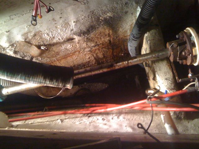

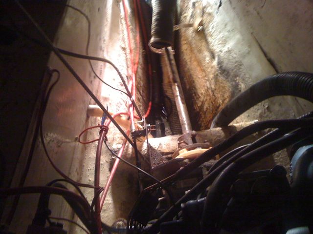

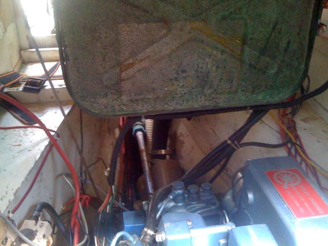

One of the items on the list prior to launch june 23 is to trouble shoot and repair the bilge pump or wiring that was causing a short in that circuit. the problem on the Morgan M34 is that the bilge is Very hard to access without removing a lot of stuff and then hanging upside down into the abyss.
So I removed the batteries, 29 gallon fuel tank ( needed a rinse anyways ) and the exhaust waterlock and a lot of my skin. oh, and the bilge pump and switch. The pump was seized and the wiring connections came apart in my hands. The pump and switch were mounted on a board suspended 8" +/- above the bottom of the bilge leaving 5 or 6 gallons slopping around below.
Is there any reason to not put this pump as close to the bottom of the bilge as I can get it?
Next, simply remove the bilge pump...

Ahhh, many of us have been there. Check out Tim's squeaky clean mounting, Chris's ditto, Rachels', and my, ah, less than perfect rig. All have a scheme so that the pump can be lifted out for servicing. What you'd be aiming for is to get that t'ing out of there and remedy what's ailing it without disassembling the boat as it's bouncing around somewhere. We, and countless others, have mounted our pumps on a stick that extends up within reach. Check out prior postings. One is my 'Gone to the Dawgs'. I had started with a simple retrieve string of 1/4" cheepie nylon tied to the pump which worked, but poorly and inelegantly.
No reason in the world that the pump should not be as low as you can get it. Bilge water is seldom pleasantly clean and fresh (unless you're sinking).
