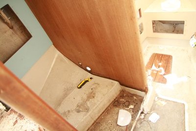

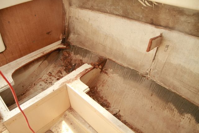

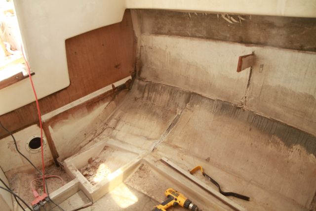

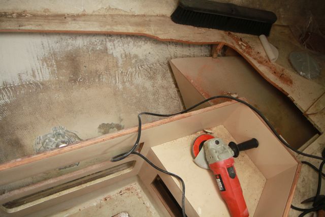

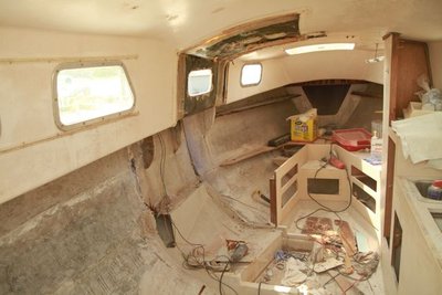

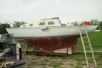

Thanks for the tutorial. first the boat:

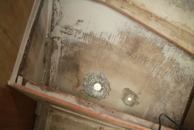

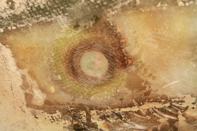

She's a bit rough but a good solid boat. I started by cutting away the v berth wood so i could patch her from the inside.
I then ground out both holes.
i did sand them flat later and ground out the smaller one more as well.
unfortunately right about then my generator refused to run so i turned to glassing the first hole as it was pretty well prepped. I taped wax paper over it from the outside and then a for sale sign to hold the shape, and then laid the first three layers of 1708 biax and waited for them to kick. more questions on what kick means later.

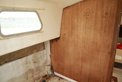

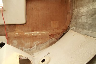

While i waited i figured i would go on to other areas of the boat. everything like lights and fixtures are shot so i have been removing them so i can refinish the bulkheads and paint lockers etc. Hre are some interior pics

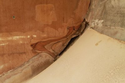

In addition to pulling the fixtures i have been pulling some items like seat backs to make it easier to paint and here is what i found.

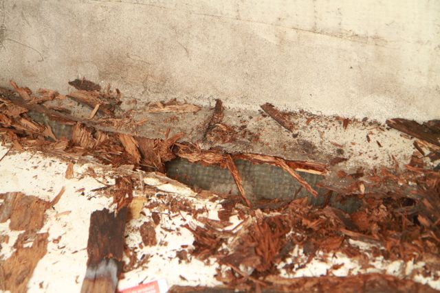

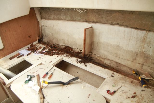

as i was pulling it up i found it by my prybar simply falling through the wood it was so rotten.
Most of this was still fastened with the original bronze screws. Man did they build this boat solid. I tried to pull them all out but some were so hidden and glased over ive been forced to simply cut or pry most out. Still is neat to see bronze screws though. Its a good thing im insanely small framed because i had to actually climb into the cockpit locker to pull out the screws holding in the dinette seat back and my bilge pump was in the way to. I spent about 45 minutes in the locker today. Not a pleasurable experience in case anyone was wondering. I highly recommend pulling out the hasp that locks the locker top btw. I read about how spurr spent a couple hours locked in a locker so i pulled mine off before i climbed in. That would suck given the temp today.
Anyway. gives me an excuse to open it up which will actually help out with painting the lockers.
Overall considering that the only thing rotten is the vertical dinette plywood im thinking im doing well. All of this wood is 45 years old!
I continue to be more impressed with bristol and i feel pretty lucky to have foudn as solid of a boat as I found.

So up until now most of my work has been as a mechanic. I was a helicopter mechanic and restored a couple cars and worked on a lot of motorcycles than i can count. So most of my theory on sailboats has been academic. I learned a lot today.
Mostly I learned i dont know what "kicked" means. I kept checking the mat but was unsure of when that was. I was thinking it was when it was hard but still sticky. I found sticky and i felt hard but never at the same time. I left it alone and figure i would lay ore later since i was unsure. So what does kicked mean? I was trying to figure out when to lay the next batch and came up short.
Also i have a newfound respect for this whole grinding thing. Man did that suck. pretty thick laminate though. Its 3/4 of an inch.
Also met a wonderful pair of folks that have a gorgeous bristol 29. Overall days dont get much better than today.

No pics today but i did get some stuff done, although not as much as id like since my generator refused to run today. I had plenty to do though and got lots of little jobs taken care of.
I got about 6 more layers of the biax on one of the holes. While it was hardening i scraped the last of the barnacles off of her, luckily that went pretty easy.

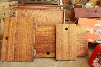

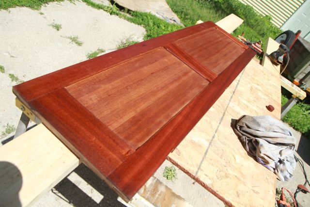

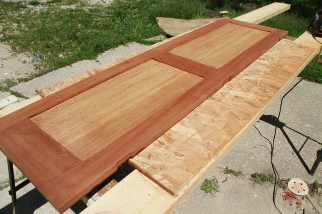

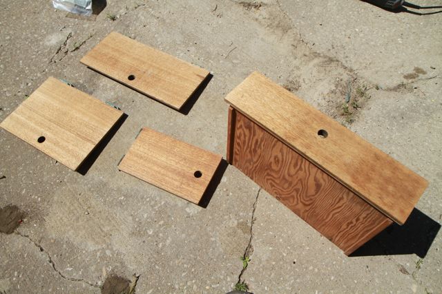

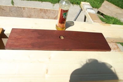

Another day of sanding. I had the door to the head, drawers, locker doors, and the compression post to work on today as well as the cockpit coamings.
I had already got most of the sanding on the door done and the cockpit coaming had been fairly well stirpped with 40 grit paper.
Here is what i started out with: I sanded them down with 120 and 220 grit paper and then i stained one drawer with mahogany which turned out way too dark so i just oiled the rest. You can see on the door and the post what i mean about having two types of wood. I think the insets are teak and the frame is mahogany maybe? same with the compression post?
The picture really warms it up. the next post picture shows it better.
Most of the boat is this lighter yellowish which i was told was teak.
this picture is close to the actual color but its a bit lighter in real life
Im not a huge fan of the coloring so everyone take a collective gasp and shudder, im going to stain it more to the posts color so i did a drawer in mahogany.
Its a bit too dark so i lemon oiled everything and picked up some cherry stain which i think will be the color i am looking for.

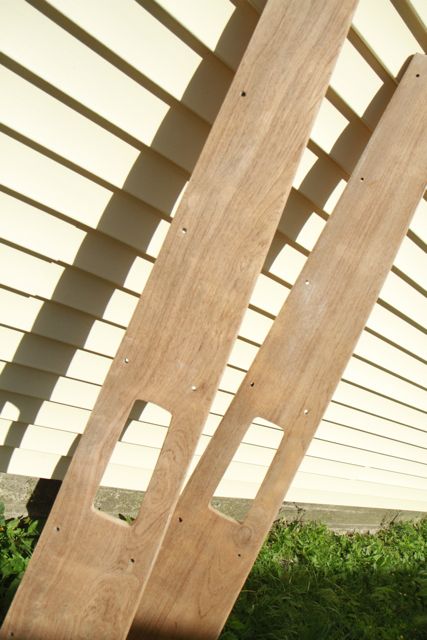

I also put barkeepers friend on my cocpkit coamings. i havent sanded beyond 40 grit yet, but after the treatment here they are.
its hard to see but their are still some lack of uniformity, but i was out of steam so i cleaned and went and went and saw my little helper.
Ill get back to the rest on sunday.

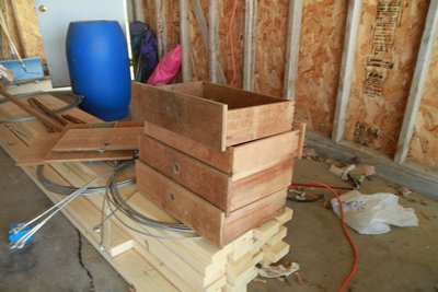

Another Three long days of sanding. I went back to the boat and took off the rest of the wood trim. It just keeps appearing, but i finally got it all out. I disassembled the step in to the boat as well and brought that home, the hatch boards and the board that holds them in. I brought the table home too.
I also disassembled the drawers and sanded, then stained the frames, and will be replacing the bottoms. the facings screw off so i took them off as well, just for ease of refinishing.
It took me about 6 hours thursday to get the hatch boards and bracket board sanded down and i got the cockpit coamings all through 220 grit paper.
I went to lowes but struck out on oxalic acid crystals so i might wind up ordering those online.
Today i sanded the rest of the trim pieces down and scuffed the laminate on the tabletop and the step so i can replace that. I also resanded the drawer facings and all the locker drawers from and back thru 220grit as well so hopefully the rough sanding on the wood is all done, other than the bulkheads of course.
I put about three coats of polyurethane on the compression post but made the mistake of shaking it on the last, which put air bubbles in it so i will have to sand it, which i would have anyway. Wont make that mistake again. I sanded each coat with 220 and after the next coat of poly i think i may go up to 400. Its already showing a mirror finish.
My door took one coat of the poly but it was so dry it just sucked it up and didnt show a gloss at all.
All in all things are coming along well. ill try to get some pics up later of my results.

so i tried to pull out the one board to replace the settee seat but still kept running into really solid build so it went from this
I figured since i was going to refinish them anyway, why do it in place. Of course now that i have all this out i figure might as well revert to my original plan and just get it redone.
So at this point i figure i might as well pull out the vberth as well and build in a water tank and make the bed flush with the bulk heads.
I was thinking i was going to place the battery box down low just forward of the bulkheads with the integral water tank behind that.
There was just a little bit of rot on the rear bulkhead so i ground it out to see how bad.
not too bad. i thought about scarfing in a piece but i think instead i will simply build up some layers of glass as i retab it to the hull.
This one shows the scope of it a bit better.
I Got the bulkheads home and managed to get them sanded, and overall they look pretty good. they are a bit scarred up so i will prolly go with the laminate.
I also spent probably two days grinding out the tabbing on the pieces and sanding down the hull.
Im not sure what to do with the tabbing. im going to tab in the bulkheads and just for ease i will epoxy the laminate to the wood.
My choices are to put the laminate on, leaving a 2 inch strip all the way around for the tabbing or laminate them all the way out and scrub a strip around the edges for the tabbing. Im leaning towards laminating the whole area since i will be epoxying them on and then scrubbing the edges so the tabbing will epoxy on. it should be a strong tabbing since the laminate is epoxied as well yes?
