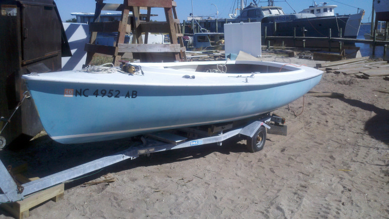

Snagged a small piece of plastic classic... A baby blue 1967 Tanzer 16.

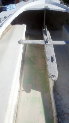

The coring in the hull is bad, so today I ground out the 9 foot x 14 inch wide piece of balsa wood that a previous owner had glassed in place on the port side. Don't know what goop was used to bond it to the hull, but it came up without much fuss... the goop on the other hand was still tacky, but didn't smell like polyester or epoxy. Mystery goooo!
Ground out all the tabbing and such, cut out a piece of 3/4 divinycell and started getting geared up to put it back together. I glassed in a piece of 8 inch tabbing to support the centerboard trunk and the keel.

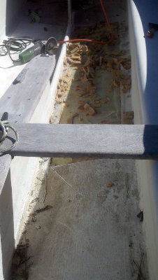

I finished grinding out the old balsa and glass that a previous owner put in...

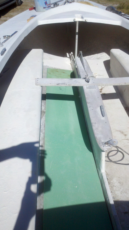

I laid in a 10 foot long 14 inch wide piece of divinycell, beveling the outboard edge so the glass laid down nicely. I glassed over it with copoxy and 1708. Finished it up with some System Three quick fair.

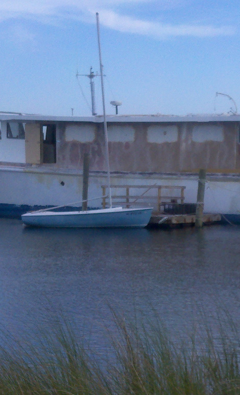

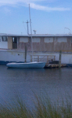

Leah and I put her overboard, and went out for a sail.
