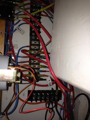

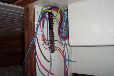

Just got back from a full day on the boat. The first few hours were spent sanding the hull. Boring but it is finally coming to an end. One more coat of filler, hopefully the last. Then I sanded parts of the interior. The old varnish is tuff to get off but i am making progress. Then I worked on some fun stuff! I have been working on the electrical system. Here is a picture of the busbar panels
Busbar panel
Busbar panel
I only have three of the six busbars attached. The two on the left go to the AC system while the ones to the right will be the DC groups. When finished the whole area will be painted white for better visibility.

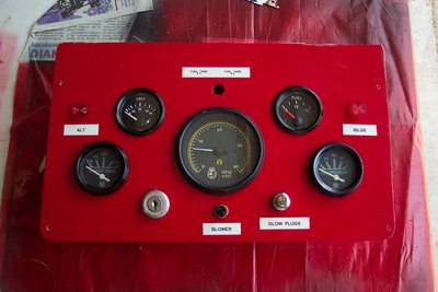

Electrical panel
Electrical panel
I have followed the advice given on this web site and have added a 3/4 picture frame to mount the actual panel on. This gives me more clearance and should make for a neater installation.

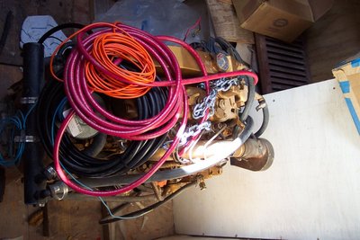

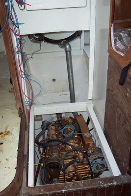

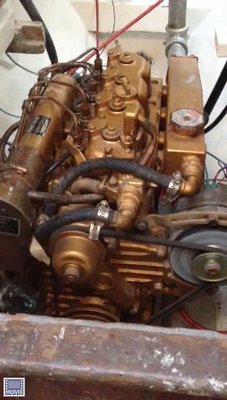

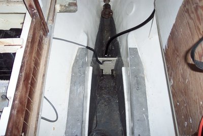

It has been a long time since my last entry. Many things have happened since last August. I painted the cabin trunk top, but before it dried it rained. Total ruin! I have since sanded it all off, and am waiting for a weather window before I attempt it again. I have had my engine placed in to the boat.
The engine is finally in its place.
I now need to measure the shaft and have it machined. I have also been working on my new main hatch. When I purchased the boat the PO had built a dognouse that looked more like an outhouse. If you look at the picture below you can see the doghouse behind the dingy. It was ugly.

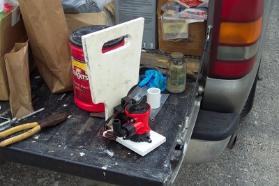

When building this panel I was looking for a material that would not rust or corrode. I decided to build my own. This panel is actually a piece of cardboard soaked in CPES. I then put one layer of glass cloth on and faired. The result is amazingly strong, lightwieght, amd stiff. It was really an experiment; but, the result worked so well I decided to use it.
Re: The Christina Louise
Posted: Wed May 29, 2013 7:48 am
by earlylight
Clever idea for fabricating the panel. How heavy was the cardboard you used? I will be interested in how well it holds up. Please keep us posted.

New Dash
New Dash
. I am painting all of the control panels red. I like the contrast and visibility. I was worried that the cubby hole built so long ago would not allow good visibility while driving the boat. I think it is okay, I like the fact it is basically out of the way. I have thought of placing a plexiglass door over it, but have not decided as of yet.
Good visibility

Placing the primary bilge pump was the next task. I built a mounting bracket that would allow me to reach into the deep bilge to make any repairs. It is made of starboard plastic.
Bilge pump on mounting bracket
I epoxied wood in the bilge to form grooves for this assembly to sit in. You have to reach through a panel in the quarter berth to access this part of the bilge. From the quarter berth to the bottom is about 3 1/2 ft.
Way down in there
Way down in there
This is only one of three bilge pumps to be located in this area. This one is a Johnson 500 gph. I have a Johnson 2000 gph that will be mounted approx. four feet forwad of this location. It will also be about 8" higher I also have an Edson manual bilge pump that will have a strum box located directly adjacent to the smaller pump. This thing came with the boat and is massive. It supposedly moves a gallon with each stroke. I have also been working on the cockpit drains. Not sure if I like this yet.

Wow, lots of progress. I really like that starboard removable bilge pump mount and that engine panel looks great. Keep up the fine work!
Posted: Mon Jun 10, 2013 9:53 pm
by Crazer
Looking great, really love that engine panel. I might have to do something like that on my boat. Is it lighted in any way? I need to somehow light the engine panel on my boat, as I tend to stay out past sunset. There's always another thing to do, that's true whether you're installing an engine or just painting the galley counter, as I discovered!

Most engine instruments have provisions for lighting. Check the back of each instrument and see if there is a small hole (roughly 1/2 in diameter) that a lamp socket snaps into.

Today I got the engine put in the engine room. The heat index was over a 100 degrees today. It made for slow going. I finished the installation of the ingine mounts and wired the dash. I also attached all the wires to the engine before placing it in the engine room.
The engine room before installation
I next wired the engine because the connections will be difficult to get to when installed .
All wired
All wired
I used a come-a-long to hoist the engine and place it into the bilge. It took quite some time because I was working alone. The engine had to pused back almost 2 feet past the lift point. I used 2 x 4's as cribbing on the front of the engine to pus it back. Finally it was in. Fantastic! I am a happy man.
Finally
Finally

Yesterday was another hot day at the boat. I continued my work on the engine. There was a problem getting to the forward bolts on the rear motor mounts. The oil pan sets below the nuts and you could not get a wrench in to hold the backup. I attempted to bend a Craftman 3/4 combination wrench without heating it. One large cheater bar later it broke in two pieces. Luckily for me the short piece fit right into the hole made for the nut. When turned it wedged against the side and held perfectly. The result was a very tight bolt, it wasn't very pretty in getting there. I wonder if Sears will replace that wrench? The next task was to construct the riser for the muffler. The engine sits completely below the water line in this boat. The muffler has to reach above the water line. I am building this out of galvanized pipe. Originally I was going to use stainless, but galvanize is much cheaper and should last a couple of years in the salt water environment. With exhaust gases and water I am not sure stainless would last much longer and be worth the cost.
You can see the risor in the back
I will weld the water injection into a short nipple and attach on the downside of the risor. Everything showing will have to wrapped in insulation. The rest of the system will be rubber hose going to and leaving the water muffler. I also worked on the wiring. All of the battery connections were made for the motor. I began to bring all other motor connections to an area above the engine and close to the instrument panel.
engine wiring and dash wire meet here
I am trying hard to avoid the rats nest this boat had when I got it. I am labeling everything. I was thinking of adding a port in order to service the water pump in front of the engine. However, it currently has nine inches of clearance to the bulkhead from the pump cover. I hope this is enough.

I would think 9 inches would be more than enough I wish there was 9 inches clearance to the raw water pump cover on my Westerbeke 27.

The dog days of summer are definitely here. It has been above 95 every day for the last month. Despite the heat I have been making progress. The engine is running! It took longer than I thought it would, but that seems to be par for the course. I have a video but can only upload a picture. Note the alternator fan, its a blur.
This is a running engine.
