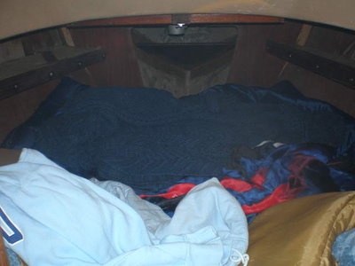

Here are a few pick of my V-berth from before and as of today. I am going to make it more habitable as the wife would say. I am also going to remove the watertake cover, clean and inspect the tank the tank.
before.....
before.....
this is the top of the tank...can only imagine whats inside!
Any and all ideas and pics would be helpful of what you have done to your v-berth. I am going to add a cover to the chain locker, LED lights and fresh paint. I am thinking of adding boards "slats" to the stringers on the lower portion of the v-berth that is common on alot of boats i see. I am also going to add a foot water pump to the water tank plumbing. I will keep you posted on the progress.

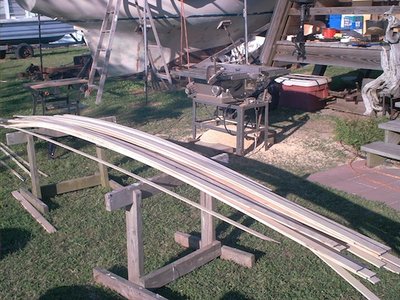

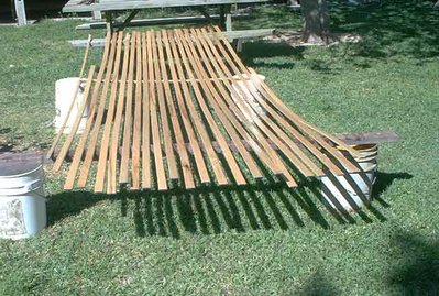

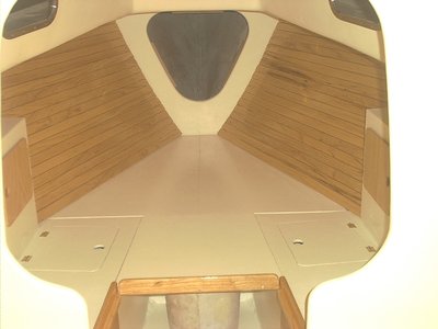

by Rachel

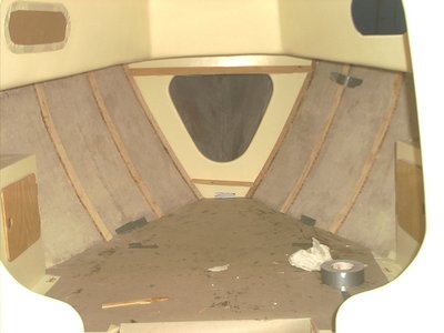

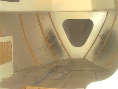

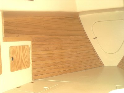

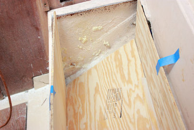

[Edited to improve/add photos]
Here are a couple of photos showing the ash ceiling on CharlieJ's "Tehani," which is a 25' CCA-type design. The strips are fairly thin (they re-sawed them), but not overly so. You can't see anything exact in these photos, but they give some idea of the overall scale/thickness:
Cutting ceiling strips
Varnished strip stock
Originally the hullsides in the v-berth were just painted fiberglass. The cleats are 1/2" ply, kerfed on the outboard side and set in thickened epoxy (the paint was ground off in preparation). The insulation is 1/2" polyisocyanurate, friction fit.
A couple of notes:
1) As you can see, these strips were run parallel to the berth flat. Another way is to run them parallel with the deck.
2) You can just see a pair of lockers port and starboard at the after ends of the berth. These were added (and not quite finished here; they later got fiddles, etc.) and created quite a bit of stowage.
1/2" ply cleats installed
Insulated
Insulated
Ash ceiling
Ash ceiling
Ash ceiling detail
Ash ceiling detail

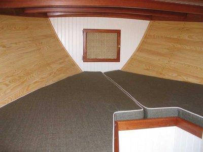

Re: V-berth & watertank refurbish
Posted: Sat Nov 19, 2011 9:39 am
by earlylight
Ash and Cypress are commonly used woods for hull ceilings. I used satinwood primarily because a friend had a large supply and it looks very similar to cypress when varnished.
Here is a pic of satinwood ceilings installed aboard Early Light.
Satinwood hull ceilings in V-berth
I have documented the v-berth hull ceiling project on my website at http://earlylight160.110mb.com/HullCeilings.html
I also added ceilings in the salon book shelves and locker spaces. This project is documented at http://earlylight160.110mb.com/HullCeilingsSalon.html
I hope this is helpful.

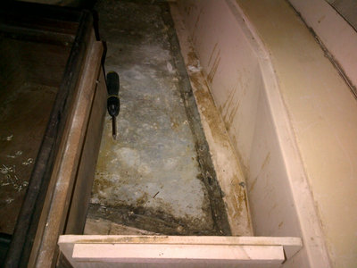

Well, I got the wood work loose and put forward. i then drilled the rivets in tank cover and got the tank lid off. it was not nice in there, black mold, dirt and the underside of the aluminum lid was just horrible, severely corroded
wood work removed
wood work removed
Yuck!
Yuck!
I have the tank lid in the truck, i will take a pic and post it tomorrow. Now i need a new lid and possibly a pick up assembly. where to get a piece os starboad large enough, has to be 42"x36"x 1/4" min.

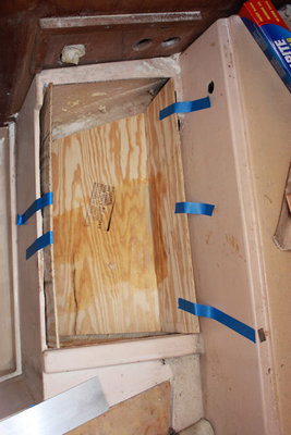

I have made some progress this past week. I got the old tank lid stripped down and removed all the old fitting. I will reuse them in my new lid. i went and bought my first gallon of west system. I got the new lid cut out of 1/4" plywood and got one side epoxy coated. I removed and sanded some of the wood trim from the v-berth. my intention was to replace it but after some sanding it is cleaning up quite nicely. I have some pics and i will upload later this evening.
Posted: Sat Nov 26, 2011 10:38 pm
by Cruiser2B
Nasty old lid top side with pickup still installed
even nastier bottom, completely corroded.....i dont think a little bleach would have cleaned this up!
new lid...ah yes...the proper tools! :)
bottom side of new lid, with a single coat of epoxy
I plan on about 5 layers of epoxy with 2 layer of fiberglass 6oz cloth on the bottom and the same for the top with the exception of only one layer of fiberglass. I am also going to glass edges all the way around with some 4" fg tape. I am not sure if this is correct, so place let me know if you would cover this plywood lid differently.
BTW took a bolt out of forward chainplate knees and wood seems solid. i poked around in there pretty good. i happy to see no corrosion on bolts themselves. they looked nasty from outside, but once removed looked small...but ok. i think my plan is to do lower shroud chainplates first then do the uppers while mast is still up. then remove mast and redo rigging. this way mast does not have to stay off long. I am going to order chainplate material this week. 1 1/2" x 1/4" 316 stainless.

initial pieces being fitted
epoxied it in place(not to the hull) so I could get the proper angles. I will build the rest on the bench. More pics to follow

by seasailor55
Cape Dory 22's (another Alberg design) have ash ceilings, with satin finish varnish. Very nice and classy.
There's a 15 gallon water tank under the v-berth.

by Cruiser2B
Did some mor fitting today, tank is coming along well. I bought a few bulkhead 1 1/2 fitting to go thru the lid, this will allow me to use pluming elbows for in/out of the tank. I will post pics tomorrow.
