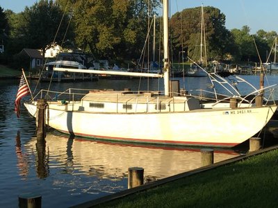

I was given a Grampian Classic 31 here in Annapolis. It's a lovely boat, but she needs some help. I've had her hauled in Arnold at Ferry Point Marina. She needs repairs to her mast, some deck repairs and a lot of cleaning. We've knocked out some of the cleaning but we're waiting for warmer weather to deal with the deck issues and some blisters in the hull.
She also has an original Atomic 4 that I'm working on resurrecting. A compression test will tell me whether or not it can be saved.

Thanks! I'd never heard of the boat before I saw the ad on Craigslist. She's in startlingly good shape on the inside, just covered in mildew. The gelcoat on the exterior is all shot but that isn't an urgent problem. I'm very excited about her! I'll try to keep things updated here and hopefully we can breathe new life into this forum!

CapnK: Some number of boats were built with the full width cabin trunk and some were built like mine with the more conventional arrangement. All boats were built of glass and I'm not sure how many of each were built, or even how many boats were built total.

Not much going on right now. Waiting for this idiotically cold weather to break. I did manage to compression test the engine and diagnose some stuck valves. After freeing them, got 60-75-90-105 on the four cylinders which went up to 120-90-90-105 with some MMO added. Hopefully the rings will loosen after the engine runs a bit. Otherwise just waiting on spring to start fixing the hull blisters and soft spots on deck.

The mast has a ~3" crack at the base from corrosion around the mast step. The step fitting is riveted into the bottom of the mast and as the aluminum expanded from corrosion the mast cracked. I'll cut the mast down and build a new step to make up the difference.

Unfortunately I have to report that this project did not end well. As I dug further into the boat I discovered more and more issues. The blisters in particular were so severe that they went through multiple layers of fiberglass. The decks we totally shot. It looked increasingly likely that the engine could not be saved-there was water in the oil and the compression was poor. So I sadly made the decision to dispose of the boat. I tried to give her away but no one who had the resources took her (understandably) and I didn't want to leave her at the yard in the hands of someone who would end up abandoning her. I did buy another boat, a Rhodes Swiftsure 33.
