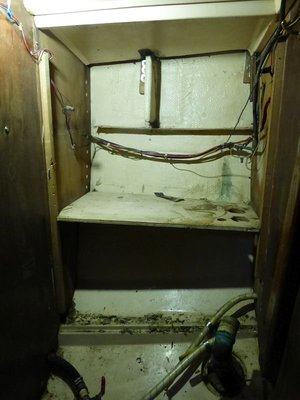

Standard head layout, used to have an ElectroSan head which I removed as my very first project on this boat. :)
Pre-de-construct.
Pre-de-construct.
