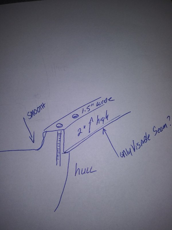

Appears in this video that you deck is flush to the edge?.. My Alberg 30 has a raised glass lip about 2" high which the hull top is bolted to the hull. My teak cap rail sat on top of this 2" high x 1.5" wide lip. Only seam to show on this seems to be on the outer hull side. I need to take a picture of it an post it. Don't think that the aluminum rail you used would fit well... Teak cap was on top of this so total height was about 3.5"

Apparently you have a late model A30 with fiberglass toe rail and thin teak cap rail on top of that. The early models have a flush fiberglass deck with about a 2" teak toe rail. Since your signature says your boat is a 1968 I assumed you had the early model, which is the type I fit the aluminum toe rail on. But I also replaced the teak cap on the late model A30 with new teak and the lip on the outside edge of the deck was not 2" as noted in your sketch. The lip was only 1/4" high and no reason the lip of the aluminum toe rail would not fit over it after I filled it in with thickened epoxy. There's not much more I can add but if you want to clarify this you can PM me with your phone number.
Edit: I see the 2807 model toe rail I used has an inside width of 1.75" which should work and only overhang the inside fiberglass toe rail by 1/8" but I see they only list it now in 24' lengths rather than the 31' I got a few years ago. You can contact them for a recommendation or look at other options here:
