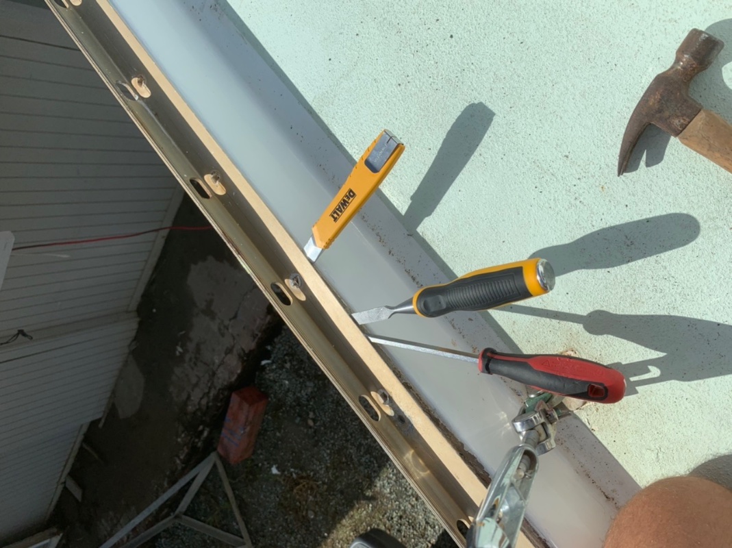

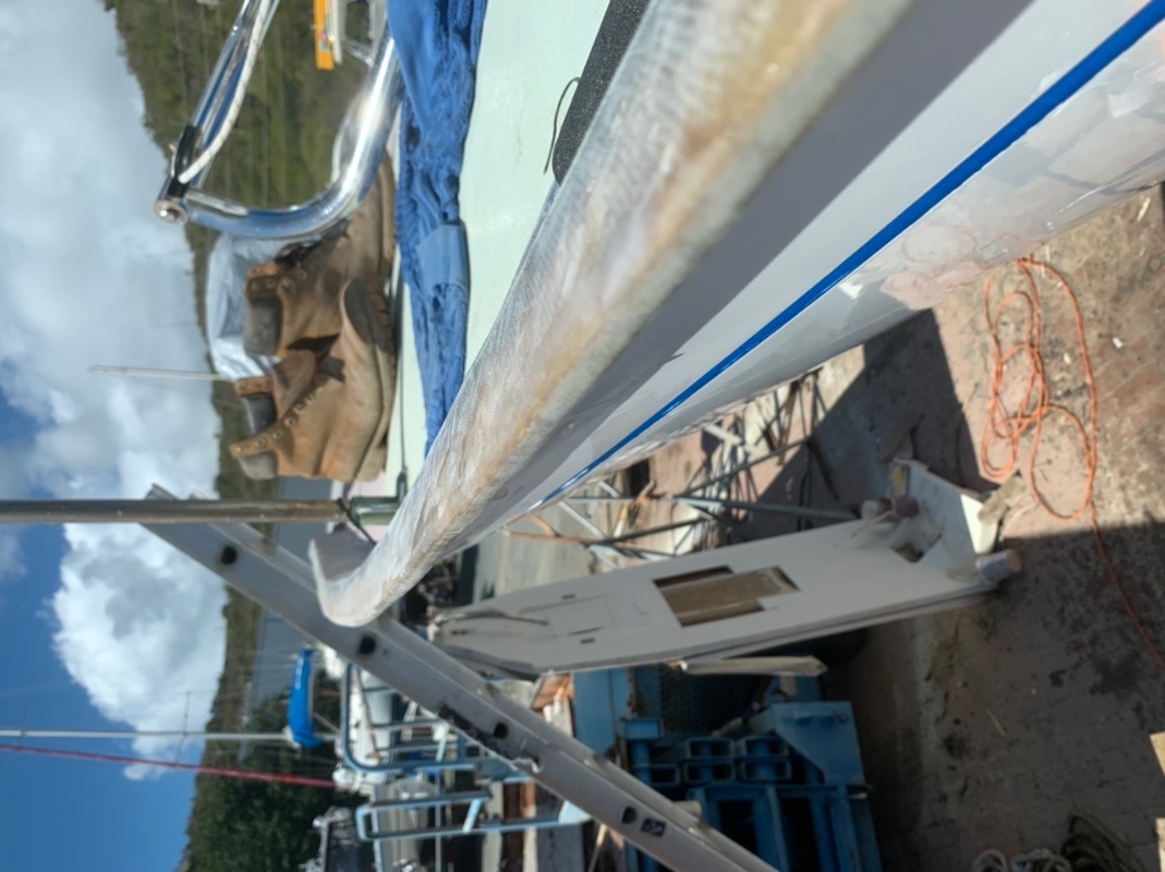

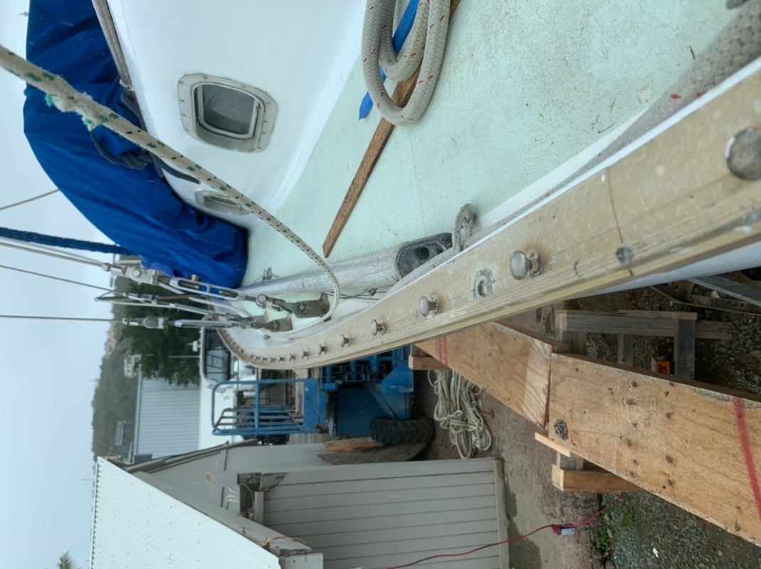

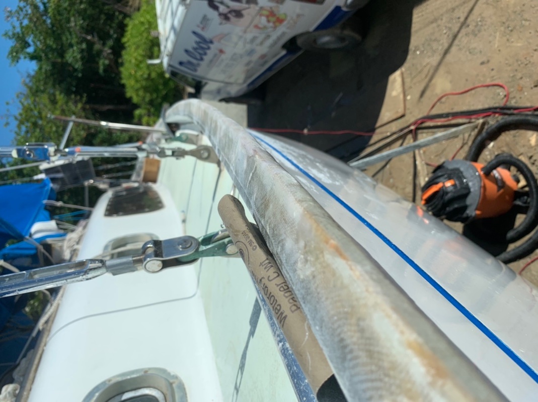

Using a hammer, 1/2” wide chisel, 1/4” wide flathead screw driver, and a long/sturdy razor knife, I begin prying and cutting the sealant underneath the aluminum extrusion.
For those wondering, I was indeed able to prevent any bending or kinking of the metal while prying.
I found it best to start with the chisel and hammer it in about 3/4 of the way underneath the rail. Cut any sealant between the underside of the rail and the top of the flange. Then hammer in the 1/4” flathead right behind the chisel. Pull the chisel out , move down about 6”, and repeat the process.

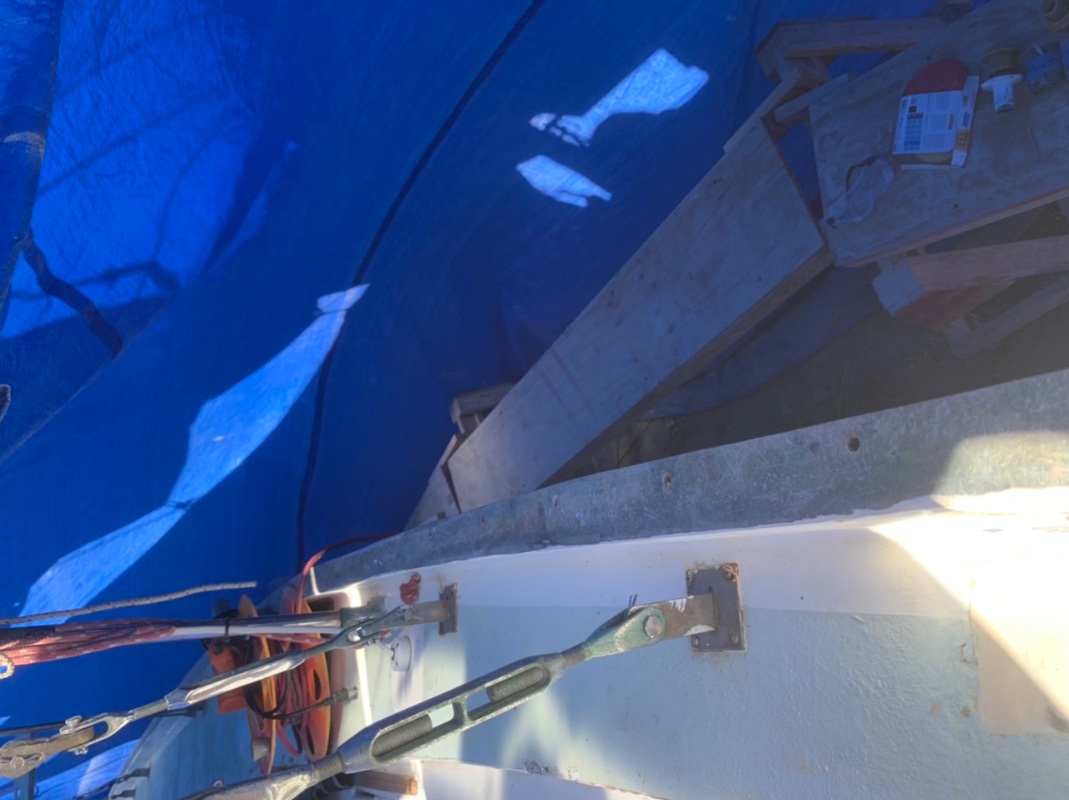

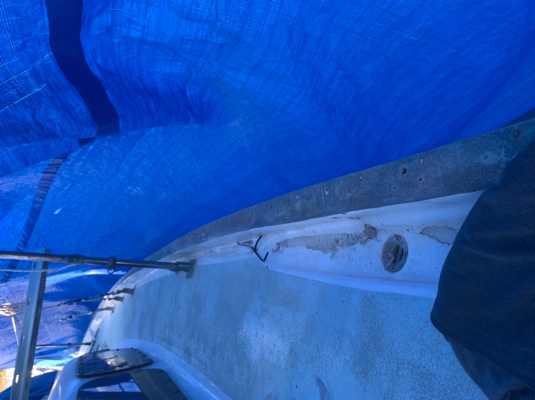

After removing the toe rails and all of the sealant I think it may not be necessary to fiberglass over the hull/deck joint. Everything looks in tact, with a few small sections that could use some filling.
The fastest way to remove the sealant was using a grinder with a 40 grit sanding disc. I smoothed out the entire length of flange with 80 grit on a DA. The surface is now prepared for repairs or priming.

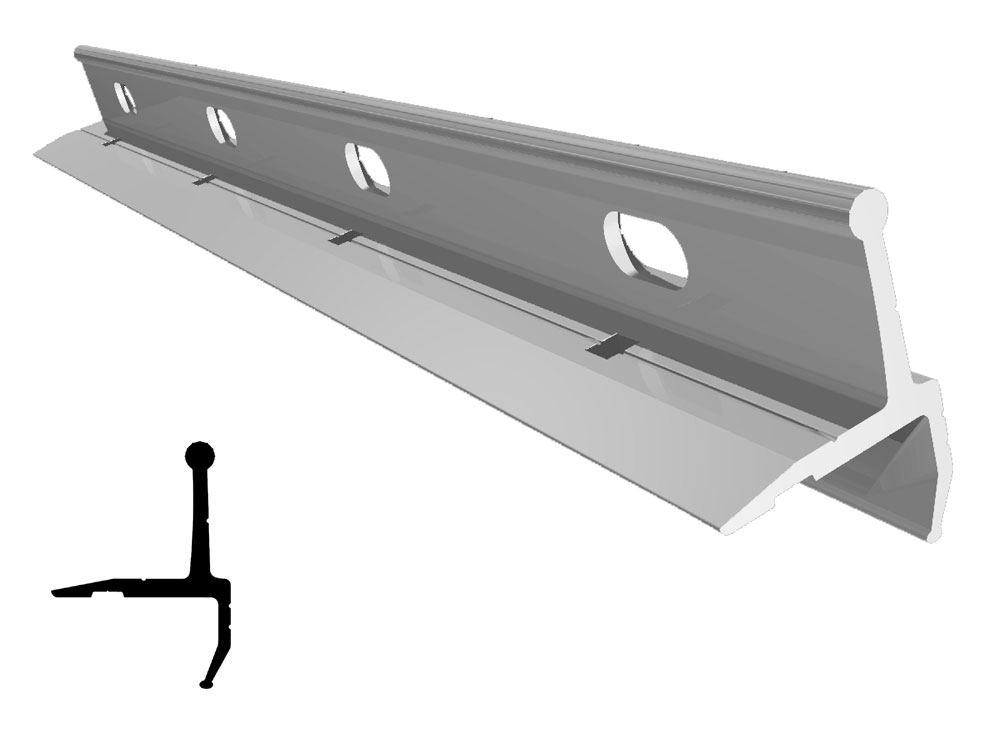

In order to ensure the holes are drilled far enough away from the hull, (if they are drilled too close, the washers/nuts will not seat flush to the underbody of the joint) I will need to glue a piece of neoprene rubber padding along the inside of the new aluminum toe rail. This will ensure the new holes are drilled at equal distances from the edge of the joint. Unfortunately I don’t have a good picture of the joint profile but maybe the sketch of the toe rail design would help.

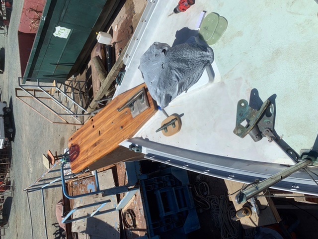

After fiberglassing the entire flange, I prepared the flange and hull for awlgrip primer and paint.
After spraying 2 coats of 545 finish primer and 3 coats of Snow White topcoat, I was ready to prepare the new toe rails for fitting and preliminary fastening.

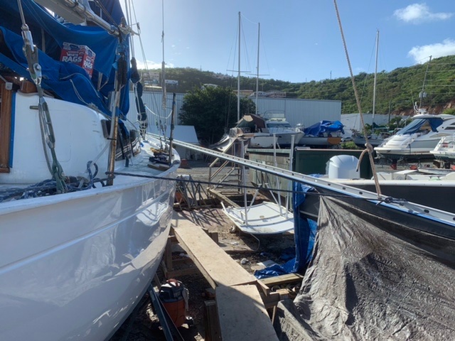

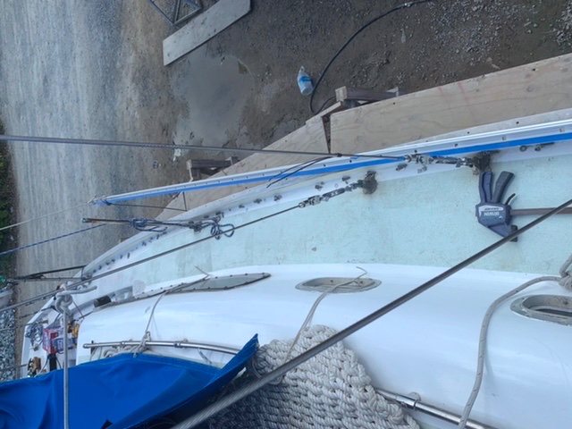

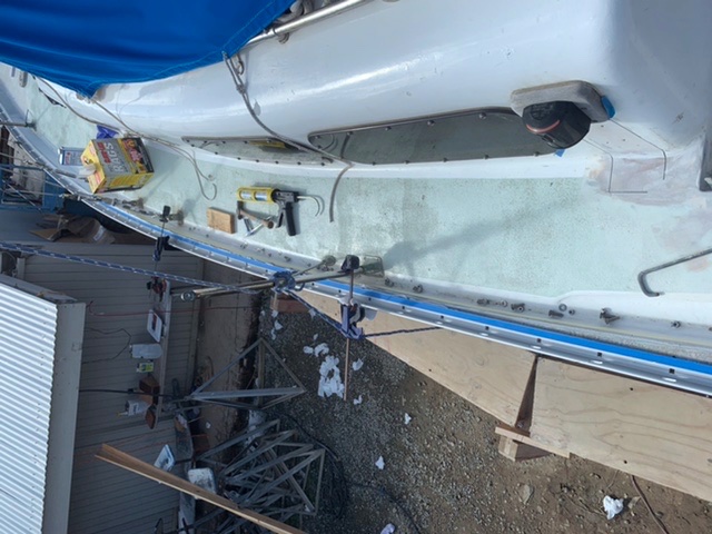

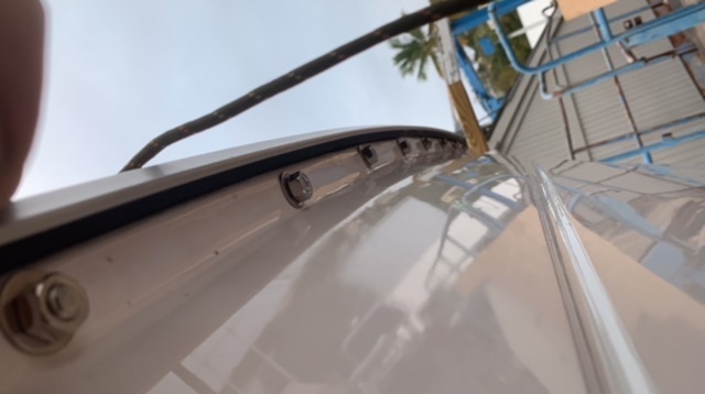

As mentioned in one of my previous posts, it was necessary to glue a neoprene spacer on the inside of the toe rail to ensure the bolts would go through the center of the flange (longitudinally centered). I used contact cement to glue the neoprene to the aluminum. I did some testing and found that adhesion was best when sanding the aluminum lightly with 220 grit and sanding the neoprene with 80 grit.
When the contact cement fully cured, I began dry fitting the rail.
I used the mizzen halyard to support the aft end of the rail and another line attached to the stern cleat to bend the rail inward.
Once the rail was fitted, I pulled the rail back off and began applying 5200 on the top of the hull/deck joint. (I also sanded the top of the flange so the 5200 had something to grab onto). I applied 5200 in approximately 8 foot sections at a time.
