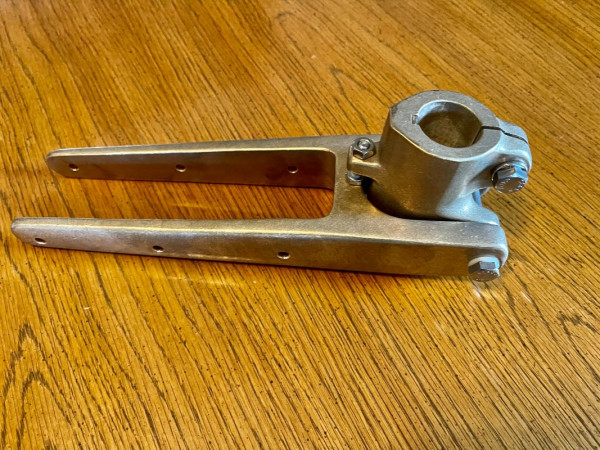

Nice modifications. Can you post some more pics of the wheel to tiller conversion. How does the tiller tie into the rudder post? Very interested in following along as you continue the mods.

The tiller connects directly to the rudder post with a bronze tiller head fitting. We ordered the fitting from Edson Marine. Also, we had a steel key made for the key way by a local machining shop. Getting the final fit right for the key was one of the trickiest parts of the installation, but it's worked out nicely. We created an initial tiller from laminated plywood for test purposes, and I'll keep it onboard as a spare. We've tested the tiller already, and it works like a charm. To me, it provides a more direct and intuitive feel for the rudder and steering action than the wheel that was installed before. Our last step is to craft the final tiller, likely from mahogany. I've included a few photos below.

Thanks for the update and details. The conversion looks great. I wasn't sure if the tiller steering tied into the existing steering quadrant somehow. Glad to know it bolts directly to the rudder post.
