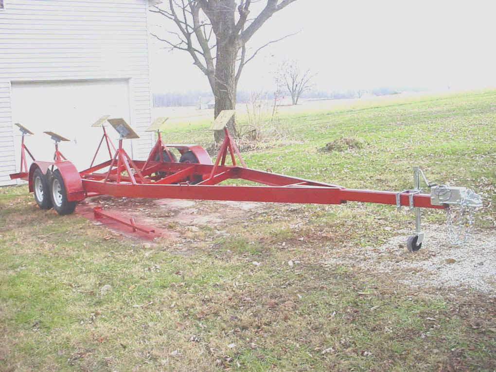

You might think about putting your axles on a angle iron bracket that can be bolted to the frame, and slide up or back for adjustment. I built my trailer that way, and drilled evenly spaced holes in the brackets and frame to allow me to move the axles. I also attached the fenders to the angle braket so they would move to. You need to allow slack in the brake lines for this.Dharma wrote:Does anyone know where is center of gravity of an empty (no fuel, no water, no engine) A30? I'm designing a new trailer for Dharma and I would like to calculate where to put the axles...
