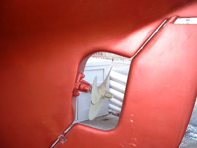

Sounds like you probably don't need one, but just as a data point if you decide to add one at some point: On my A-30 I (perhaps unnecessarily as it sounds now) put on a new zinc that was part of the prop nut system. I don't have a photo with it installed, but here's one showing the general fit of things when I first got the boat, so you can see how it compares to yours. I could dig up the zinc info if you did want it (I know I tried a couple of different ones for the best fit).

As Rachel noted, you can buy the nut-mounted zinc. It requires a special prop nut which is sort of castellated and extends out past the end of the shaft, and has a threaded hole to receive the zinc. The buullet-shaped zincs are readily available in at least two sizes. My observation on Quetzal's during my recent spring horrorshow of a fitout (documented elsewhere on this site), was that this kind of zinc is electrically more remote (more joints) from the boat and my stainless shaft end was badly corroded. The bronze nut and propeller were fine. I put it all back together with an annular zinc bolted to the prop shaft between the stern fitting and propeller, a nice and direct connection.
When we bought the boat in 2004, there were two zincs in addition to the propshaft zinc. These were hull-mounted and teardrop shaped. They had been screwed to the hull with wood screws. The reason that they were uncorroded was that they were not attached to any of the metal in the boat. Such zincs would be functional if they were through-bolted to a connection and wire leading to the engine. Clearly, some thought should be given to how easy or difficult changing them would be; mine would have been a bear, way down in the skeg.
