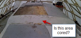

Hi all,
A few questions came up this weekend when I started cutting the top skin off the cabin top in preparation for my re-core project. With all the knowledge here, I am guessing these are fairly common questions (I did do a search, but didn't find what I needed).
Anyway, here goes (I've posted pictures on http://www.alberg35.com for reference):
1. Using my cordless circular saw, I cut out roughly a 4'x4' section (in 3 pieces) on the upper cabin top just in front of the companionway hatch. The skin came off quite easily but I found that about 1/3 of the core appeared to be in good shape with no water intrusion. I was able to easily dig out the majority of the rotten core with a wide chisel, but the 'good' core held on pretty tenaciously. I decided to leave the good core in place for now until I got some advice as to whether I should just leave it and epoxy in new material around it or if it makes more sense to get rid of all of it and start with a clean slate... Any thoughts on this?
2. I know that the cabin top sides are solid, but I'm not sure if the angled section between the upper and lower cabin top is cored (I believe Triton's have opening ports set into this area). I can drill some test holes to see what lives in there, but does anyone know if this section is cored?
3. I need to shore up the inside skin with a support framework so the new core doesn't sag when I weight down the new core material when laying up, but I was surprised how flexible the whole section was. I am now wondering if I should be cutting off the skin in smaller pieces or should I do it all at once? My initial plan was to do the entire cabin top (both the higher and lower sections) and recore that at once, but given the flimsiness of the remaining bottom skin, should I just do one small area at a time?

Yes, shore carefully. You'll be working out on this weak surface. Cut less at a time, unless you shore adequately. Do one area at a time. The deck maintains the shape of the boat. Adjoining areas of deck hold the shape of partly demolished deck.
Drill exploratory holes from the side you're working from to determine whether you've got core. You may be able to see it from below, though. You'd see the inside laminate dip towards the outside laminate.
Removing the balsa is easy with an angle grinder and 36 grit disc. Don't loose concentration and go through the inner lamina.

Once you've opened the area, just remove all the core and start fresh. In other areas, you might try a series of 1/2" test holes to determine the core's condition before you open up a large area, if you don't want to do the entire area. Wide chisels and 5-in-1 tools are good for digging out existing core, which can indeed be incredibly tenacious in its grip even with 1960s adhesion technology.
The semi-vertical transitional area between the two sections of your coachroof is almost certainly not cored, but stranger things have happened. Usually, deck coring exists only in horizontal areas, not vertical, but of course there are plenty of exceptions. I'd be quite surprised if you found core in the doghouse bump, though.
You should build your support structure before you remove top skin and core over large areas, not after. The inner skin tends to be extremely thin and will change shape unless you build the support first. So in other words, build your support structure now, before you continue work at all on the coachroof. The boat's not going to fall apart if you don't, but you're certain to lose the designed shape of the coachroof if you don't build the structure.

Tim wrote:Once you've opened the area, just remove all the core and start fresh. In other areas, you might try a series of 1/2" test holes to determine the core's condition before you open up a large area, if you don't want to do the entire area. Wide chisels and 5-in-1 tools are good for digging out existing core, which can indeed be incredibly tenacious in its grip even with 1960s adhesion technology.
I kind of figured this would be the best approach, but thought I'd ask anyway.
Tim wrote:The semi-vertical transitional area between the two sections of your coachroof is almost certainly not cored, but stranger things have happened. Usually, deck coring exists only in horizontal areas, not vertical, but of course there are plenty of exceptions. I'd be quite surprised if you found core in the doghouse bump, though.
I'll try a few test cores to make sure, I hope there isn't any core in there.
Tim wrote:You should build your support structure before you remove top skin and core over large areas, not after. The inner skin tends to be extremely thin and will change shape unless you build the support first. So in other words, build your support structure now, before you continue work at all on the coachroof. The boat's not going to fall apart if you don't, but you're certain to lose the designed shape of the coachroof if you don't build the structure.
I guess I know what my next task is going to be... I'm glad my cordless saw battery ran out of juice when it did or I might have taken the whole thing off.

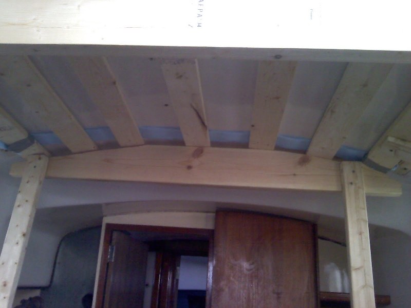

Despite the nasty cold this weekend, I managed to get the support structure built and in place. Now I can stand on the area where I pulled the core out with only minor deflection (from gap between headliner and bottom skin). I also added some padding (thanks for the suggestion) so I didn't crack the headliner.
Here's a bad picture:
