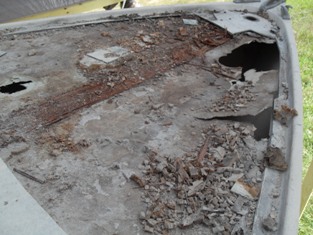

This is what happend to me when I was taking off the top skin on deck. Don't laugh at this photo people, this was when I had no clue of what I was doing. Most of my deck was rotted; however, in a few spots there was no rot and look what happend, ripped off the bottom skin, so, I decided to work from inside the galley, I decided to tear off the entire bottom skin to remove the rotted balsa core, had to ripp out the old bulkheads, alot of people told me that is was a difficult procedure, but I still made it through with determination, I cut away the entire bottom skin with an angle grinder and a universal cutting wheel and removed the entire balsa core with a heavy hammer and a heavy chizzle, I now have a beautiful top deck with some pretty expensive core material, and my new deck looks really good, I used floor jacks and shims to get back to shape, the core material I used was stuff that when heat was applied to it, it would conform to the shape, so I know there aren't any voids, its sealed up pretty tight now. I used sheets of paper to outline from the top deck before I actually was cutting the shapes of the expensive core material, I applied the matting on top of the new core material and put into place and floorjacked it up. Sounds pretty confusing, but there are alot of ways to skin a cat. My motto is, just do it. I was unfamiliar with this territory as well, but after doing this, I feel like a veteran now. I also had the help of a 30 year boat builder veteran who gave me tips on this, and would come out to check on my work, good man he is.
- SDC10601.JPG (52.58 KiB) Viewed 5761 times
