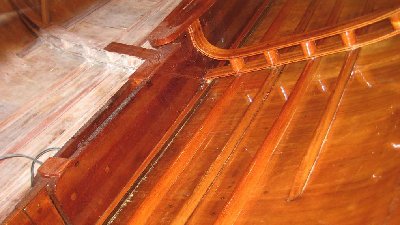

When adding hull ceilings to my Sabre I used Satinwood (a very hard wood). To resaw it, I used a "resaw blade" on my band saw. I found that feeding it slow seemed to work fairly well. I was trying to resaw to approx 1/4 inch thickness but found that I had to cut to a tad over 5/16 inch and then run the resawn strips through a surface planer to get the 1/4 inch I needed. Good luck.
