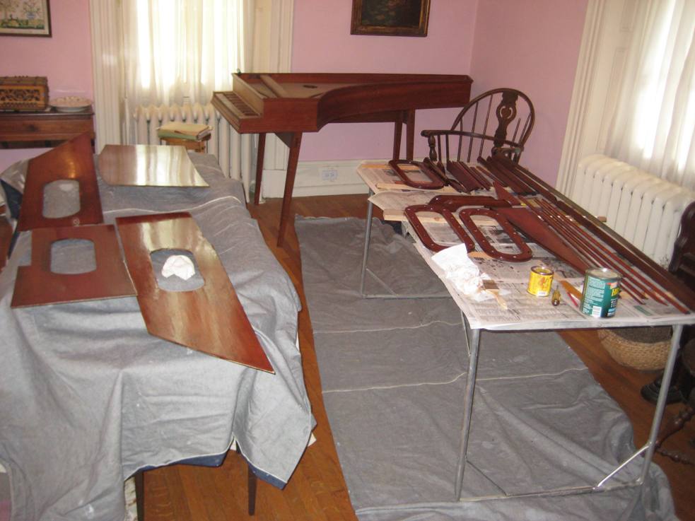

Big decision du jour, and I mean today, is whether I stain the sun-bleached wood components to bring them back closer to the natural deep red that the Makore was when new.

Stained...
and urethaned. One more coat., then reassembly. Bung question still hanging; I'm planning to buy the counterbore/drill combo with the right size drill to center and clean out the bores; the catch is that the bores are probably already a bit over 1/2". I disliked seeing the glueline before, and I don't want to see it anew.
