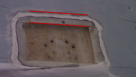

Re: Layup schedule question
I wasn't sure whether to put this in your "Finally moving forward" thread or this one, but since the title of this one sounded more appropos, I chose this one.
I was perusing your blog (which is great, by the way - thanks!) and reading about your re-coring, and as I looked at the photos a question came to mind. What I'm wondering is if the ground down areas on the old skin (where you are overlapping with the new skin) are wide enough (?). They just looked a little narrow to my eye, but then, my eye is amateurish and may easily be all wrong. The other thing is that I can't tell if it is just the white "ring" around the repair areas that is your ground-back taper, or if the adjoining tan areas are also fiberglass that has been tapered or core material (if the latter is the case then they look plenty wide).
I'd like to have a better feel for how much taper is right, is one reason why I'm asking.

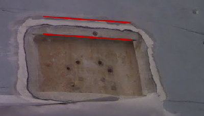

Looking at the picture, it does look a little thin and it may be but most of the tapers I cut are roughly 1.5 inches (I think that should be adequate). The picture makes it hard to see where the taper ends, it appears that the white area is the taper, but that is just the gelcoat (or whatever the top finish was). Attached is a better picture to show the entire taper (the red delineates the taper).
Serious repairer sources (PBB, for example) say match the original layup. The taper varies with the fiber and the resin. I recall as little as 1:8 for ordinary polyester/glass, on up to 1:30(and more?) for scrimped epoxy/carbon parts - beyond most of our capabilities or needs. I meet or exceed the amount (total thickness) of original glass fiber, since I'm not usually doing 'serious' repairs, and I don't normally have the original weights of cloth or roving on hand.
Aha, so some of the "tan" is part of the taper too. Do you ever look at something and see it one way and then it's hard to make your eyes see it another way? That's what happened to me with your tapers. I first saw them as just the grey and white layers, which would have been really minimal, and then I just couldn't decide if the tan areas were part of the taper too, or if they were balsa, or...
Thanks for the annotated photo - that makes it perfectly clear and....... never mind!
