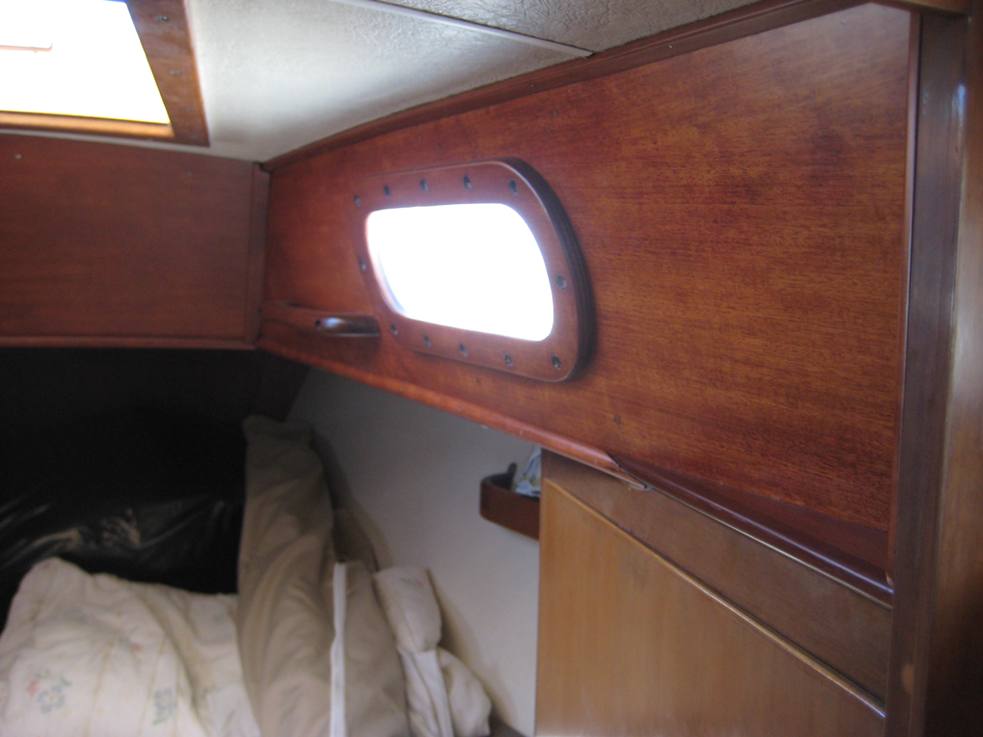

Well, I did just what I said last weekend. Removing them was a bear but nothing broke. Amazingly I found huge voids under the gaskets and sealant! Recall that LeComtes have the same sort of rolled inward ports that Hinckley B-40s do and the glass is retained by an interior trim ring. Apparently, LeComte really skimped on the workmanship here! I scraped the fiberglass surface around the port, cleaned the silicone out of the voids with a burr in the Dremel and filled the voids with epoxy. I cleaned the glass with razor blade scraper. I then used Auto Body rubbing compound and lacquer thinner on the glass. I made EPDM gaskets cut back from the port opening by 1/4" (easy cut with scissors; easy purchase from McMaster Carr). I used 3M4000-UV non-structural urethane sealant. All very easy!
Then, I tried installing one...while tired and hungry. Rain was forecast for Sunday and I wanted it done. Gooped the sealant on, slapped the glass in, added the trim ring and the screws, went on deck to clean up both the sealant and the tape goo and the sealant was already skinning. Done.
Went below, gooped the next one, slapped the glass in...and it didn't fit! Apparently, LeComte was willing to fit each port to its adjoining house liner panel but not provide a perfect faying surface, and not to orient the glass so that the 'Securit' and 'safety glass' labels all faced out. Picked up the next piece of glass, added sealant...didn't fit either, but it was close enough to trim the liner a smidge, slapped it in, added the trim ring and did the cleanup but with more time spent in installation, there was more time in cleanup.
The third port was much worse since it is over some casework and behind the fireplace stack. I left it a thumb-by mess and cleaned it up today with an X-acto knife. Done, I hope. Got to the restaurant before it closed, though.

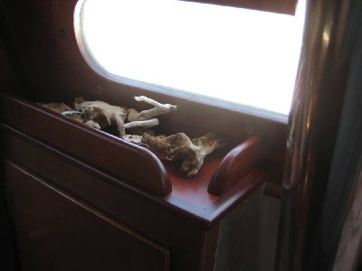

Very nice. I especially like the drift wood, our boat is full of things like that found along the way.
