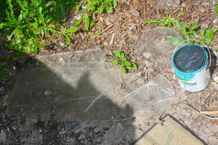

As an ex-plastics industry dude...
Whichever you choose, you can get a much better deal on pricing if you track down a plastics distributor and walk in or call and look for offcuts.
Have your dimensions ready, and know what thickness and product you want. 1/4 = .250 3/8 = .375 1/2 = .500
If you ask for the cheapest, you will get something without a UV package.
When they give you a quote, politely ask... "Is that your best price?" As a retail buyer everything is the highest rung on the ladder, most of the time all you have to do is ask and they'll put you to commercial pricing. This goes for most places that are not chain stores...
If you go acrylic, try to get your paws on cast acrylic sheet. Thicker than a 1/2 inch pretty much all of it is cast, but the thin stuff is extruded, which means the sheet has a grain. If you have a polarizing lens for your camera and hold the piece up to sunlight and look through both, you can see the flow lines, and thus lines of stress in the part. Casting acrylic means that the raw pellets lose their memory and crosslink evenly across the panel, extruded parts do to some extent, but the chains are not as long meaning the part is not as strong.
Pylasteki has a stack of half inch thick GE MR10 offcuts waiting to be turned into portlights. I like the idea of my portlights being thick enough that they are the storm shutters... and just carry a spare portlight or two. I'm pretty sure though, the cabin top will be missing before a half inch thick piece of polycarbonate gets stoved in.
A sheet of the stuff costs around 1,100 retail.
I bought six pieces 24 x whatever for just under 300 bucks total...
Of course it took 3 weeks, as some came from San Francisco. A piece from Chicago, and one from New Jersey somewhere.
MR10 is polycarbonate sheet that is used as structural glazing on skyscrapers. It has a 10 year UV package, and a scratch protective film... Pretty much the best you can get.
If money was no object, and I wasn't planning to go offshore I'd go as thick of tempered as I could afford... Not going to scratch it, and its never going to turn yellow.
If money is an object, and she's an inshore day sailer I'd go Acrylic.
When you go to cut this stuff, use the coarsest meanest jigsaw blade you can find for the rough cut. The more material moved with each pass the less heat is generated in the part. This stuff is sticky, and if you try to use a fine blade and get a smooth cut, it'll stick to the blade and try to glue its self back together if you are using a real junky jigsaw. Put mylar packing tape on the bottom to keep the saw from scratching off the protective film.
Make a template of what you want cut and use a router bit with a following bushing or guide bearing. 2 carbide cutters will do it...
Push it around the template with as much speed as you can safely control the router. Your goal is to have a high feed rate, meaning the plastic is sheared and the chips take the heat rather than the part.
You can come back and clean up the edge with some fine sand paper 320-600 to knock off whatever burrs are there.
When you go to drill the holes, use the template and a drill press if you have one. Pretty much any bit will do the job, just make sure it is sharp and new. The best bits for the money are hole saw bits... High speed steel, but the best quality of anything you'll find standing at a hardware store. If you have a fastenall near by, they carry some nicer stuff. Clamp a backer of polycarbonate to the underside of the part. If you don't when the drill bit exits the back there is a tendency for it to blow out a chunk. Keep the bit cool to the touch, if the chips start balling up stop and let it cool down, or dunk it in some water.
Do not, under any circumstance counter sink the fasteners into the face of the plastic. If you use countersunk screws, the expansion and contraction of the plastic from heat and sunlight... will cause it to crack around the holes as it ages. The holes for fasteners need to be oversized slightly, accounting for the plastic increasing in size, easiest way to do that is to use the plastic part as the drill guide for what you will be attaching it to... or step up a 25 thousands or so in size. Smooth shanked fasteners are best, as threads act as a notch point. (This does not apply to nylon, polyetheylene and stuff with a low durometer. Polycarbonate and stuff exposed to UV light lasts a lot longer if you account for it.
Also, if you put a sacrificial layer of 1/4 or 1/8th inch acrylic in front of the thicker stuff, it will serve as an expendable UV shield and keep what is behind it in much better shape. Keeping it sealed and dirt out from behind it is another matter... but if you are doing it on the cheap and want this install to be the last, it would not be a bad way to go. All the scratches and uv damage are taken by the top layer.
As far as sealants go... the warranty on high end materials against leakage is null if you stray from their proprietary primers and sealants. On polycarbonate some sealants need to have the outside of the sheet, and edges painted. Polycarbonate doesn't stop UV transmission without UV additives... Acrylic does. I wouldn't take the time to paint over the sealant on the face of a piece of acrylic. Glass, traps most UV, but not all... depending on the sealant, they want that painted too if it's to be flush mounted. My personal preference is for black butyl rubber for bedding in automotive windows... It is a sealant, not an adhesive, and so long as there is an even coat under the glass and a blob rolled up on each screw its not going anywhere. No sticky stuff to clean up... it does take a lot of tightening to pull down evenly though.

I threw my storm shutters off the boat today.
I'm not going to need them as I have removed the inserts for fastening them. And they're pretty scratched from years of sliding around under the settees. So from the cockpit, I gently I let the stack go flat to land on the ground below. 1/4" thick, I'm guessing arcylic.
Well, 8' drop to the soft ground, and they blow into smitherines! I just looked, aghast. Not even a big wave would break them. OK, only two broke, but they would have been worthless. Certainly not Lexan (sorry, poly carbonate?) which seems nearly unbreakable, must have been acrylic. Does this stuff lose it's strength?
Just for fun, I put the unbroken one on a log and snapped that as well. Good thing I never used them. My storm shutters needed glass to protect them.

Re: Storm closures
Tom: Well that's a bit unsettling. I'll be interested to hear about whether the acrylic (if that's what it was) "ages." Was there any suggestion that they had been well used; that is, perhaps exposed to years of UV?
avd155: I would guess that many people like the aesthetics of the original ports' shapes and so would rather keep them. Then, too, they make for great views and light when not in blue water - much better viewing from inside the saloon than if looking out the typically smaller replacement ports. And probably most folks spend a much greater percentage of their time inshore, where the standard ports work fine (or will work fine with re-bedding and perhaps a bit of upgrading but with the original shapes/frames). For occasional bluewater use, good storm shutters will then do the trick without the need to give up the former attributes.
