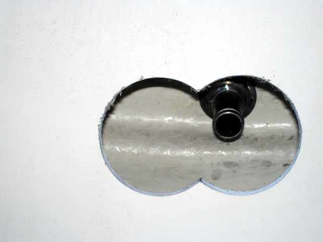

I wouldn't hesitate to install a deck plate for access (or a larger hatch). On my CS27 when I replaced the fuel tank I also replaced fill and vent hoses. The vent fitting was mounted high on the transom just off center to clear the outboard rudder. The cockpit well extends right to the transom and the gap aft of the well is only about 2". Because the vent was mounted high on the transom the vent was all but inaccessible. The original vent had to be installed before the deck was put on the hull. I installed a deck plate otherwise I couldn't have changed the corroded vent fitting. The main thing is to do it right. Sealed properly with any core removed and sealed with epoxy if present and it's not a problem. Access is always good as long as the cover keeps water out. Here's a pic of the vent before I enlarged the hole for the deck plate. I believe there should be access to all parts of a boat.
