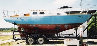

Here's a picture-
another ad -http://orlando.craigslist.org/boa/1831788205.html you might get an idea emailing them..
Between the large ports, seems to be close to center.
- Bristol27 _66.jpg (17.03 KiB) Viewed 1979 times

That looks right as well but its nice to have it confirmed. Can anybody give me a measurement from the center of the back port to the tip of the bow?

Josh,
I'm going to my boat tomorrow. I'll try and get a measurement of the B27 in the lot. If you blow up the picture and measure it; it comes to 17' 6".

On my B27 it is 16' 2" center of aft port to tip of the pointy end ;-). It's 9ft from cabin top to the bottom of the keel (she's out of the water for a paint job).
