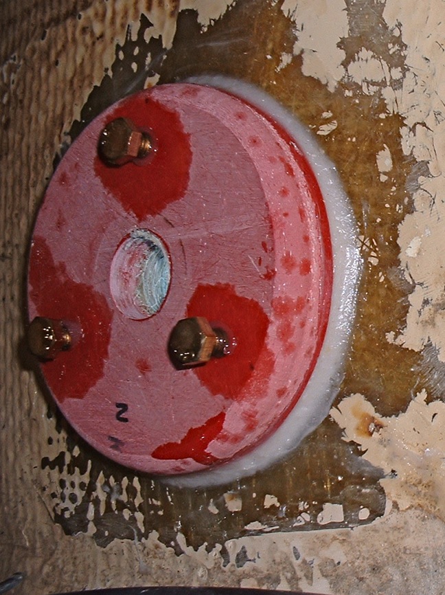

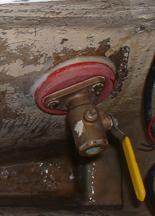

As for thickness, perhaps this photo will help you to gauge it. This is a 3/4" Apollo/Conbraco seacock, for perspective.
Another perspective:

5/16" is the bold diameter in most cases for Apollos and similar valves. Figure on 1/2" for the flange thickness when calculating your bolt length, but be sure to give yourself ample extra length so you don't come up short.
