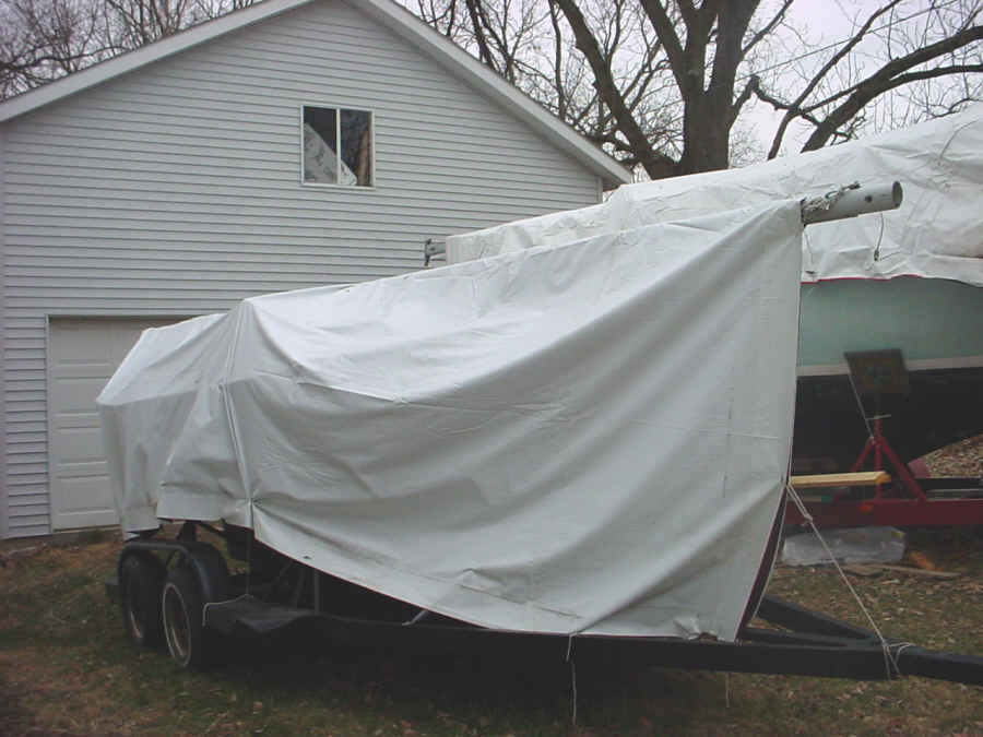

This year, I used recycled billboard tarps on 2 boats. The material is so heavy and stiff, that they seem to be mostly unaffected by the wind. The old, blue tarps would rattle and flutter any time the wind blew. The heavy billboard tarps hardly move at all. I expect many years of use and less wear on the boats. They are rather hard to put on alone, however, because of the weight.

I'm getting lazier these days. I use 4 A frames and a 2x6" ridge. One set of X braces between the middle 2 A frames. All the legs are tied or fastened to the boat. I'm lucky too in that the bronze stanchions slide out of mounting bases.
Then I run a 30x50' tarp over. Having built pretty substantial frames, this system relies more on gravity and fabric than structure. I get the least chafing and the least problems with wet snow. The boat has been driest as well. Best of all, this has cut down my lay up time. It's easier on the tarp as well, this being the second season, I think I may get another.
I could use a longer truck.
