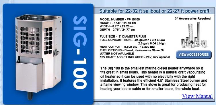

PS: I had a Sigmar heater, like this one (this is the smallest one; I had the next model up which is the same but slightly taller).
www.sigmarine.com

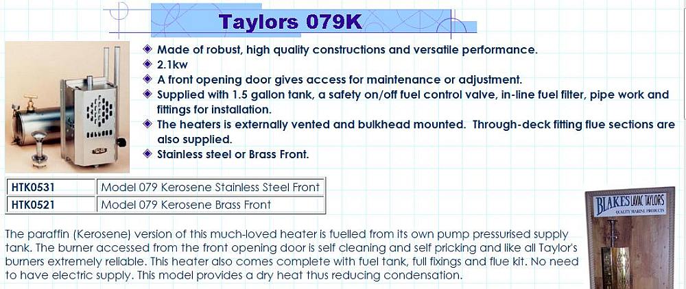

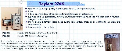

Here is a simple reliable bulkhead heater from your side of the pond.
http://www.blakes-lavac-taylors.co.uk/taylors_079k.htm This is kerosene (paraffin in the UK), but a diesel version is also available.
Re: Thoughts on Heating and Water System
Just a note of something to check on the Taylors stoves.
On the Sig stove, the combustion chamber is essentially sealed. Maybe not hermetically, but there is an airtight door with a clamp. I found this to be a nice feature.
On another boat I had a Taylors 079 Kerosene heater. I loved the way it looked, but I wonder about the open burner.
But, the reason I say "something to check" is that I never really used the Taylors to speak of, as we were in the tropics most of the time. I did spend a night on another boat that had a Taylors heater (same type), and there were enough fumes that I slept with two ports wide open (and it was cold out!). I got home two days later and my sleeping bag still smelled like burned kerosene. Since that was not my boat, it may just not have been adjusted properly or something (?). But also the bottom of the burner was just wide open to the cabin.
Again, I'm not saying this with much authority (I feel more confident in my assessment of the Sig, since I lived with one for a long time); but it might be something to check out. I do think most of the Taylors stuff I have seen is nice though, so maybe it was an isolated case.

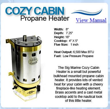

There are lots of choices for bulkhead heaters, propane, kerosene, and diesel.
The most popular around here are the Dickinson in either propane or diesel like shown below. There was a Force 10 kerosene heater similar to the Taylors but it is discontinued, although there is still an open flame propane version available. The problem is size. The Dickinson diesel is a bit big, the propane version smaller. Sigmar makes the smallest bulkhead diesel heater I've seen. It is shown below as well as the small open flame propane heater (was Force 10 but they sold it to Sigmar) I would have either before I would install forced air on a 25' boat.
http://www.sigmarine.com/index.html

Note that diesel-fueled bulkhead heaters require 48" minimum chimney length (for proper combustion and draft) that is challenging to properly effect in 25' boats, unless you have a tall external chimney/Charley Noble to bring the stack to the correct height. Usually this is not desirable, though.
I see the Sig 100 requires only 36" chimney, so perhaps you could make that work. In any event, determine whether--and how--you can run the appropriate stack for any such heater you may consider, before you make the jump. I recently went through the motions of researching diesel bulkhead heaters for a 25' boat, and there was simply no way to make the chimney work on that particular boat, at least not without significant modifications ot the interior to fit the heater lower. Even then, it wasn't really practicable.
