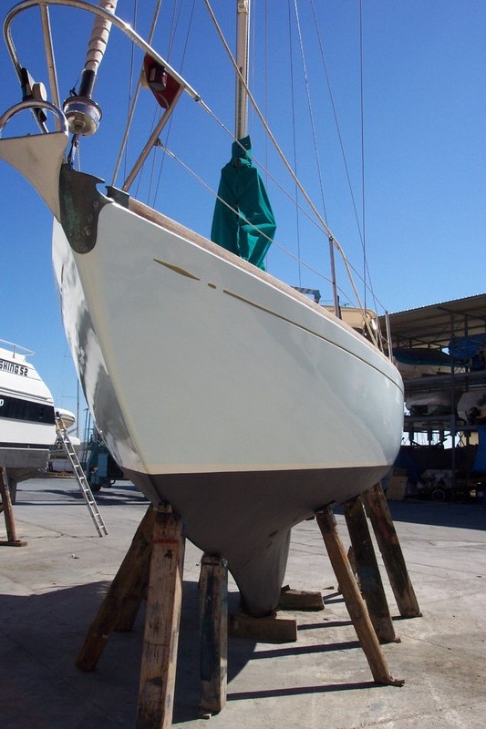

As for temporary support... some yards just block boats like this all the time, so here is an idea:
on hard port quarter.jpg (10.26 KiB) Viewed 9813 times
