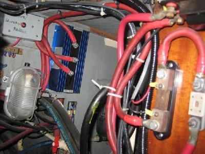

Overall view with the breaker panel folded down in the foreground:

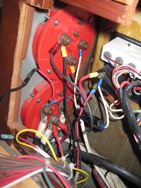

Looking down past the lower switch:

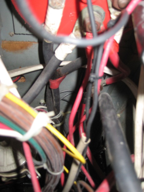

Looking up at the same place; there's another connection post and distribution:

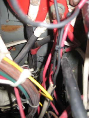

This is looking aft over the engine and under the countertop and the folded down breaker panel. Those busses are 12v+ and 12v ground and are original to the boat. When you drop a screw, presuming you can even get a screwdriver on it, it drops about 6' into the hollow keel.

There are many ways to wire battery a switch or switches. I don't think there is a need for 2 though. And there is nothing wrong with a 1/2/both/off switch. But the charging output from the alternator (or any other charge source) should not go through the switch. The best way to wire charging output is direct to the house bank with an ACR, Echo Charge or similar device to take care of the start battery. Then the single 1/2/both switch is for use only and both banks are charged automatically without your input being required.
I like to keep wires on main switches and batteries to a minimum. Using buses or powerposts can make for a neater solution.

I've spent a couple hours trying to understand what was going on. I failed, but this is what I found: The upper switch was powered on the 'common' pole by a heavy wire tagged to the hot side of the ignition switch. The '2' pole was powered by an inline fuse/breaker/??. The '1' pole had the ground side of the hourmeter and an unknown wire leading into never-never-land. I changed something around that battery switch last year and one result was that I had to find a new ground for the hourmeter. There is an interlock to require the engine to be running or to have shore power before the 12v refrigerator will run; perhaps that unknown wire is associated with the interlock.
I can never remember which bank (1 or 2) is the house bank; gonna' trace it and write it down - what an idea!
Bottom line is that I've stripped the upper switch out and will put the anchor breaker there.
I had to find a breaker for the new washdown pump. I had a spare on the panel but it was tied to the 110v buss that supplies all 110v breakers. I cut the buss and powered the spare off of the 12v side. Now all I have to do to finish the washdown pump power is to tag its ground to a ground buss bar in never-never-land - the very one where dropping the screw will mean it's forever gone (along with the roll of electrical tape I dropped this morning.

Should'a proofed before submitting. That '2' pole was powered from the same connection on the ignition switch that the 'common' pole was. Means that if the selector was set to 2 nothing whatever happened.

I read this several times, and I sure don't get it Doug. Especially the separate switch. I'm assuming you have 2 batteries one or both of which supply your engine starter.
Just thinking from scratch, I'd want the battery switch to be just that, ON/OFF for 1,2 or both. I'd want any charging from alternator(s) to connect at the alternator/starter/engine panel/+side of distribution buss bar, with correct fusing of all wires, none of those at the battery switch.
One reason being the danger of the high amps capable at the battery cables/switch. You can protect those (if you want) with correct breakers/fuses. But those wires coming off are not protected, and only after an inline fuse. Better to get power quickly to the distribution panels and protect each wire gauge downstream from there.
The power to energize the alternator, should come off the engine panel when you turn the key ON.
I just can't see any good reason anything should come off the battery switch except the battery cables themselves. Everything looks clean and well done in the photos around the panel. I think I'd just clean it up and simplify things.
I'd remove that extra battery switch, or use it as an ON OFF switch for a separate starting battery, which could also energize your windlass.
