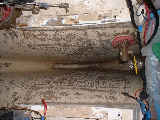

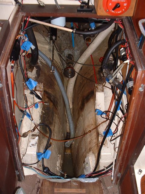

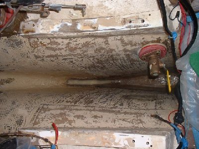

The ones I'm talking about are hollow fiberglass shapes. They are relatively smooth fiberglass on the inboard sides, top, and forward ends; and then "hollow" on the outboard sides and after ends. They are fine for an Atomic Four because it is a really smooth engine, but I have read (and having owned them, I don't disbelieve it) that they are not suitable for the more aggressive movement of a diesel engine. (In the later boats made with a liner the engine bed design was changed, and is said to be more substantial).
Here are some photos of the bed style I'm referring to. None of them were taken to specifically show them in detail, but I think between the three you can get a reasonable picture of them:
I don't have any Beta information for you (although I, too, have read about those problems and understand why you are asking), but I see you have an Alberg 30, so I just want to mention something in case that's the boat you are potentially re-powering.
Since you are up in the 300's on hull number, I'm not sure what your original engine beds would look like, or even if you still have them, but if they are the same as the ones in the 200's, then they may not be suitable for a diesel unless they are changed or beefed up (in which case.... you might want to consider just moving them to fit a diesel with "normal" mounting feet).

When I inspected the boat I did not pay much attention to the beds or their construction. The boat is pretty much all original, including the Atomic 4, so whatever is there was factory installed (I assume). If the beds are the type that you describe then it is clear as to what I need to do.
In talking with Joe at SMD, he assures me that if the beds measure properly from centerline to centerline (11-7/8") and the width of each bed is typically what would be found in an A4 installation, then the Beta16 A4 replacement will fit.
In looking at the mechanical drawings for the A4 replacement, I see that the oil sump pickup hose comes down almost inline with the mounts. To me it seems that the hose would be resting and chafing on the bed as it makes its way to the back of the pan. Then there is the question of whether or not the narrower beds can stand years of additional torque applied to them.
As you can probably see I am talking myself into installing the wider beds! Tim sells the wider bed idea pretty good but only because he encountered problems and the real world motor did not jive with the drawings. I am now wondering if it is just a good idea (14-5/8" beds) from the standpoint of eliminating excessive torque, vibration and providing room to maintain. It is a moot question of course until I see what I really have down there :)
Rachel, thanks for your help!

Good call Rachel! The beds in my boat are the hollow type as you suggested they might be. I didnt get a chance to measure between them but they seem wider than what I was expecting. I will know more tomorrow. Today is baseball, Nationals vs my Marlins in DC!

16-5/8" center to center. The yard gave me a quote of $16k to $17k for a new Yanmar fully installed. Ouch!
