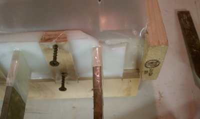

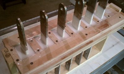

I'm casting chainplate risers (some call them islands) to keep the interface where the chainplate enters the deck out of any standing water that may be on the deck from rain or incoming seas, but I ran into a bit of a problem regarding epoxy brittleness. I cast them last night before bed and they seemed to have hardened up nicely overnight, but when I attempted to open up the mold one of the risers cracked.
I believe it's one of the following problems (but there may be more and it may be a combination of them).
1. I didn't let it set long enough, I've done this before (I get too anxious and want to see results). The epoxy seems to harden better when you let it fully cure over several days (not sure how of if this effects ultimate brittleness, but it seems to).
2. Heat issues, although it was 60 degrees in my basement shop and I only filled the casting with ~3/16" of epoxy. I haven't previously had heat issues with that little mass, but who knows.
3. Thickening agent. I used aerosill (fumed silica) to thicken up the raw epoxy but maybe I should have been using something more appropriate for structural mixes like milled fibers or something along those ideas.
Anyway, I'd appreciate any thoughts you all might have that might help make my second cast a bit more successful.

That's what I would tend to think as well, but I had this happen to me a few months back when I was trying to remove a chainplate from a newly cored deck the day after I glued it up and the epoxy surrounding the chainplate cracked like peanut brittle, and this section had 7 layers of biax glass surrounding the chainplate (although it didn't directly abut the chainplate). I held off pulling the rest of them for another day or so and had no problems.Carl-A259 wrote: I know on deck repairs the first 24 hrs, kind of springy, the next 24 rock solid.
Whatever the case, I am going to hold off pulling the rest of them out of the mold for another day. I will have to do this over anyway. The vast majority of time spent on this particular project was spent building the mold, doing another pour is inconsequential from a time perspective.
I'm mostly curious if there is some sort of phased cure where the epoxy will have some sort of 'brittle' phase before the molecular cross linking has completed.

I hadn't thought of that and sure enough, I pulled the leftover pot out of the trash and it looked like it boiled. It melted through the plastic on the bottom. So I think I might have been a bit hardener rich. Normally I'm pretty careful about measuring, but I did this in my basement shop where I didn't have my normal measurement containers that are stored in the boatshed. I eyeballed the mix - DOH! I'm hoping that's the root cause.LazyGuy wrote:My guess would be that you may have added too much hardener. That will cause it to heat up and the head would result in the brittleness. That is just a guess. If the right amount of hardener was used, it may be that it was not fully cured. If you had some left over, take a look at it, see if it shows any sign of heating.
So last night I cleaned off the mold and did a few things differently. First, I coated all the chainplates with wax because they didn't want to let go of the epoxy when I pulled them yesterday even though I had wrapped them in clear packing tape (I've had success with this before). The second thing I changed was to add some 'milled' glass fibers (I shredded up some 1708 into 1/8" pieces) to add some additional strength. Finally, I actually measured the epoxy ratios this time. Shame on me for eyeballing in the first place, I should know better, but I'm thankful that I didn't do this while doing my recore. Cleaning a bit of epoxy out of a mold is a far cry easier than grinding off part of my deck.
Everything seemed to set up nicely when I checked this morning; no overheating visible, and I am not going to touch the mold until tomorrow to make sure everything is cured. I hope I'll be able to report back with success, otherwise I'll be relegating the mold for kindling and going with some G10 or laminating up a flat sheet to cut up into smaller plates.

I'm happy to report that my second attempt was more successful. I'll chalk it up to a number of things that I changed:
1. Milled fibers
2. Waxing the mold and not relying on just packing tape
3. Waiting longer to pull from the mold
4. Here's the biggie: ALWAYS MEASURE YOUR EPOXY RATIOS. I've been really lucky up until now because I have not mixed a single bad batch over the course of my recore and I'll attribute it to being very careful, so it serves me right when I get arrogant and just eyeball the stuff. Lesson learned.
I'll wait till they fully cure over the next day or so and then sand the ragged edges off and make them all uniform, but I think they will work nicely once they're cleaned up.
