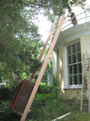

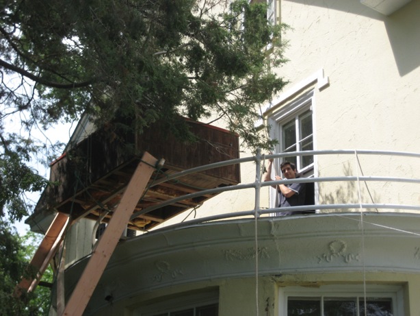

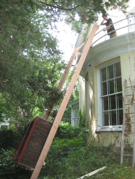

For the others: my Army training taught that a 'natural holdfast' was best for anchoring cables for moving Bailey Bridges, etc., but buried deadmen were pretty good, too. A natural holdfast is a large tree; buried deadmen are buried baulks of timber crosswise to the pull. David's truck might well have worked, w/o rollers, with a large block and tackle affixed to something good and the pull applied by the truck. I have a couple(!) huge old wooden-cheeked blocks and tackles with capacity of about 3/4" line which I've used with both hemp rope and with my old anchor rode to move large objects.
Here's a 140lb college kid lowering a several hundred pound hot tub, and not working very hard at that! (It was much harder to roll it around to the front yard!
